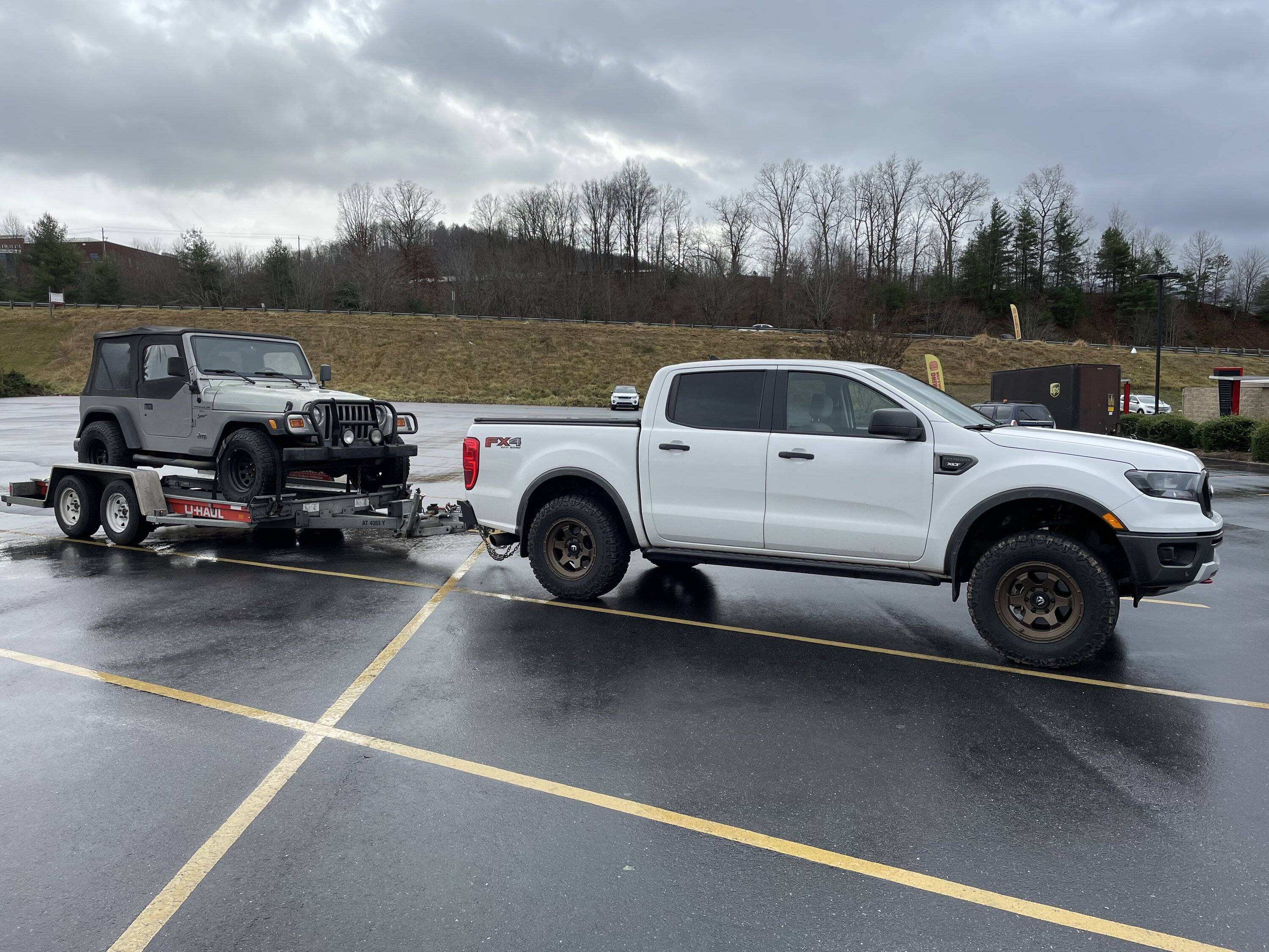

Not sure it it's a direct comparison, but here is my truck with Tremor leafs/Bilstein shocks in the rear and Bilsteins at 1.8 inch level in the front.
Trailer + Jeep is between 5500-6000 lbs. This is a U-Haul car carrier so you can't really adjust the tongue weight, and the Jeep is up against the front stops so tongue weight is likely a bit more than ideal would be.
It has the inline 6 so most of the Jeep weight is in front of the trailer tires.
Fairly level with maybe a slight squat? Angle of the picture makes it hard to tell. I should've measured it.
It towed effortlessly up and down the mountains. No sway, no shudder, no drama.

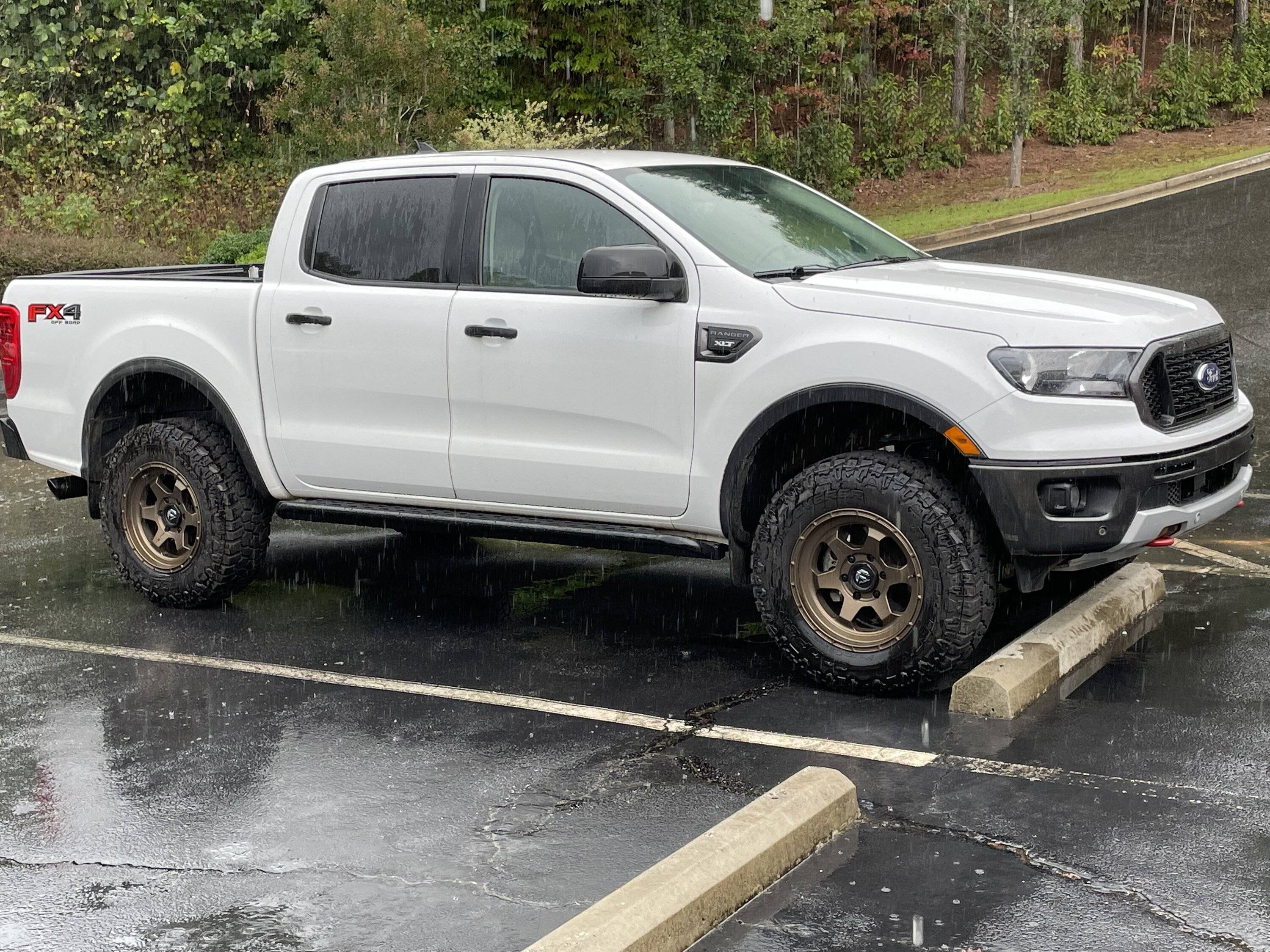

And stance without a trailer.
I kept it at 60mph or below but 60mph up the mountain was a breeze. It could've easily gone faster.
r
Based on that if you are level to start then maybe the 2 inch would work. Since I am 2.75 inch higher in the rear that would give me still .75 after lifting and based on your weights and set up there if I did have that squat wouldn't be much at all. Nice truck by the way. Like those wheels on the white truck
