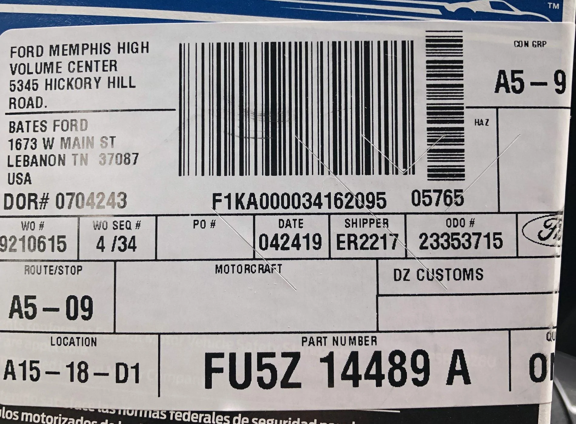

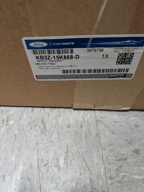

Harness and 7/4 pin receptacle: (yes both are available)
Thanks so much for posting the part numbers. My local dealer wasn't sure until i gave the numbers to him, but now i have the parts coming. Thanks again.
OK, i received the parts yesterday. My dealer thanked me for the numbers and he was able to help another customer looking for the same thing. Once again, Thank you.

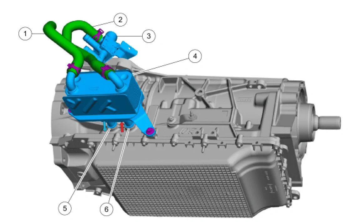

Do you know if the trailer tow package has a transmission cooler for the transmission?

There is a transmission oil cooler but not sure it is specific to the trailer tow package.

There is an oil/water heat exchanger (transmission cooler) off the drivers side of the transmission. Should be on every truck as far as I can tell.
