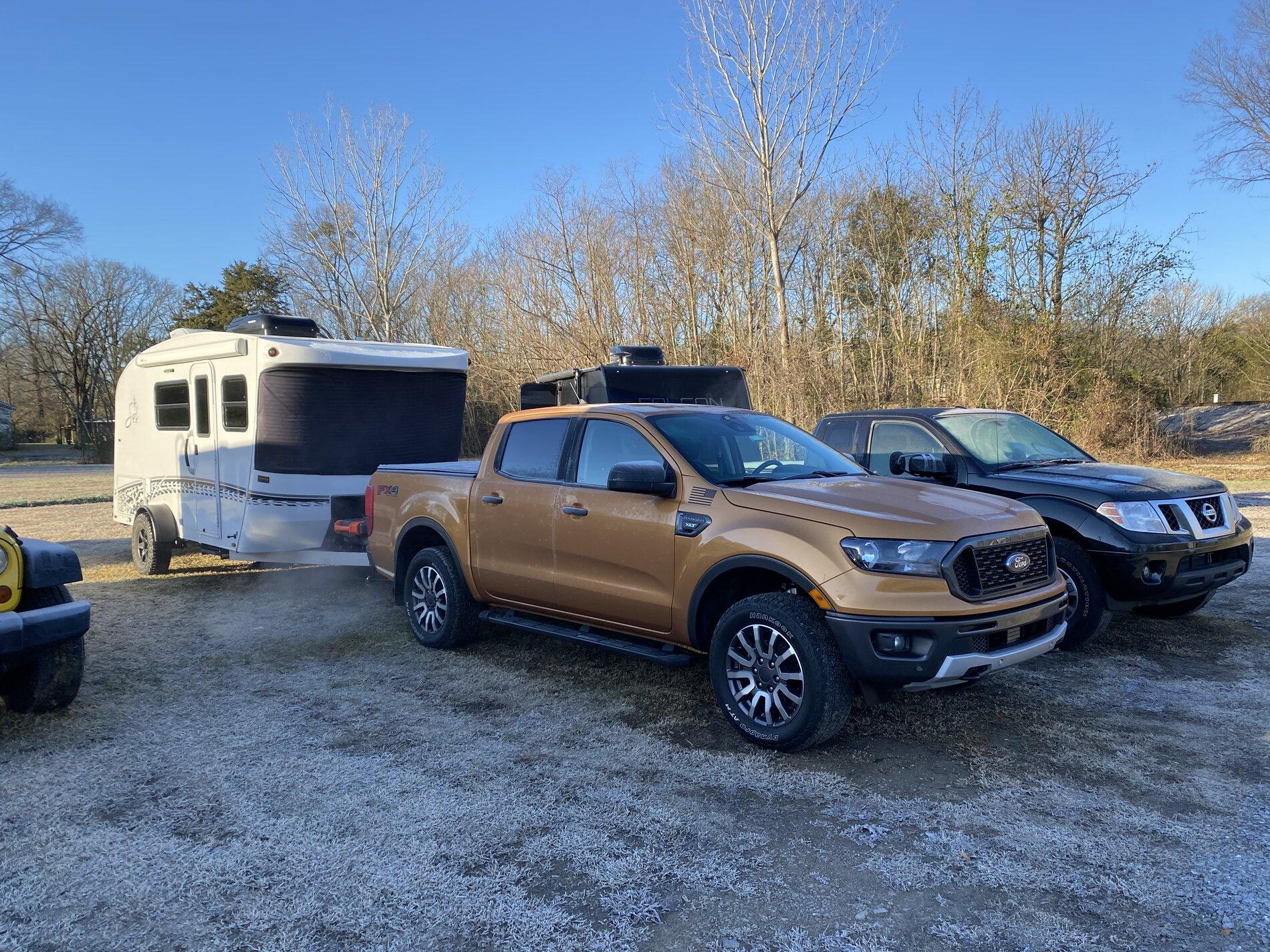

I tow at about 5300 lbs. Stock engine has all the power it needs, even in the mountains. Initially had some sway, or at least a "squirmy feeling in heavy cross winds. Installed Hellwig rear sway bar, blew stock tires up to 50 lbs and fine tuned the E2 WDH. That did the trick. I can still feel the cross winds if they are strong, but the "squirmy" feel is gone.
I too wish it had a reasonable size gas tank when towing. 180 miles (150 to be safe) is not much range when traveling in Eastern Oregon.
That looks like the same setup as what I pull with my 2020 Ranger. Grand Designs Imagine 17 MKE. Just got it a couple months ago and only had one trip before it got too cold. It had a lot more sway than I would like and I was looking at installing the Hellwig Sway Bar - it sounds like it improved your "pulling" experience??? Thanks
Yes, it made a big difference. If you get one I suggest you watch a you-tube video on installation. The instructions that come with it are rather worthless.
