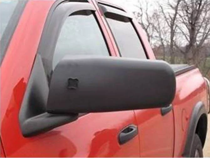

I just got back from a towing trip and on the way up it was a very windy day and if I got passed by a semi going the opposite direction on a 2 lane highway the wind blast would fold in the mirror on the drivers side, this did not happen every time but more often than not. It like the extra length of the towing mirror caught the wind and it couldnt hold it out.
This is a Lariat with the auto folding mirrors so Im a little concerned that this is hard on whatever motor or the like is in there to power fold these things.
Im going to let the dealer know in case something happens to them and see if they have any ideas. I would think the non-power folding would be stiffer as all my other trucks seemed to be.
I was using a simple universal towing mirror somewhat similar to this.

Go to a big RV place and check out CIPA custom mirrors They fit over your stock mirror like a glove and are very stable.

Todd is referring to the inability of the power mirror mechanism to buck high winds. I don't think it has anything to do with the fitment of the non-oem tow mirror to the factory mirror housing.

You may well be right,:wink:and I regret any consternation which I may have caused you.... but I have a shelf full of those rubberband mirrors in my shop and they seem to exert a great deal more sail pressure on the truck mirrors than the Cipas.
I have used Cipa Mirrors for years and found them very stable and they have never caused a vehicle on which I have used them to fold. I think it has to do with the leverage applied by the Rubberband mirrors in contrast to the fact that the wind force is spread across the entire face of the Cipa mirror including the covered portion of the OEM Mirror. Also the Cipa custom mirror may well be more aerodynamic.
The rubberband mirrors have been a constant aggravation in comparison ... Vibrating and folding the Tow vehicle mirrors, even shifting when installed properly.
None of these problems has occurred with the Cipa custom mirrors in my experience
Of course I understand that your experience may well be different.

I have these from my Frontier as they did not have a custom fit for it, so I used what I have. I would rather have the custom ones, and it will be interesting to see if it makes any difference. I hope it does, but are there any to fit the Ranger?, are our mirrors the same as any other fords?
The mirror still seemed pretty weak , not only did it fold , but just driving pushed it in a half inch or so, so I adjusted the mirror for that as well. I have never had auto fold mirrors, so this is all new to me too, but you would think it should be able to handle it.

Im hoping it can be worked out easily, maybe a different set of mirrors could be it, we,ll see, could just be the nature of power mirrors. I found a pic of the actual ones I have, a bit more streamlined than the ones above but maybe not ideal. I,ll keep you all up to date if anything new happens.

SO after reading some other threads I just wanted to clarify, the mirror only deflects with a tow mirror on, it is fine without them. Also, it was a particularly windy day, but I still think it should have held. Im not overly stressed about, it we,ll see what the dealer says.

Hi, I work at the company that makes the mirrors for the ranger. I had little to do with the development of the mirror, but I have reviewed the design/specs. As much as i'd like to say "Dont put trailer-tow mirrors onto these mirrors" I know it's a necessity for many people due to the lack of proper trailer tow mirrors (Especially since Ford pretty much insists that the Blind Zone sensors are all you need). I highly suggest avoiding use of add-on mirrors whenever possible, and also suggest that you avoid folding the mirrors (powered or manually) while the extensions are on the mirrors.
The Ranger mirrors are a bit heavy for the powerfold actuator, and they're not as rugged as the F-150 base mirrors are. Lifespan is still to Ford's usual specs, but they dont have the "extra capacity" that something like the F-150's might have.
