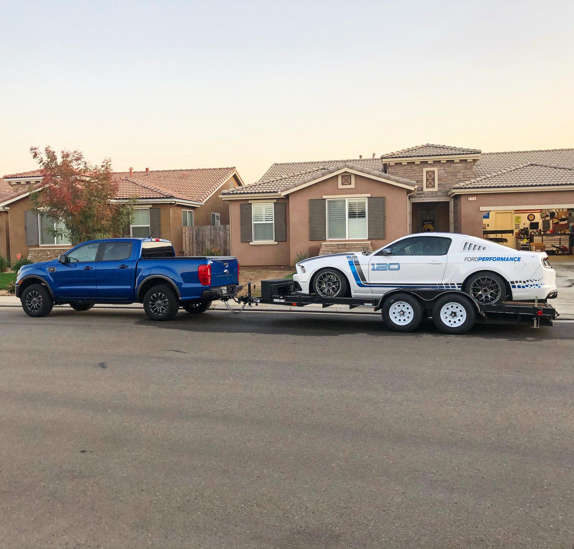

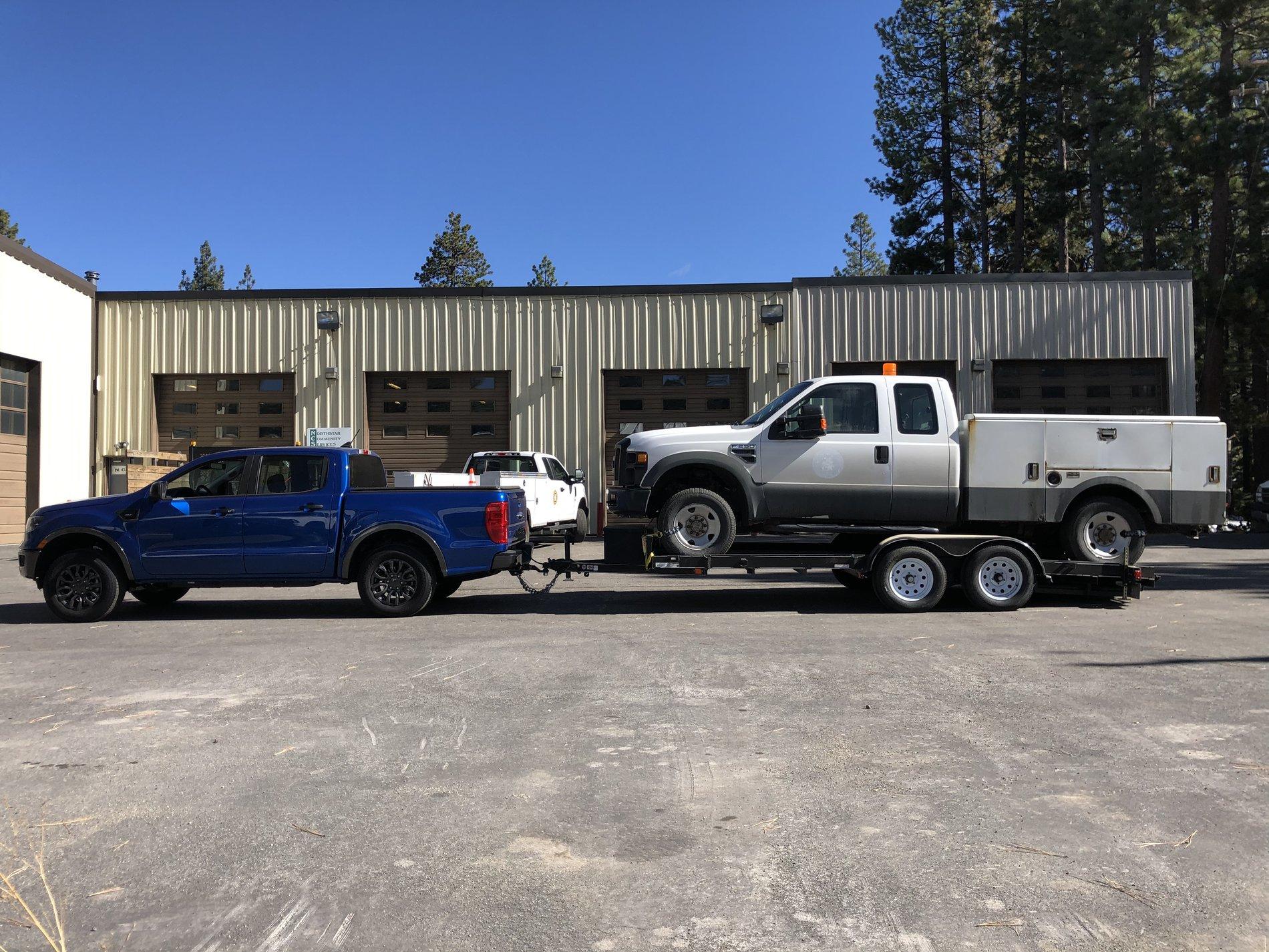

The paperwork speaks specifically to frontal area of trailer and how it impacts drag. Says if frontal area is greater than 55sq ft with a heavy load a vehicle with a larger engine should be considered. I’m paraphrasing. I tow a 8.5x20’ enclosed trailer so that verbiage stood out to me.

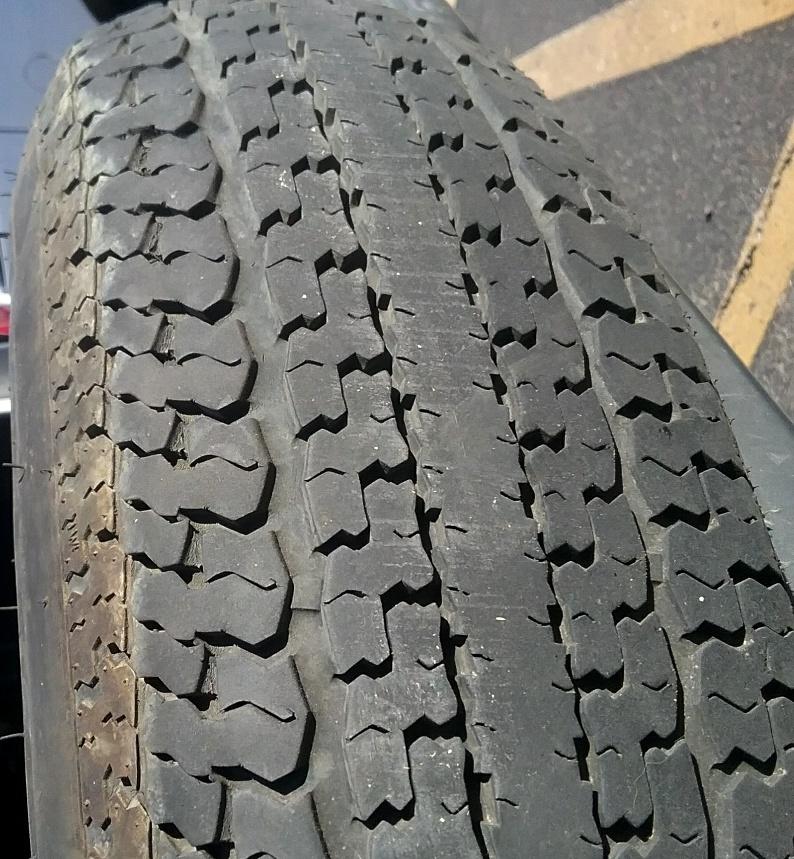

About the Goodyear Marathon tires, they were very good when made in the USA, but when China started making them, they sucked & were junk. The first tires I put on our teardrop were the Chinese Marathons. I didn't know about their problems, but you can look it up online. The trailer weight was only
about 1700# After 2 seasons of towing, I had one starting to come apart after 15,000 miles of mostly highway driving. Look closely at the left side & you will see the beginning of tread separation, prior to a catastrophic failure if I had missed it. At the top of the frame, there a large bulge in the center of the tire as well. If you have these tires, get rid of them!
