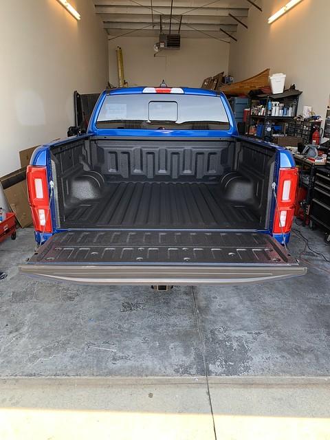

I sprayed in my U-Pol Raptorliner. Holes stayed clear without doing anything special thankfully.
Ranger by William Snitselaar, on Flickr
Thanks guys.

What part of the picture are you talking about, with drain holes? The very lower part of the bed floor where it meets the back of the verticle part of the bed? Or the two plastic plugs?
I did the liner myself as well and haven't noticed drain holes so I want to go check. I didn't look inside the crevice there.

I Scuffed with different scotch brite pads till it was very scuffed looking, then used adhesion promoter on all the edges just in case.
The drains im talking about are at the front where the box goes vertical, there is a little valley at the joint and if you look on each side there is like a 6-8" slit for water to fall out of.
