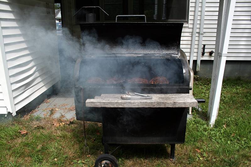

I built this in 1989 for my wife and we use it every summer.
Note the melted vinyl siding! Oops ...
That sir, is the textbook definition of a job well done!

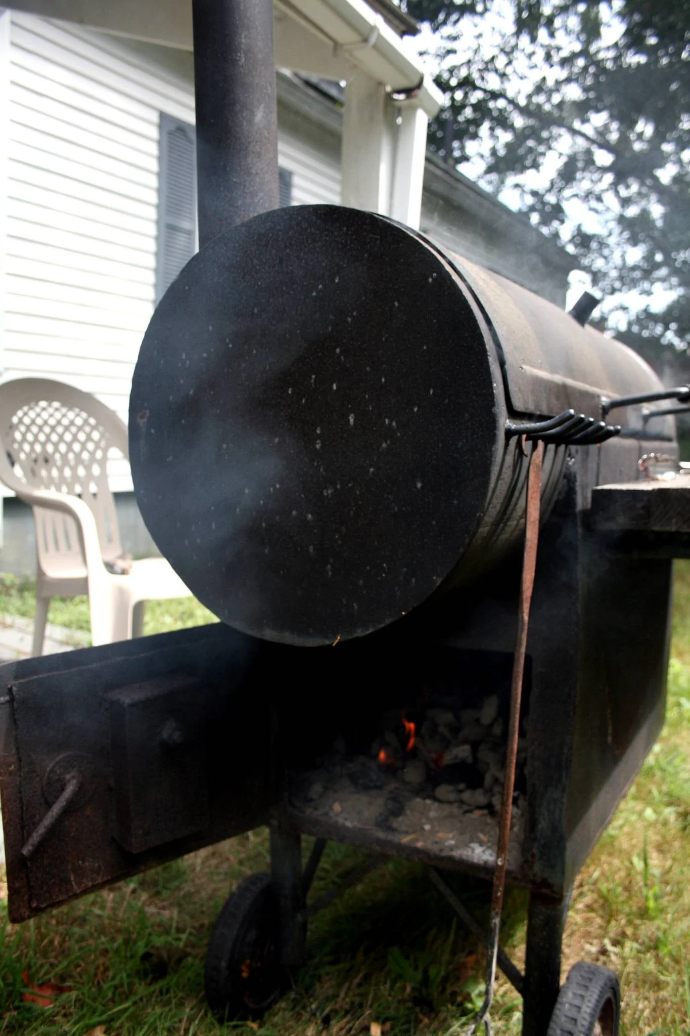

Thanks, I started with an old in-ground propane tank. Filled it with water for a week, drained it, then straddled it with a torch! Made many cuts for the doors, first for the hinges so I could weld them in place before cutting it out completely, then the sides and formed the flat stock in place for the seals.
I lucked out and had stainless steel bread-baking conveyor belt racks that were perfect for it. And then just lucked out with the firebox and venting to get it to a nice cooking temp of 300 - 350°.
50 pounds of welding rods and it still works. I do need to make a new rack, even with stainless, all the salt from smoking has worn it thin.
And the thing weighs about 450 pounds, what a pain to move on old Toro lawnmower wheels! From Texas to Miami to Boston to Portsmouth!
