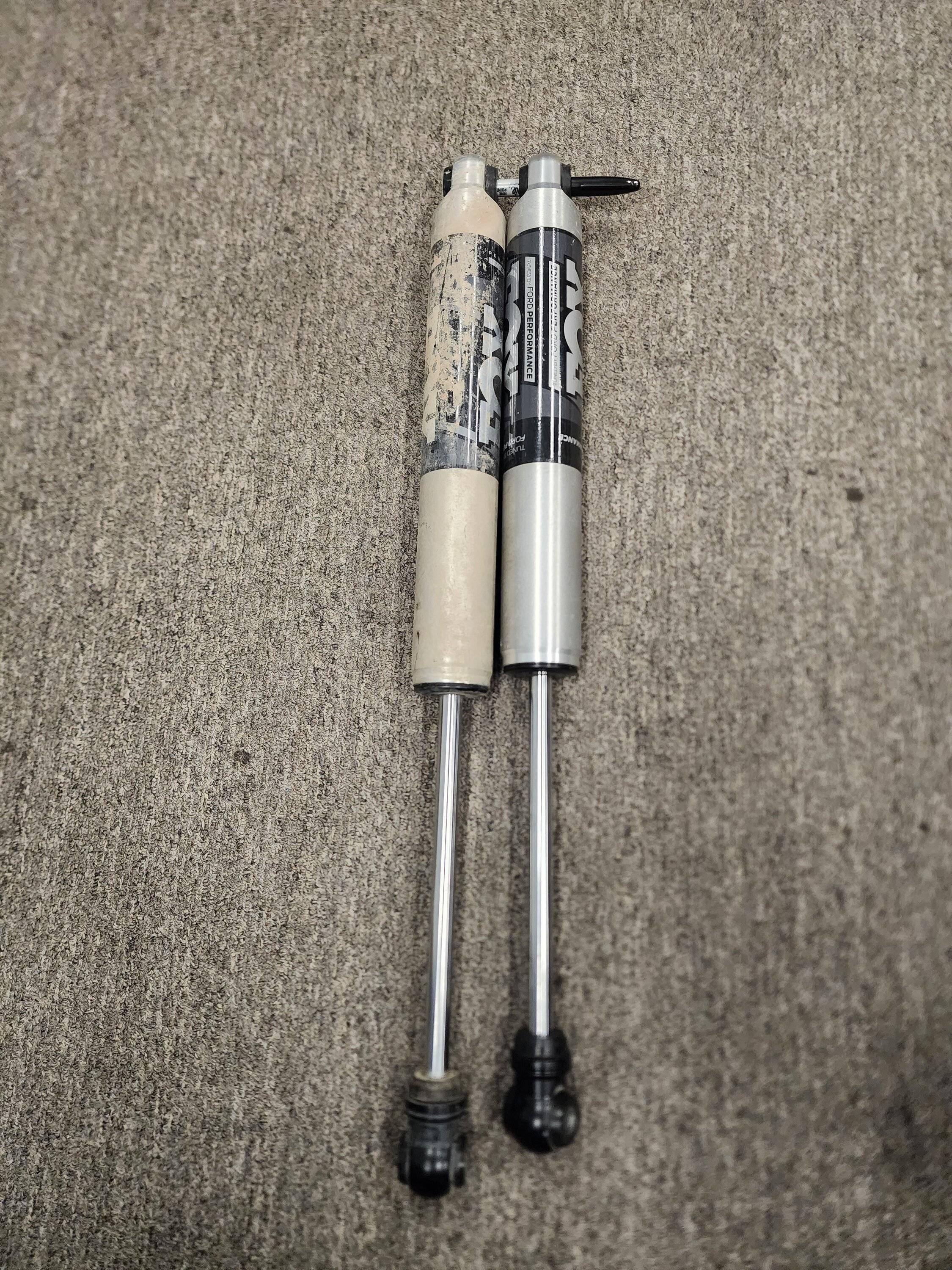

We're actually doing the facts and letting you see the difference between these two Ranger 2.0 Shocks. Are they same?
Not even close!
Left: Ford Performance 2.0
Right: Fox Performance Series 2.0
Rear
Left: Fox Performance Series 2.0
Right: Ford Performance 2.0

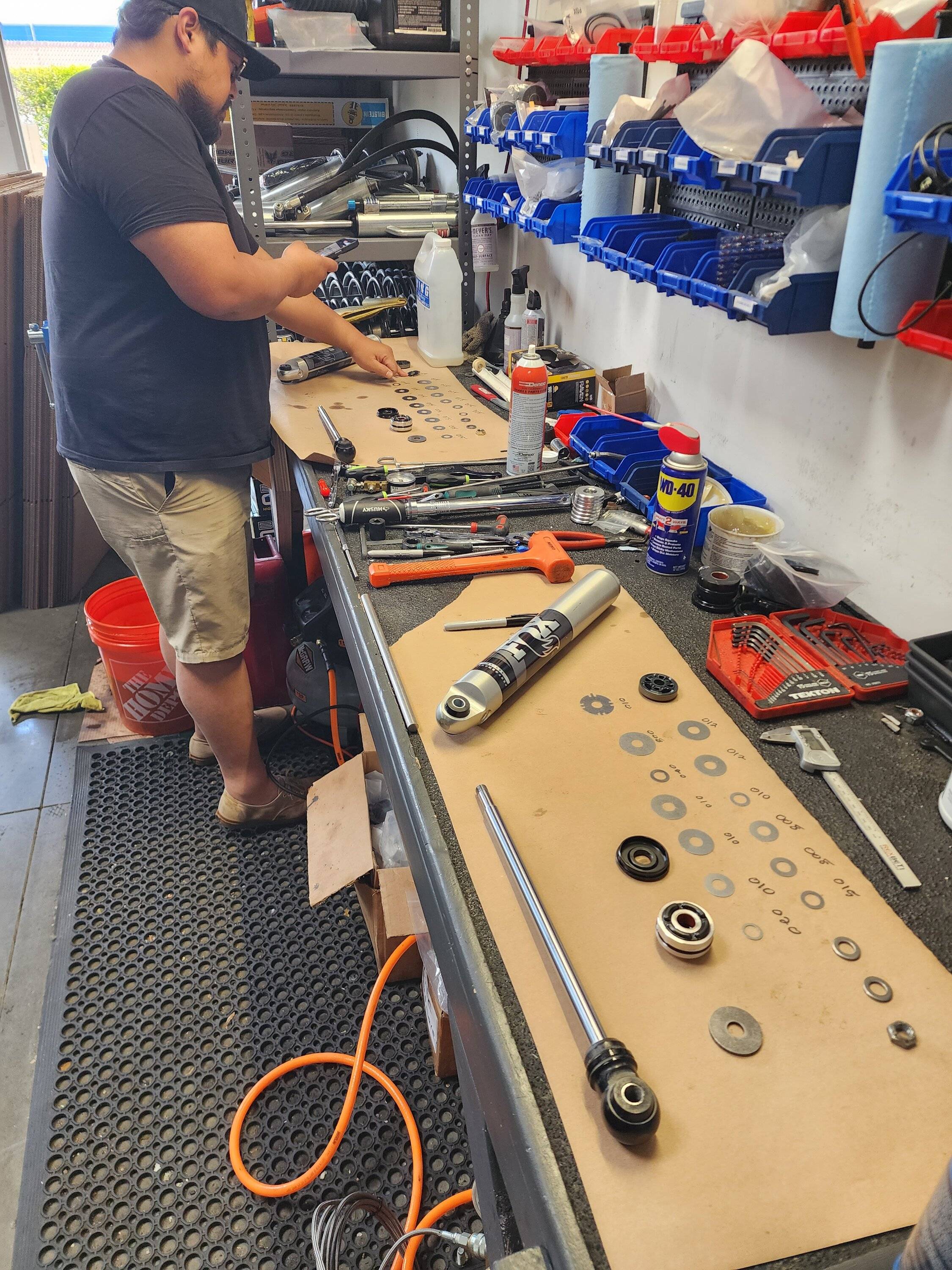

Here's also a sneak peak of the rears broken down... Let me know what you guys want to know and we can include it in a video. We'll be breaking down the fronts next.

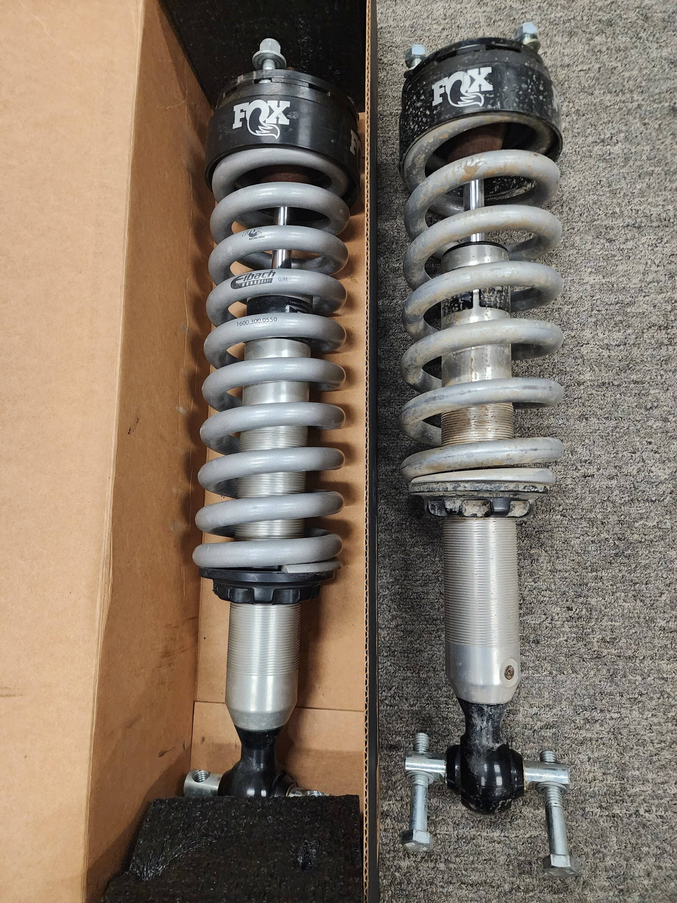

This is very interesting. So the Ford branded shocks have Eibach springs with about 10 coil turns, and the Fox is about 6-7 turns and threaded much higher up on the shock. I can see "FOX" written on both springs, but is the Fox 2.0 spring Eibach and the same gauge steel as the Ford 2.0?

You got it backwards at the end. That said it looks as if the spring may have a similar diameter, but due to the spacing there is a possibility of different spring rates and slightly different metal. Just depends on what brand Fox chose for the spring.

They are both Eibach springs, and both use a 550 spring. Ford uses a 16" spring, vs Fox uses a 14" spring.

I work for Shock Surplus. I was trying to just make this educational, not trying to sell anyone anything. We do Shock rebuilds as well, so feel free to ask any questions about that process. You can always PM directly if you want as well.
A customer brought these Ford Performance shocks in for a rebuild, and we had a set of the direct Fox version that were used previously for testing on my own truck. We decided it was a great opportunity to learn the differences between the way Fox sets up these shocks vs. how Ford has them tuned.
