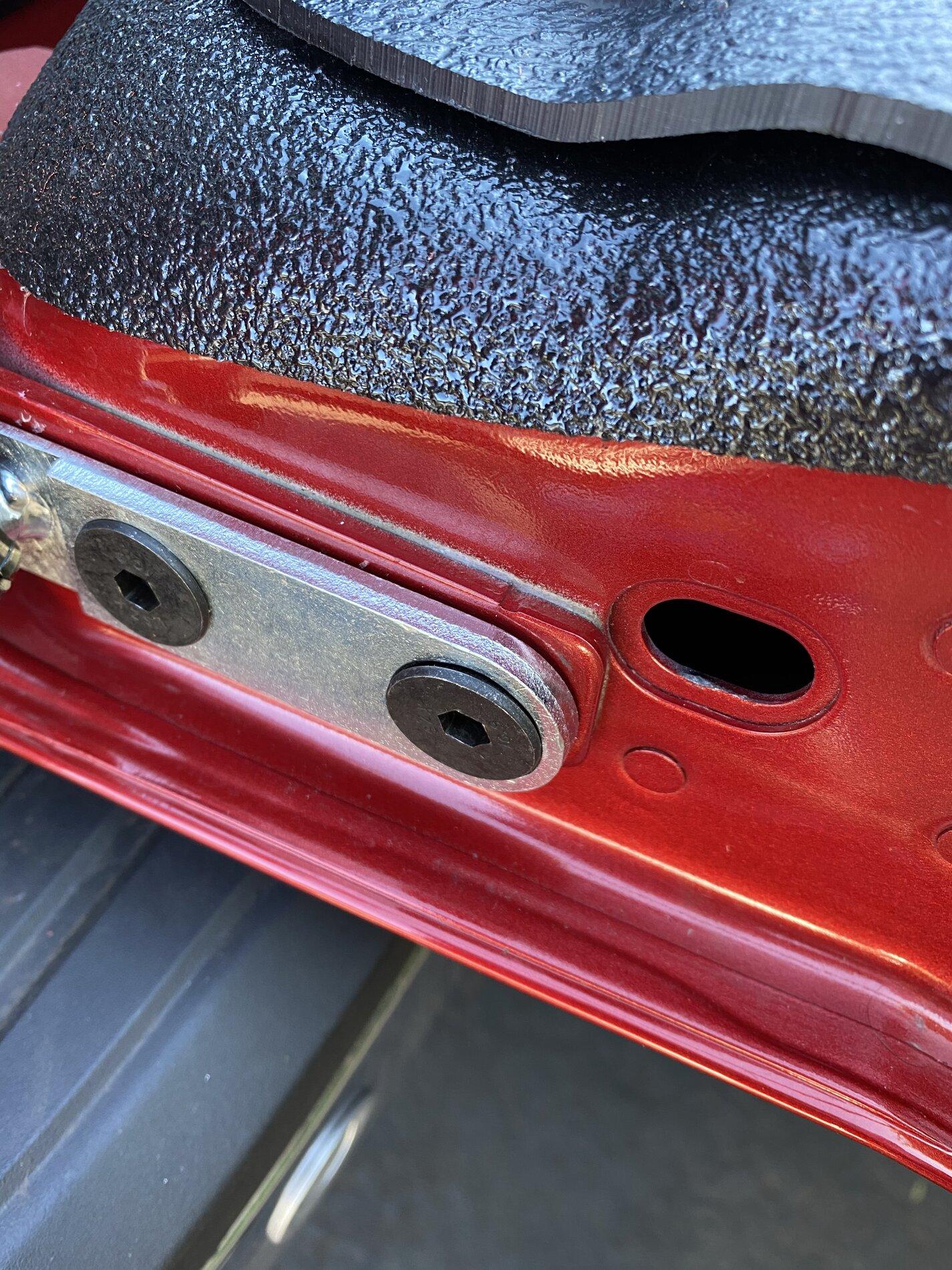

snapped a pic, can’t really see the other side but there is a tac welded nut behind the metal of the tailgate that the black screw threads into. One was slightly off center (one on the right) causing it to cross thread, which is funny because the stock screw was installed in that same hole but it’s not deformed.
I am beginning to think the Rivnut will be the best option as well.
I will try to take the access panel off but I just had the bed spray lined, so it may be a little trickier.

Good luck! They should have taken the acccess panel off when they sprayed it, so you should be able to get it off easily. Now if they didn't take it off before spraying...
The dealer or a mechanic should be able to install the rivnut. One that big really needs the correct tool.
I still would try the dealer and tell them it was messed up before you installed the new screw. its worth a try
Again good luck
EDIT: I AM NOT SAYING TO TRY AND SCREW THE DEALER HERE! Describe what happened as you did here and see what they say.

A pem nut might be a better solution than a rivnut if you can reach your hand inside the tailgate access panel and get it started. Once tightened itll be pressed into the metal and stay there if you ever take the bolt back out, no special tools needed. Rivnuts need a special gun to be installed.

I thought the tailgate is of aluminum making tack welding a nut to the inside impossible unless the nut is also aluminum. I would guess a steel plate with the nuts tack welded to it. You should be able to access the area after removing the access plate from the tailgate. So you might be able to reach the area with vice grips to get the bolt off the nut, remove the plate (if that's what's there) and weld a new nut to the plate.

Good news, sort of, there are simply round nuts that press up against the aluminum. They had blue lock tight to keep them from slipping, when tightened or loosened. I guess mine was glued off center.
I opened the access panel in the tailgate but the middle cross member will prevent any access to the lower portion of the tailgate. I just have to figure out how to hold that round nut to tighten. Without being able to get a good grip on it

That sounds like the PEM fasteners mentioned above. They have a smaller serrated step that gets pressed into the hole from the back side. They may have used loctite to help secure the fastener but it might be something to prevent galvanic corrosion as well since you have aluminum and steel together.
Those may have been installed before they got the tailgate put together so you may not have access. At this point, a Rivnut may be the best solution since installation only requires external access. You may want to use something to prevent galvanic corrosion.
