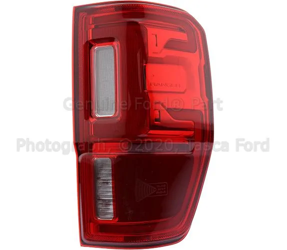

Correct. XLT and Lariat models use this full LED tail light:

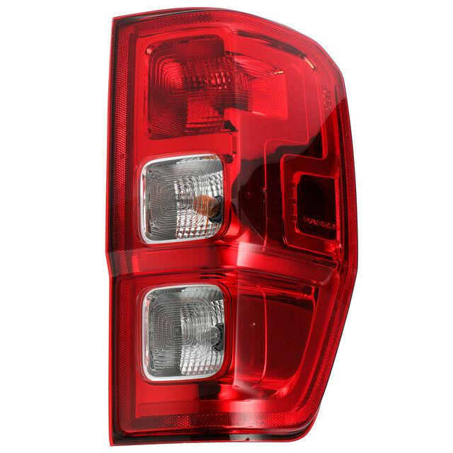

Whereas XL trim trucks use this with three separate incandescent bulbs:
