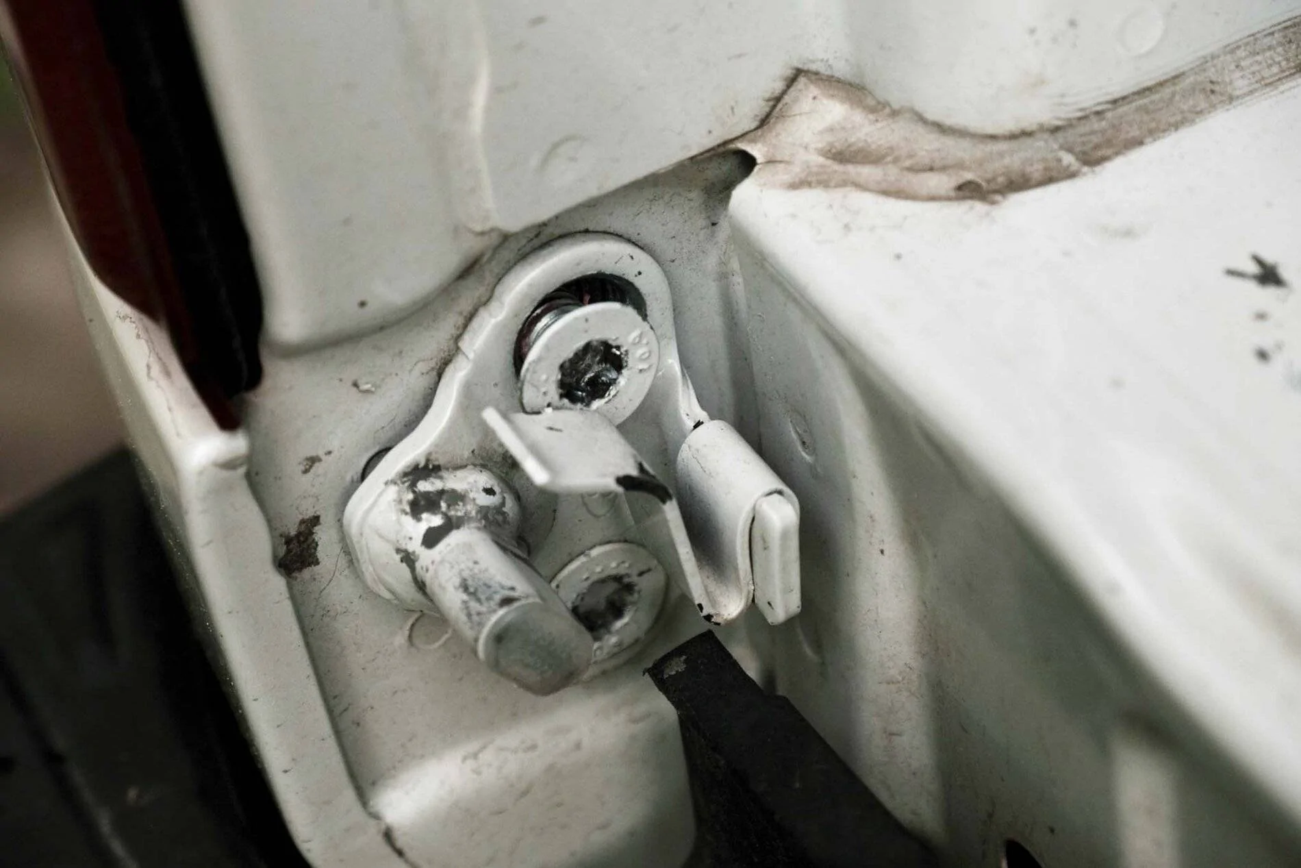

For our alu-cab install, I need to remove not just the tailgate but the hinges. Halfway through it became clear that these bolts do not want to leave home. I made a mess of it but I don't feel that bad since my son did too. 1) It's bonded red loctite. 2) the bolt is aluminum and super soft - presumably to avoid steel on aluminium corrosion, almost like they never contemplated having it removed and 3) it's nearly impossible to get a straight run at it because of angle and obstruction. At this point I'm screwed if I can't figure this out because leaving on a long trip and I can't put the canopy door on OR the tailgate back. :facepalm::facepalm:
I was afraid to use an impact driver because of angle, so tried a breaker bar / wrench, but that is slow rather than rapid break and worse I can't get any pressure on it - my son suggested that slow torque rather than quick impact might be contributing to problem. At this point the heads are an EMBARRASSING mess, so much I don't really want to show it here. But as bad as it looks I still have resistance so all hope isn't lost. Here are options my son and I came up with:
1. Rubber band trick -- didn't work.
2. Try the impact driver --could make it even worse.
3. Vise grips. Hahaha good luck.
4. Get plus size torx bit and pound it in with hammer.
5. Drill it out.
6. Use a bolt extractor.
At this point the bolts are a loss; I'm a lot more worred about f'in up the threads. Also, the reverse side of hinge clip is another clip which is moving around. Given space in there I'm not sure how I could even get in there to replace other side of clip if I have to.
Ideas welcome. Observations pointing out that I f'ed this up will be ignored, cause yeah, I already know that lol.

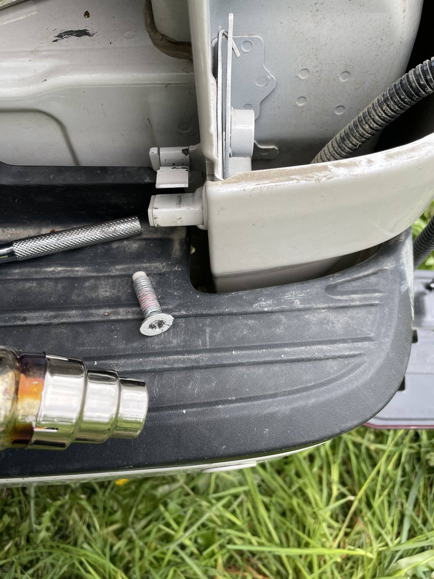

FYI, for anyone reading this, once you get the loctite softened it comes out easily with a 10" socket wrench. So if it takes more force than you can put on with a 10" lever, you need more heat, not more force. (I used 700F for about a minute, with concentrator nozzle, be careful because it's easy to heat up the plastic wiring harness as well.) Wish I'd known that before, but of course no one will read this thread until aftere they make the same mistake I did..
..also not sure what force it is that compelled me to try every single bolt so that they are all messed up instead of figuring out how to deal with one first.
