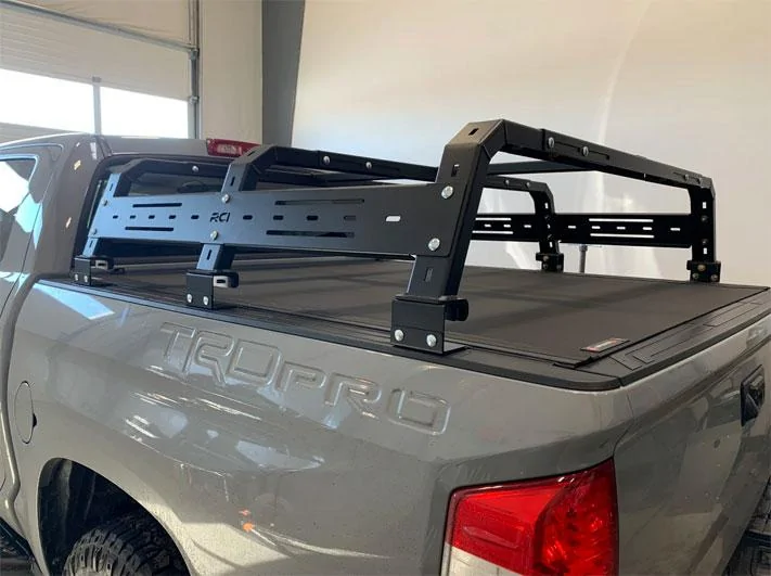

Here is a picture of what I am trying to do. This is a Toyota, but the idea is the same. The only problem I see is that the rails for the bed cover would not be 100% flush against the inner truck rails once you add the adapters. Although it's a very small space, I'm not sure the tolerances would allow the cover rails to fit, or it might cause water to leak in unless you completely sealed it.

I researched this a ton early on. What you see on the Toyota above is that he trimmed the actual tonneau rails around the bed rack brackets to allow it to sit flush. You cannot do this with a retrax style cover. I have a buddy with a retrax and a bed rack and he had to buy seals and put in the gap left after installing both. Trust me, I looked for every solution and there’s no better way with the retrax. For this reason I went with a soft roll up cover for my setup just like you see above.

Thanks! That was exactly what I was thinking. I think I'll do what OFC Ranger suggested and just mount the rack on top of the the actual truck bed rails. In other words, just like the picture of the Toyota set-up but with the adapters mounted on top, with no side bracket extending downward to interfer with the bed rails. In fact, the adapters would work great by just cutting off the part that extends downward.

Exactly what I did. I bought the tonneau to work better with the tonneau brackets then ended up having a custom rack made and just bolting right through.

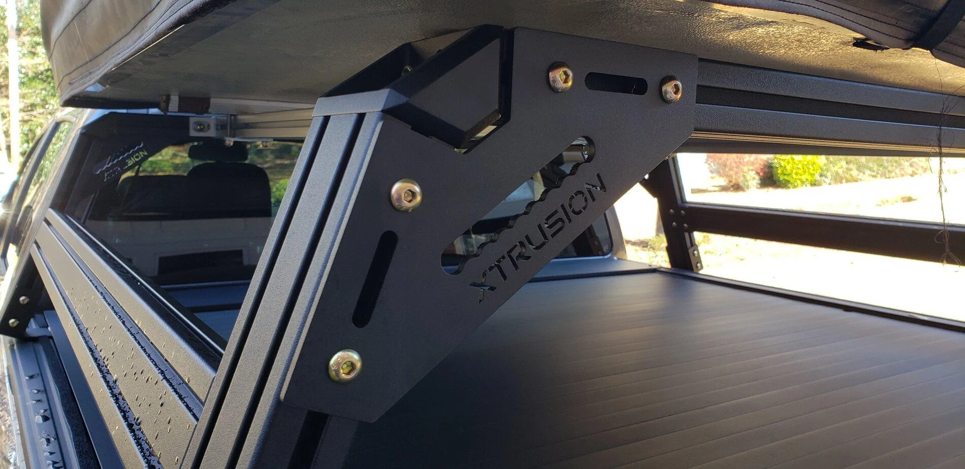

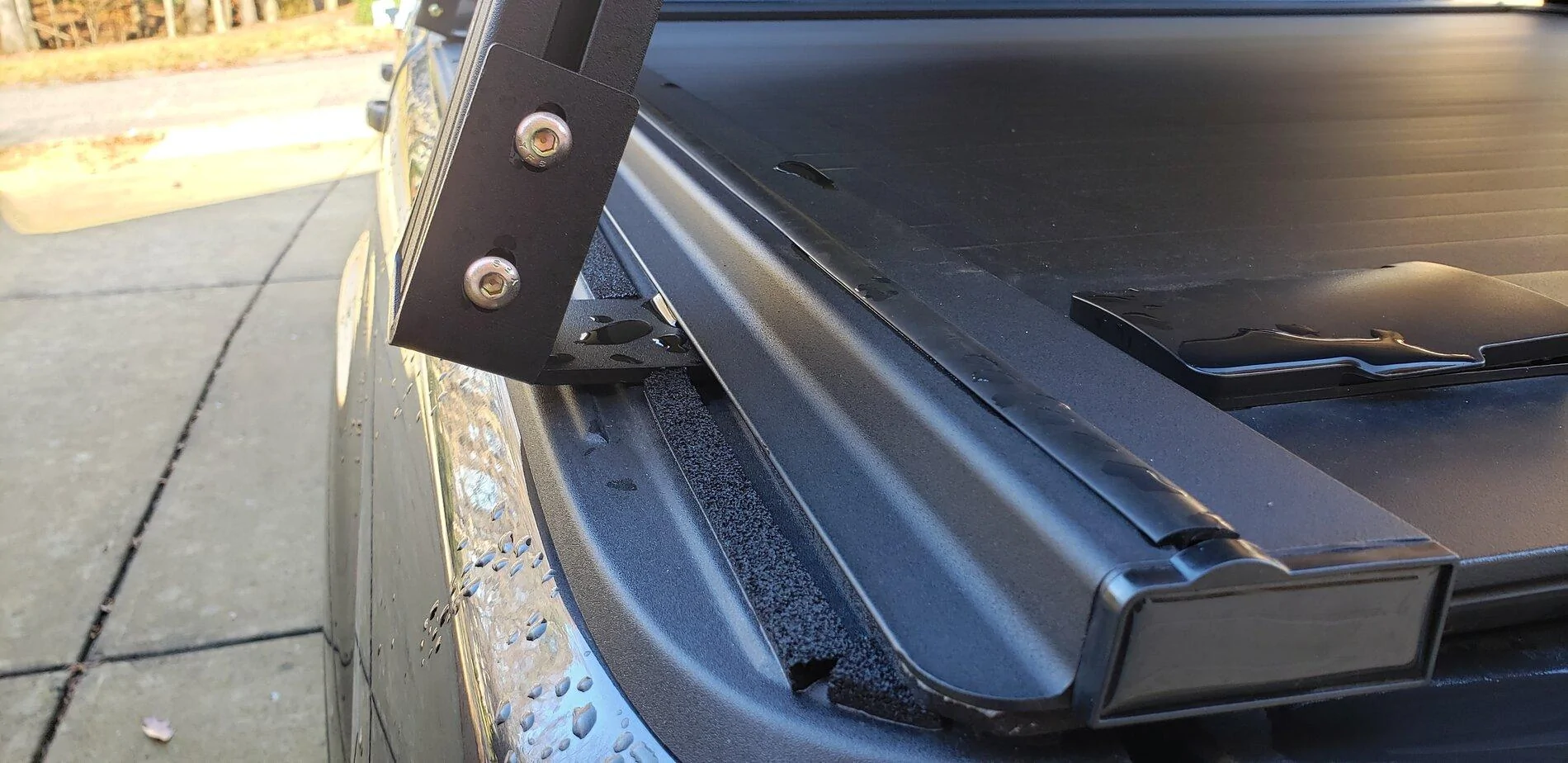

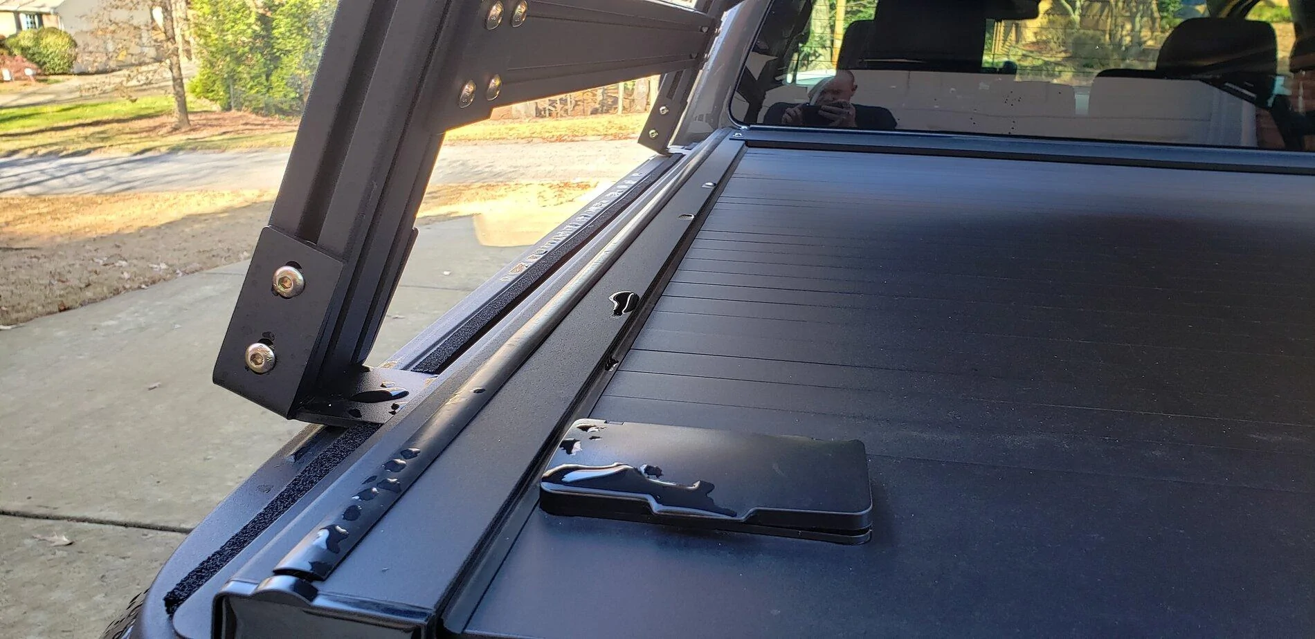

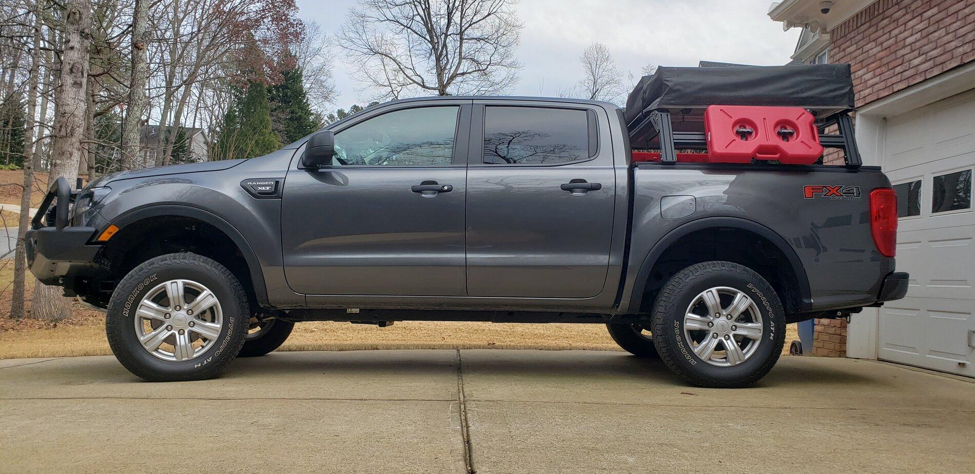

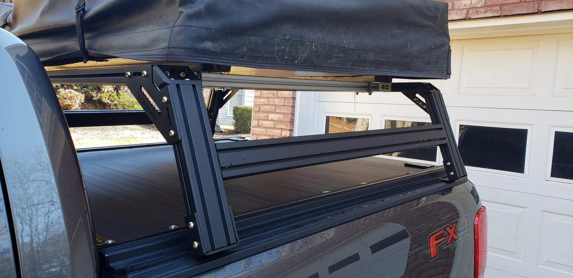

This doesn't use the specific equipment you've mentioned wanting to use, but it accomplishes the same thing and there was no drilling into my bed rails. The best part is, the manufacturer of the rack can pretty much tailor it for your needs as far as height is concerned, and 5' and 6' bed lengths. In the phots below, ignore the extra strip of black foam running on top the bed rails; I've since removed it.
