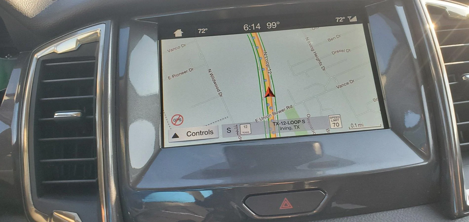

    20190814_181433(0).jpg I have the current version of Sync3 and experienced a problem with navigation. After my truck was parked in an underground parking facility, I had a no GPS symbol displayed in the lower left corner and navigation functions did not work. Quite inconvenient to those needing navigation to get home.
    I tried a key cycle at first stoplight, but no help.
    Truck had to sit outside for a few minutes for the system to find GPS signal.

    Just like loosing Sirus/Xm going under a bridge or a bunch of trees, you vehicle has to be able to see a satellite in order for NAV to function. I have experienced the "No GPS symbol after just such a situation, it takes longer for your vehicle to acquire the GPS Sat than the Sirus Sat., cycling the ignition should not be necessary, been there experienced that with the Explorer and the Mustang. My loss of NAV (No GPS symbol present) was when my Ranger was completely in the open and fully able to "see" the Sat.

    Yes, GPS does lose it's signal under bridges, trees and other aerial obstructions but reconnects when obstruction is removed.
    The problem with mine is it's inability to reconnect. I should not have to park outside the parking garage, shut off vehicle and wait until system reboots in order to go on my way. I was alone yesterday in stop and co traffic and was not able to play with controls much on my almost hour long trip home.
    When I arrived, I cycled the key but icon was still there and navigation was still lost. After 30 minutes, I started truck again and after a longer than normal startup time, the navigation system knew where it was.
