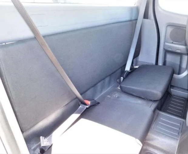

Hi All,
With my 2 daughters now just turned teenagers it was getting cramped on the school run in my old single cab - so SuperCab here we come. One of the things I was not happy with however is the lack of head rests in the back due to the likelihood of the girls hitting their head on the back glass in the event of a rear end accident.
So I have been contemplating how to fix this when low and behold I see that you guys in the States get not only head rests but much nicer and thicker "bucket" seats. Now I think I want myself some of these! Is anyone able to assist me with some part numbers for the rear seat in the US SuperCabs and maybe an indication of price if you have had to replace any parts.
Still, could be worse. If I was in South Africa in 2021 I wouldn't have the option of rear seats at all.
Thanks in advance,
Duncan

We can definitely help you with that but the first question is mounting points. Ours use hooks and latch down on bottom cushions and back cushions hook in on the bottom and 1 bolt on the top to secure it along with the child seat mount point. Do you have these mounting features too?

Thanks. Looking at photos online the bottom cushion mounts appear to be exactly the same. The backs are different because there are the two separate cushions with 4 hooks while the Aussie version is one piece that has two bolts securing it the bottom. We do have the child seat mount points below the rear window.
Fitting suitable hooks for the seat backs will not be a problem for me. I am a mechanic by trade and an engineer by degree and currently design and certify seating mods on aircraft for a living.
