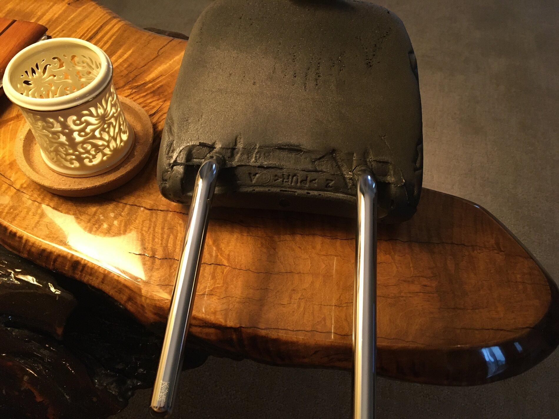

Everything is there except the button and the trimmed hole in the headrest cover. I removed the headrests, removed the cover, cut a piece of 1/2" wooden dowel rod 1-3/4" long and slid them into their respective holes, reinstalled the cover, reinstalled the headrest into the seat, good to go!
What gets me is that the foam is even cut for the button. I would have paid for the hole and button and not blinked. I just don't get it.
Oh, and the folded headrest's highest part is about even with my tailgate in my rear view mirror.
So, now I have folding headrests with hidden buttons.
Almost forgot, thanks for the pics. Once I saw the springs in the pic, I couldn't stand it and went out and took everything apart.
Thank you! This is why I have no posts of my own. You guys answer all my questions already. Found a dowel in the garage, cut to length and good to go. Hardest part was figuring out how to remove the cover from the headrest. I rolled the bottom of the back and it came right out of the channels on the 3 bottom flaps, which are visible in your later photos. We should all log an entry somewhere if we ever actually flip these back up.
