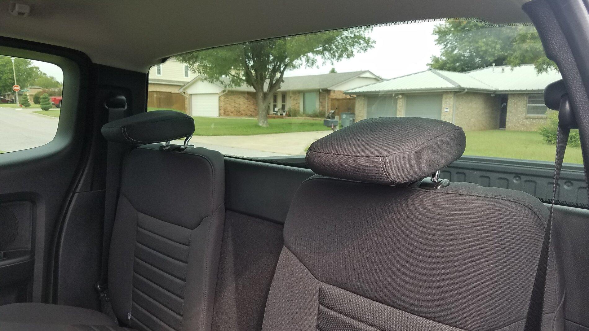

Hah! My 2020 super cab now has folding headrests! Also makes removal much easier as well!
Everything is there except the button and the trimmed hole in the headrest cover. I removed the headrests, removed the cover, cut a piece of 1/2" wooden dowel rod 1-3/4" long and slid them into their respective holes, reinstalled the cover, reinstalled the headrest into the seat, good to go!
Thanks for the tip. Added the dowels to mine yesterday. :)
