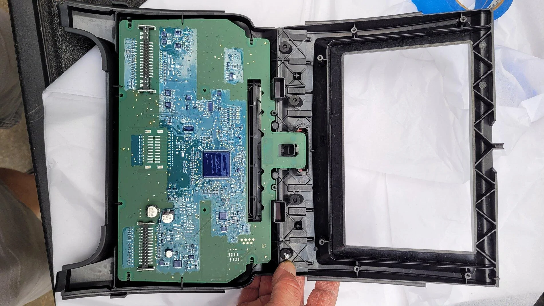

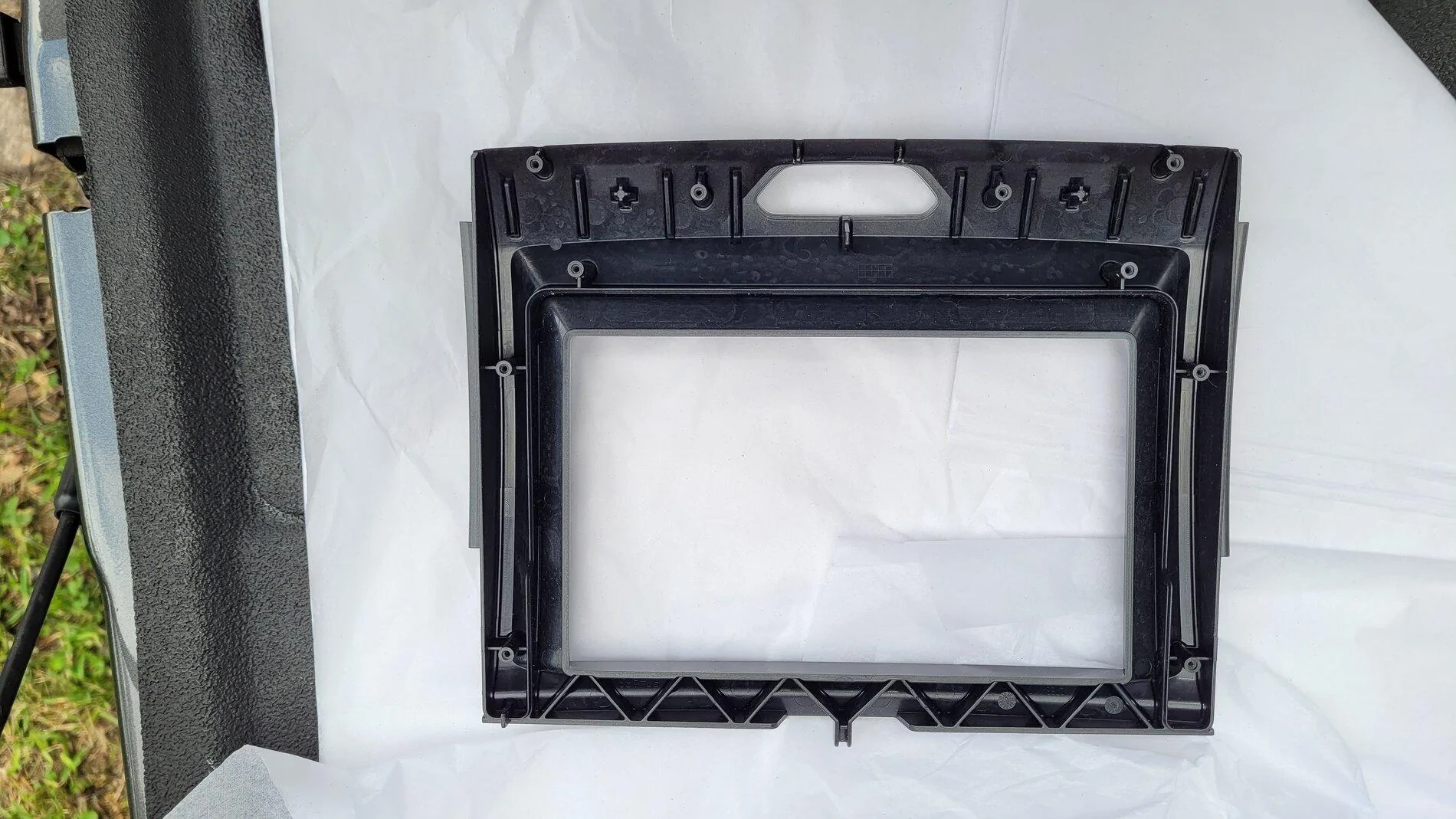

So I was finally able to pull the bezel out to apply clear plasti-dip. Pulling the HVAC panel out surprisingly only takes about 10 minutes. Then on the back of the panel is a set of T5 and T7 torx screws. After removing the cover plate there are four additional screws that hold the bezel to the rest of the assembly. Separating the bezel makes it so much easier than masking everything off.
This is the backside of the HVAC panel with the cover removed.

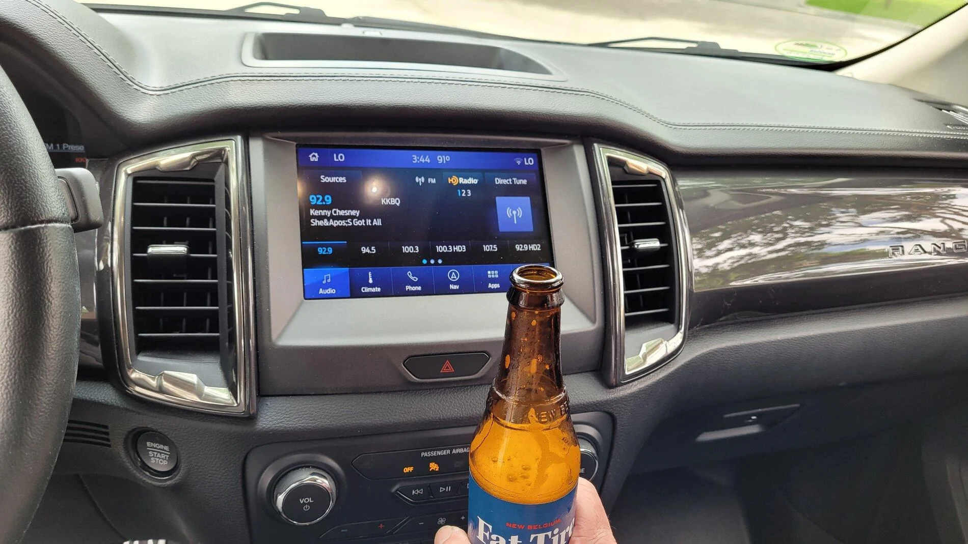

The front of the bezel after 2 coats of clear plasti-dip.
Four coats and everything reinstalled back in the truck to make sure it all works. It also now looks just like the XLT bezel.
Best part is no more glare!

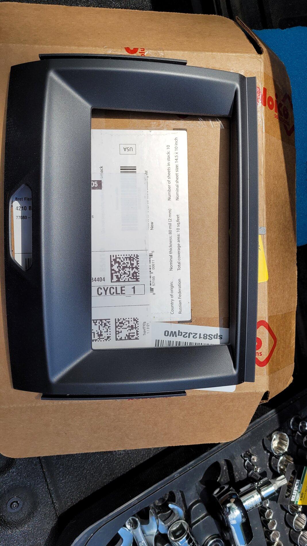

Talked to my tint, decal, wrapping guy. Said tint probably wouldn't do it and gave me a piece to try, it didn't. He could wrap the bezels. The one that gets me is on the right side of the steering wheel. They are matte black on the XL and I ordered one for the problem spot to see if that works. It is amazing the car and truck makers think that shinny is good on the dash,
