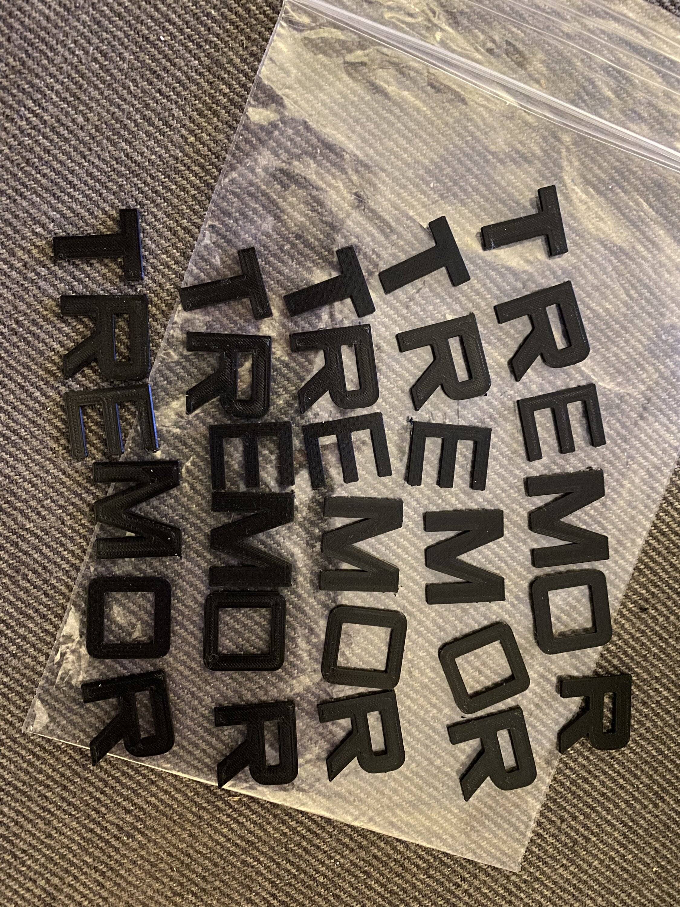

I am tackling this sometime in the next few weeks. Going to bother me to see the truck missing trim for a few days.
Plan to fill in all the gaps and paint the middle magnetic to match the border. Maybe a red accent. Had these printed up a while ago.
