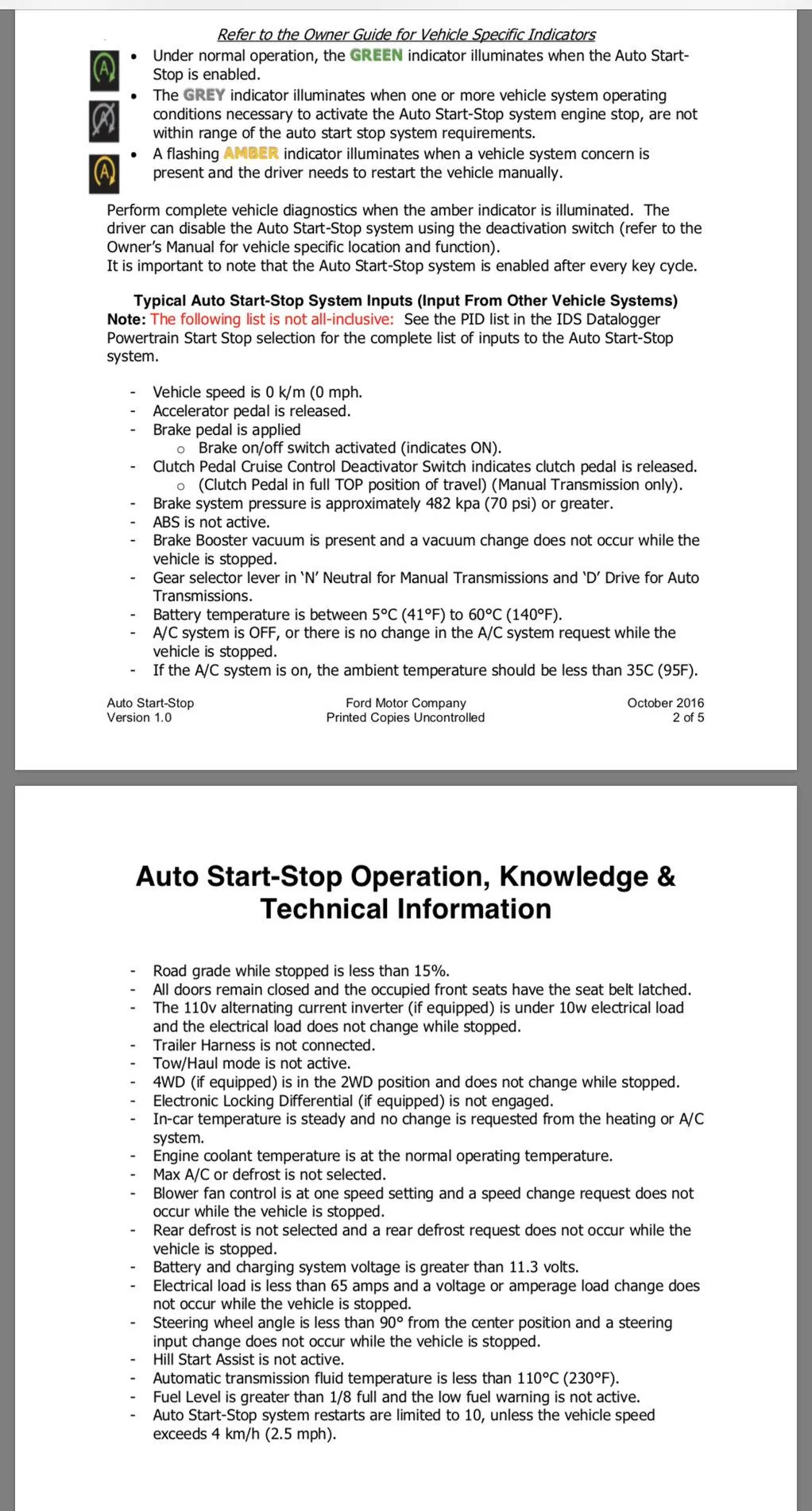

Today I noticed that my Start/Stop feature was not working.
It was on, in drive, no A/C, no trailer connection, engine warmed up.
Ambient temperature was 42°F.
I did not have the heat turned up.
Does the Start/Stop feature require a minimum cabin temperature to activate?
Am I missing something?

If your AC or Heater is running to bring your cabin up to or down to set temperature it won’t kick in.

If the wheel is turned, auto start/stop won't activate. To see why it is not activated, you can see the reason in the Fuel Economy menu.

Plug an LED nightlight into the 110 AC outlet in the Rear console area. I did that a couple months ago and S/S hasn’t kicked in since!

I’ve found quite often that when mine doesn’t shut down the menu says it’s due to the truck charging.

I see that one a lot. 8 mile drive to work On city streets and it rarely shuts off now. Drive a couple miles on the freeway and it’s back for awhile.
I’m wondering if it’s really low on charge. 8 miles on city streets should be enough to keep it topped off.
