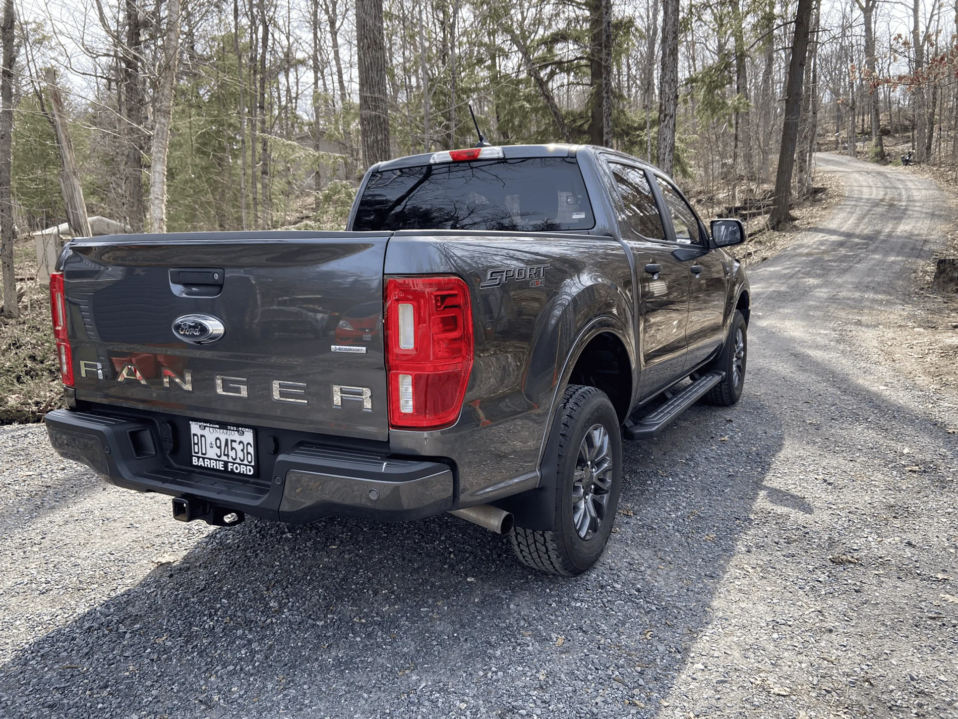

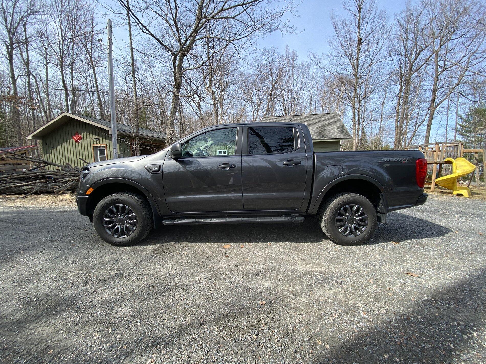

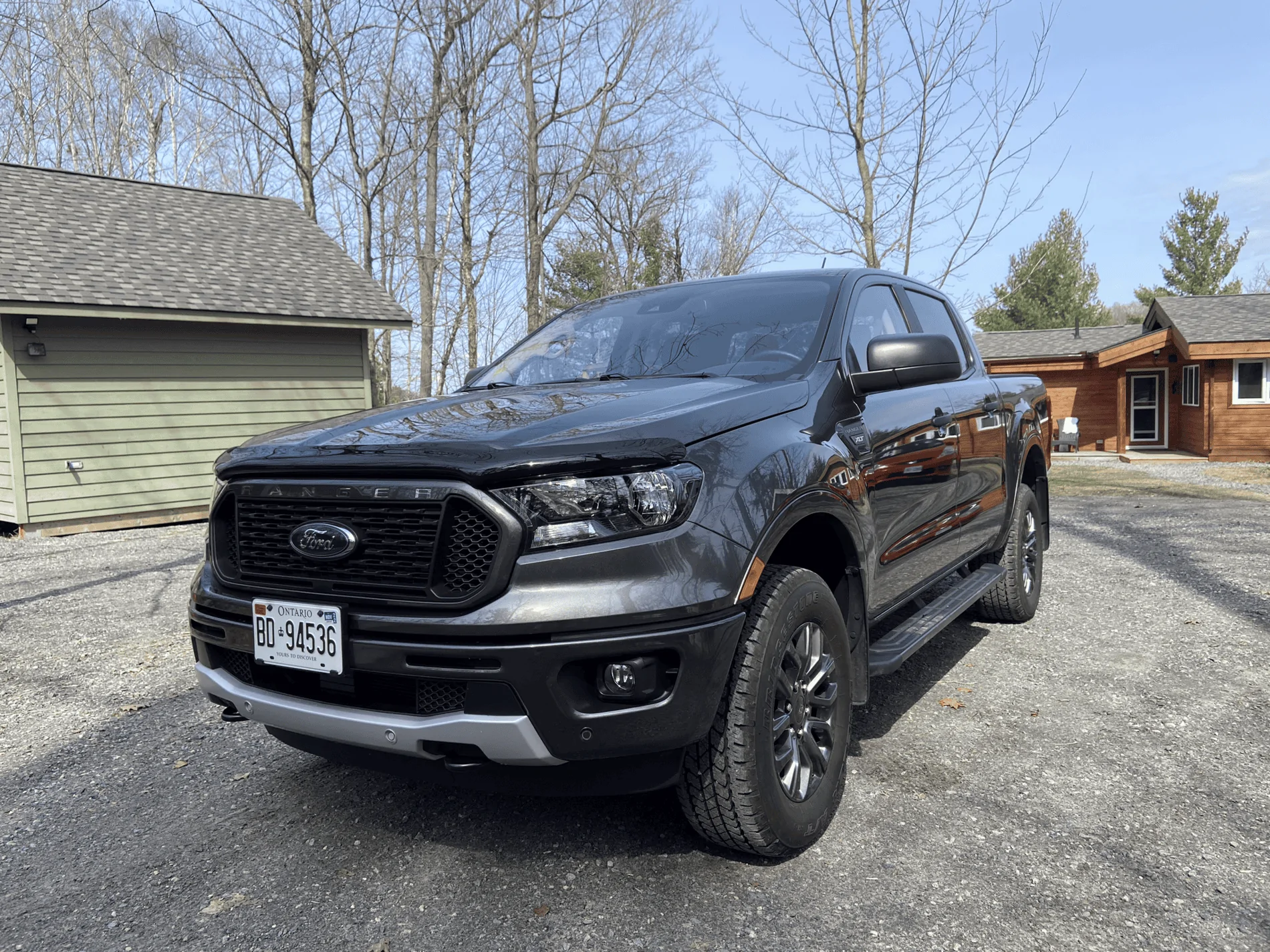

Well I did my spring exterior detail today. I decided to skip the polish as the paint was pretty perfect. And because I skipped the polish, I also skipped the IPA wash.
I did put the iron spray on it, but not much happened. I clayed it with the Griots Garage Synthetic Clay. It was very easy to use. Dropped it twice and just washed it off. If it was an actual clay bar, that would have been two in the garbage.
I love the Rain-x window treatment. When it is newly out on, you barely have to turn your wipers on because the water just sheets right off.

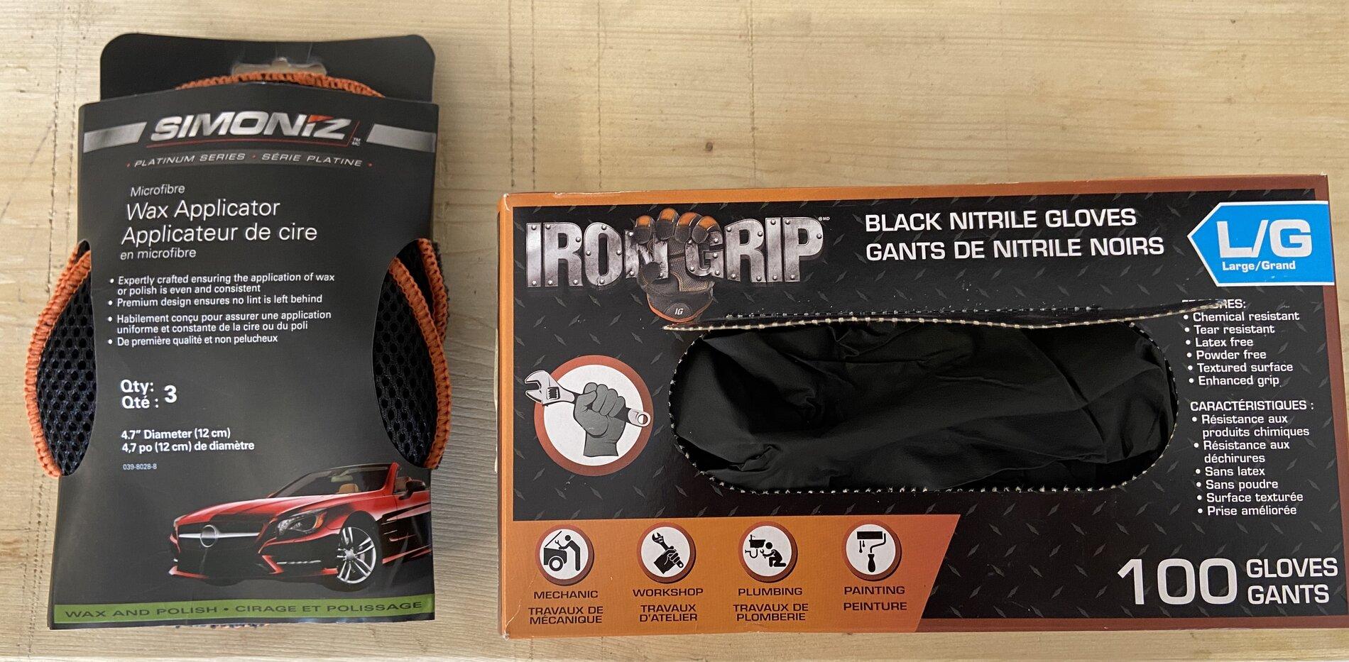

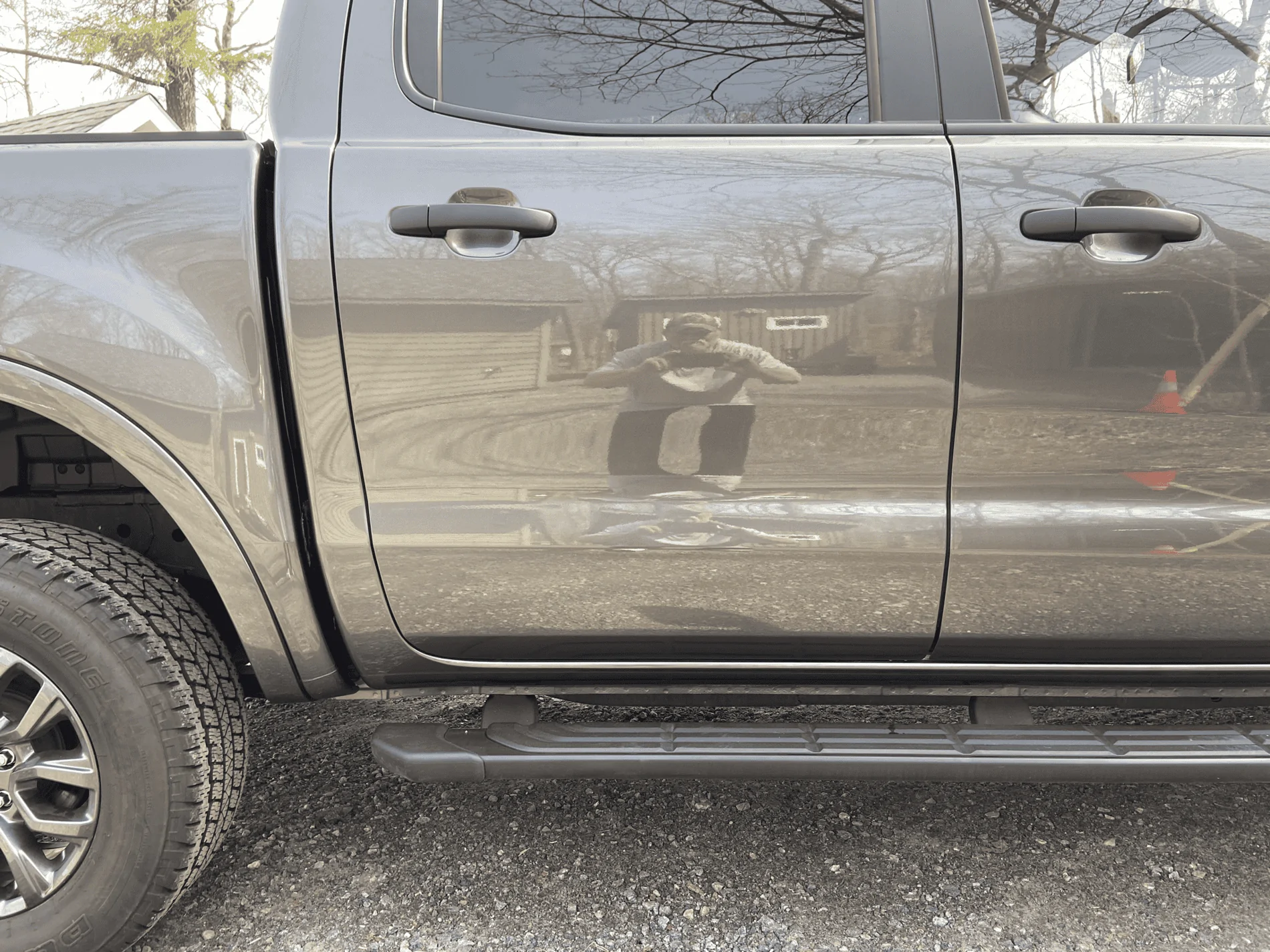

I put the new Turtle Wax on. I put it in by hand. I liked the wax pad I was using as it had a sleeve at the back to slide your hand into. The wax went on easy. I put too much on. I know this by how much I ended up using. It did all wipe off and buff up well.
it did have a mirror finish and was slick. I am sure water will sheet off and bead up really well. It should last as a base cost until the fall. I will use the Turtle Wax Hybrid Graphene Flex Wax as a maintainer.
For the first time I wore nitrile gloves and they protected my hands well. They come in a package of a 100, so they will last awhile.
The pictures do not do the finish justice.
