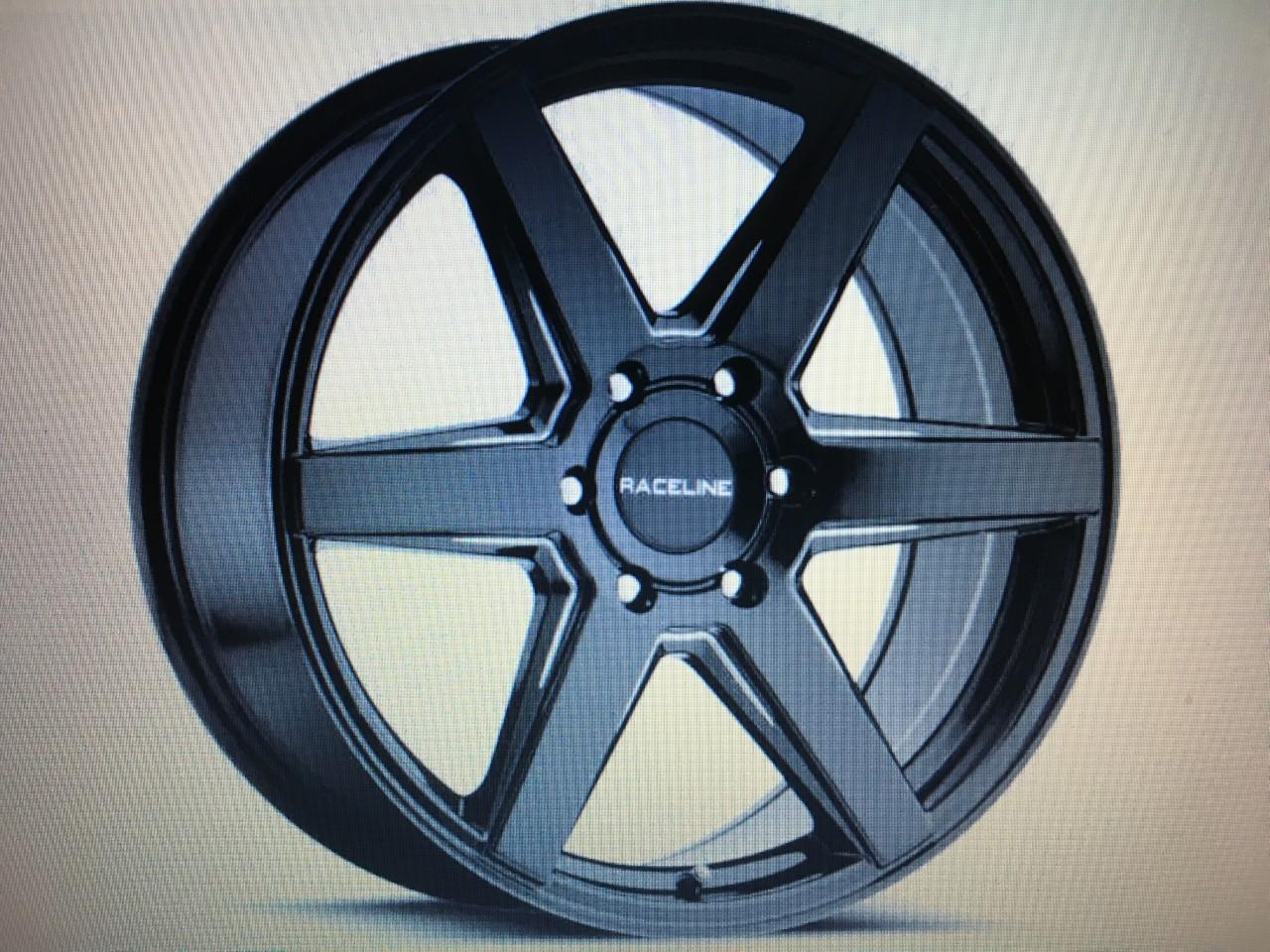

I'm going a different route (if it's do-able) and planning on lowering the rear and maybe the front (just enough to make it level) and I've been looking for wheels that look sportier. None of those, as some have called them, "bro-rivet" style or the "typical" 4x4 wheels. I have found one or 2 that I like, but finding the 6x139.7 / 6x5.5 and 18x8 with the 55mm backspace doesn't exist, or at least I haven't found them. The pic below is a 18x8, 6x139.7, with a 35mm backspace.... Is this backspace "OK" ?
If anyone has any info on stock size sporty looking wheels, PLEASE, post the link or info here ! Thanks !!!

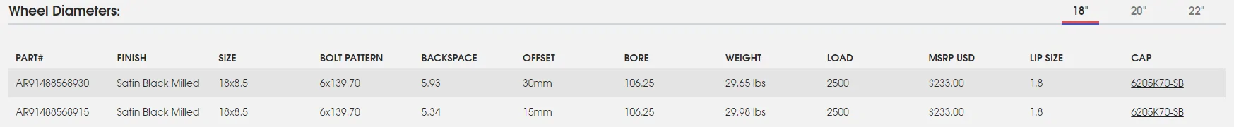

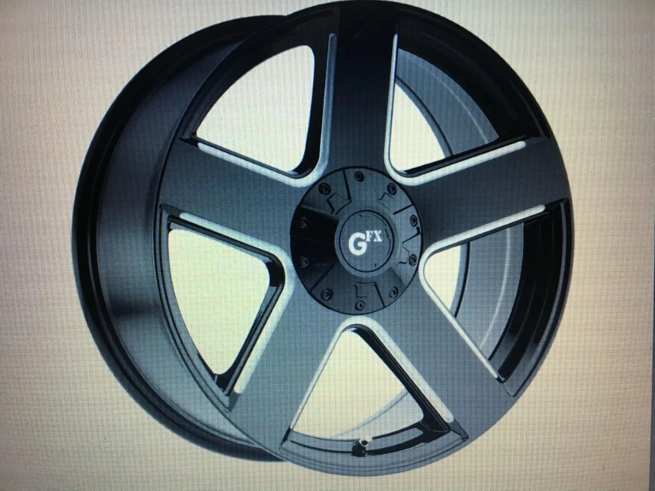

Just came across this one---18x8.5", 6x5.5 (139.7) 30mm positive offset.

I have not found many options over 30mm offset.
Keep in mind the 25mm you're lacking equates to about 1" more stance on the wheel.

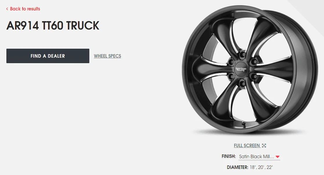

I know these don't exactly match the style of wheel that you have posted but I came across these in my own wheel search and thought they would look awesome for a sport setup, which I am not pursuing, and since you are going for that I had to share. They don't match stock exactly as they are 8.5" wide instead of 8" wide and 30mm offset instead of 55mm offset so they will stick out about 1.25" further.
