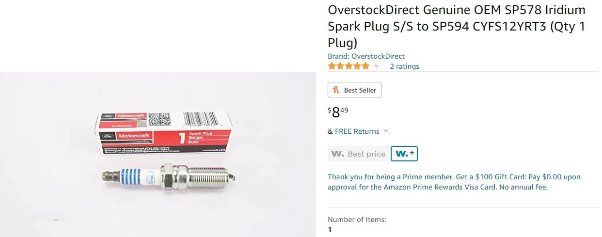

This is what's on order...confusing right?

I think the 594 is the max endurance plug "Ruthenium", whatever unobtanium element that is, IDK?. The 578 is the Iridium version. Just FYI, Rockauto is about 25% less than what you have pictured on Amazon for the 594 plug. Of course, you have to get more stuff to justify the shipping versus AMZN.
