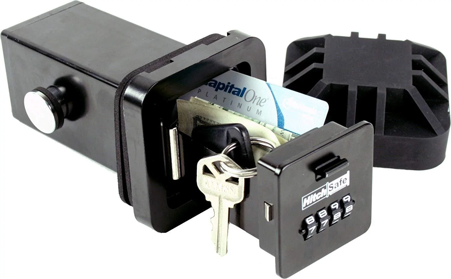

If you don't succeed in getting a third key, you can place your second key in this...

I second this idea - I bought one of these for when I go hiking and it has worked out exceptionally well. The only glitch is that I have to remove the keyring from my Lariat Fob and just put the fob in the hitch safe. The fob is so big it won't fit with the keyring attached. I just leave the keyring in the truck. Works great.

Not wanting to skirt your question, but I intend to install a wireless, keyless entry pad on my 2020. The $100 part is waiting at my dealership and I will probably mount it to the inside of the fuel fill door (which another member here suggested). It is also my intent to purchase the part using my Ford pass rewards and to program it using ForScan. The hitch setup MS suggests is slick too.
This should fit my needs nicely (provided the truck's battery isn't dead).

I don't believe you can program the keypad with FORScan - I believe it has to be programmed by the dealer. If I could have programmed one using FORScan, I would probably have gone that route rather than my hitch safe.
I visited another thread here on the subject and yes, indeed other members had the dealer program it, programming via ForScan was not possible.
DentonB did say that there is an installation charge of $12.50 for the pad, an incredible bargain. I certainly hope that this charge includes programming the pad, and not just sticking it on somewhere on the truck, I'll call my dealer's service dept. to verify. In my locale, the charge is just $12.00, a savings of fifty cents!
