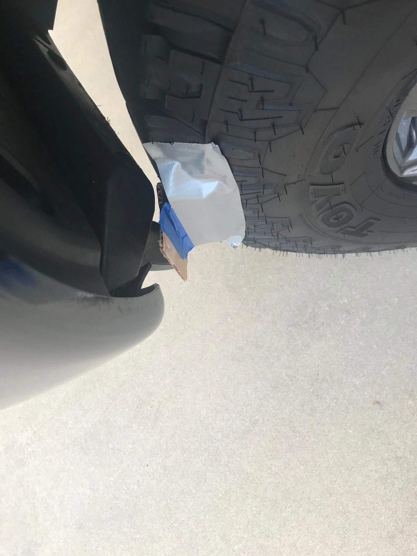

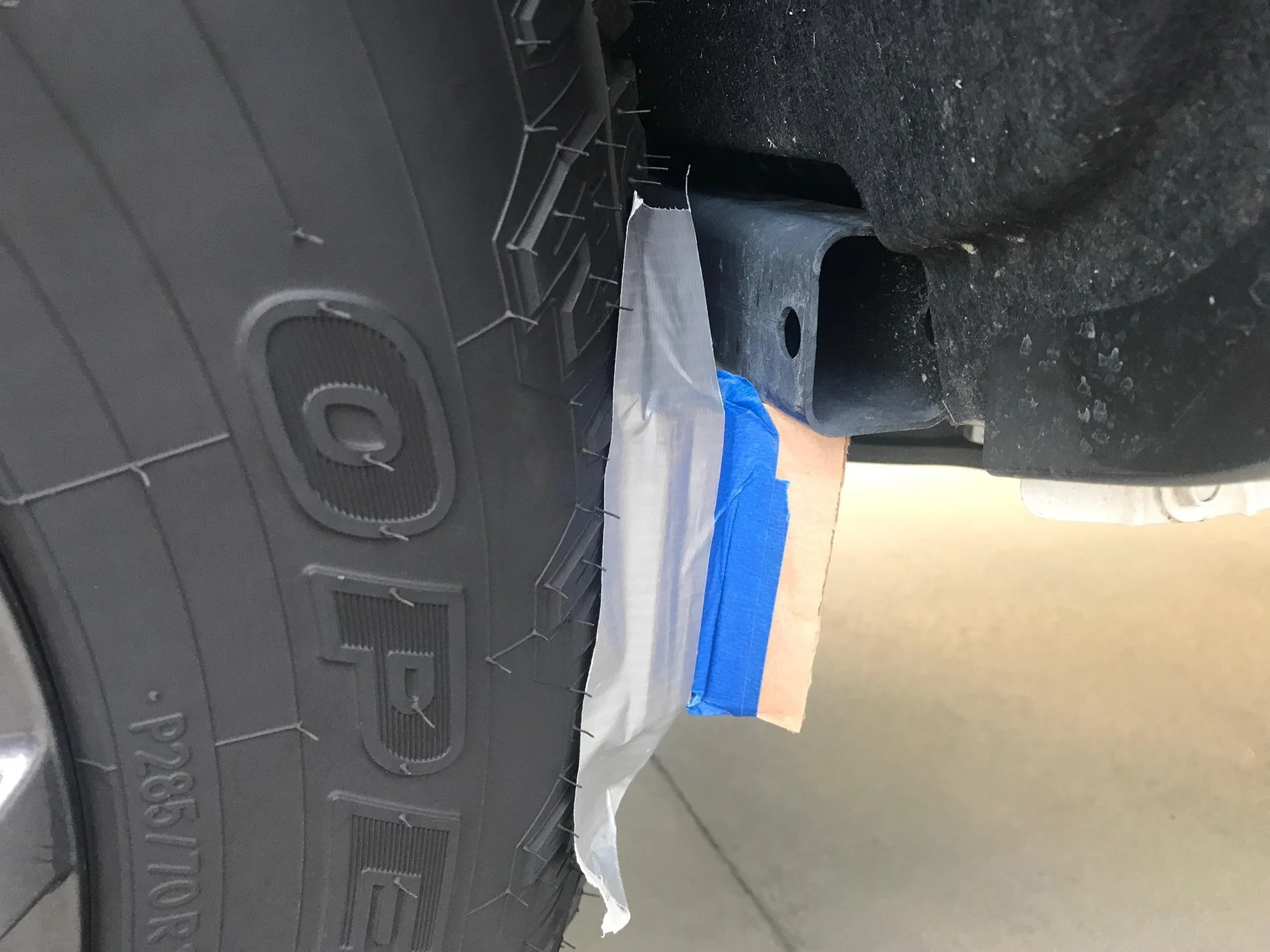

So that is basically my question, should I be figuring clearance based on a 35" tire. Am I wrong in my line of thinking? 33" tire + 2" spacer should translate into a 35" tire in regards to turn clearance yea? Or am I off base with anything?
Well so far here is my super non-scientific test. It confirmed what I already knew, crash bars gotta go. I'm just wondering if it will be enough. Ill look at it in more detail with an actual measurement tape tomorrow I suppose. I know some well lining may have to be pushed back, which isn't that big a deal.
Front:
Rear:

Well yes and no. Installing a spacer pushes the entire setup outward, which is great for suspension clearance regarding different wheels and things like the knuckles or springs, but from my understanding strictly in regards to turning the wheel all the way left or right, you make clearance worse . (I think maybe they call it scrub radius?) Using the L-shaped cardboard test as in my photos I'm visually showing the wheel 2" pushed out. When the wheel is straight, no big deal, but as it turns now its coming in contact with things it did not before. Right?
You are correct about that. That is the wonderful joys of bringing your wheel and tire out from the stock position. For example let's say you're running that 33 in tire from the stock location. You're able to turn all the way left and right with no problems. You decide you want to bump the wheel and tire out with spacers for looks or any other reason. When you have the wheel in any position you have to measure 2in out from those positions to get an idea of where the tire will be. That is the joy of things with wheel spacers or wheels that bring the tire out much further than the stock location.

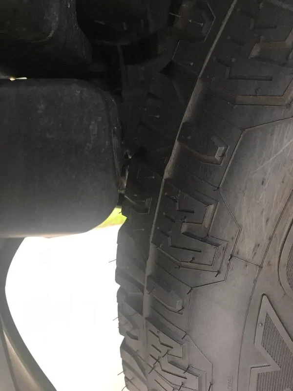

This is my clearance right now at full wheel lock, crash bars still present, with 2" level, stock 17" wheels, and 33" tires (all of these items factory installed before I bought it):
Edit: I would say the clearance is even tighter as the wheel turns and the apex of the wheel passes the crash bar. This full lock is on the "slope" of the tire, or I guess you would say side wall.
