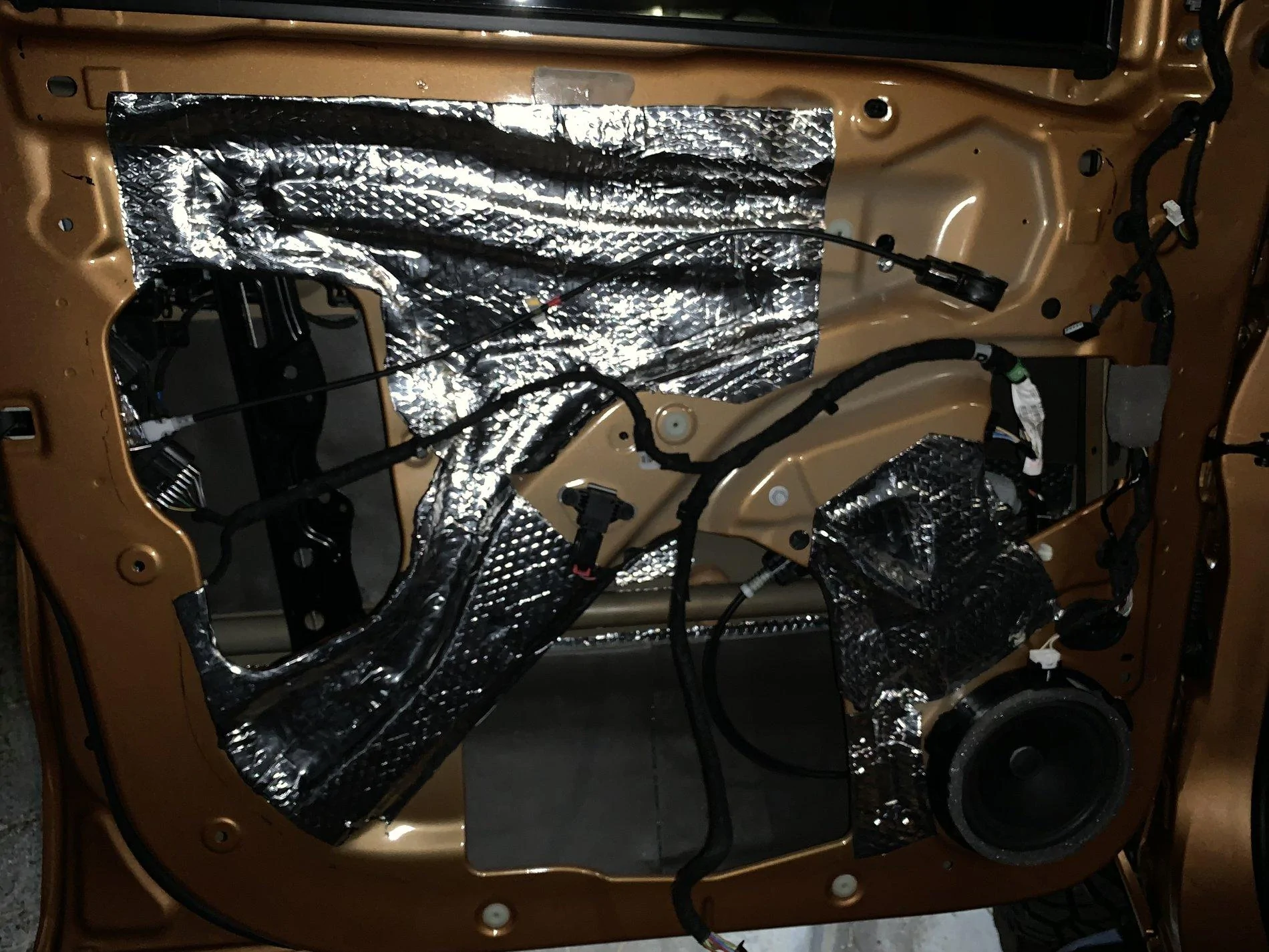

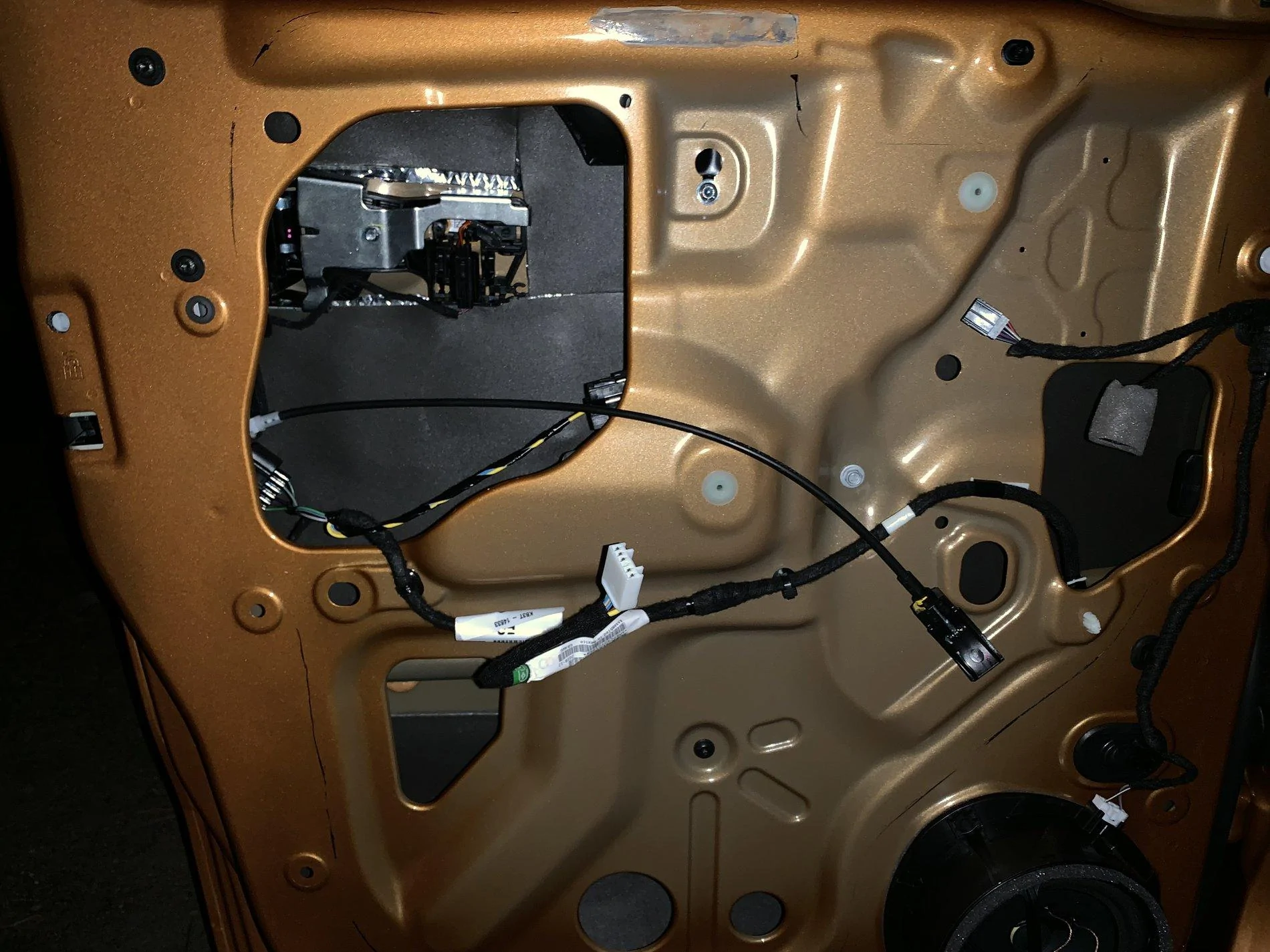

All four doors and behind the back seat have been covered in Butyl and a layer of CCF. Absolutely worth the effort... the cabin is exceptionally isolated from outside noise and the SPL of the door speakers has improved as well. The bass is clean and punchy, mids are now actual mids and not rattles and mush.
^ after 80 Butyl
^ after 170 CCF
^ after isolating a few of the vibration prone sections.
I also put a few sections on the door panels themselves to keep the vibrations down and a small section of CCF in the door handle to get rid of the crunch plastic sound when you grab the handle.
Solid door closure also puts a smile on my face. It’s like a whole different truck now.. and I thought it was quiet stock.

I used the brand called Noico and you can get it off amazon. I bought 36 sq ft of both the sound dampening material and the closed cell foam and it was just enough. The cost was $65 for the butyl and $49 for the CCF. You will want a $10 roller to help apply the material but it is a really easy to work with product. If you are applying it under 55* you will want a heat gun to keep it pliable and flexible. It took me about 6 hours to do as well.

No it was pretty easy. Just two screws behind the handle trim, one behind the door opening mech, and two on the bottom. Then you pry the push pins out and lift up/out.
