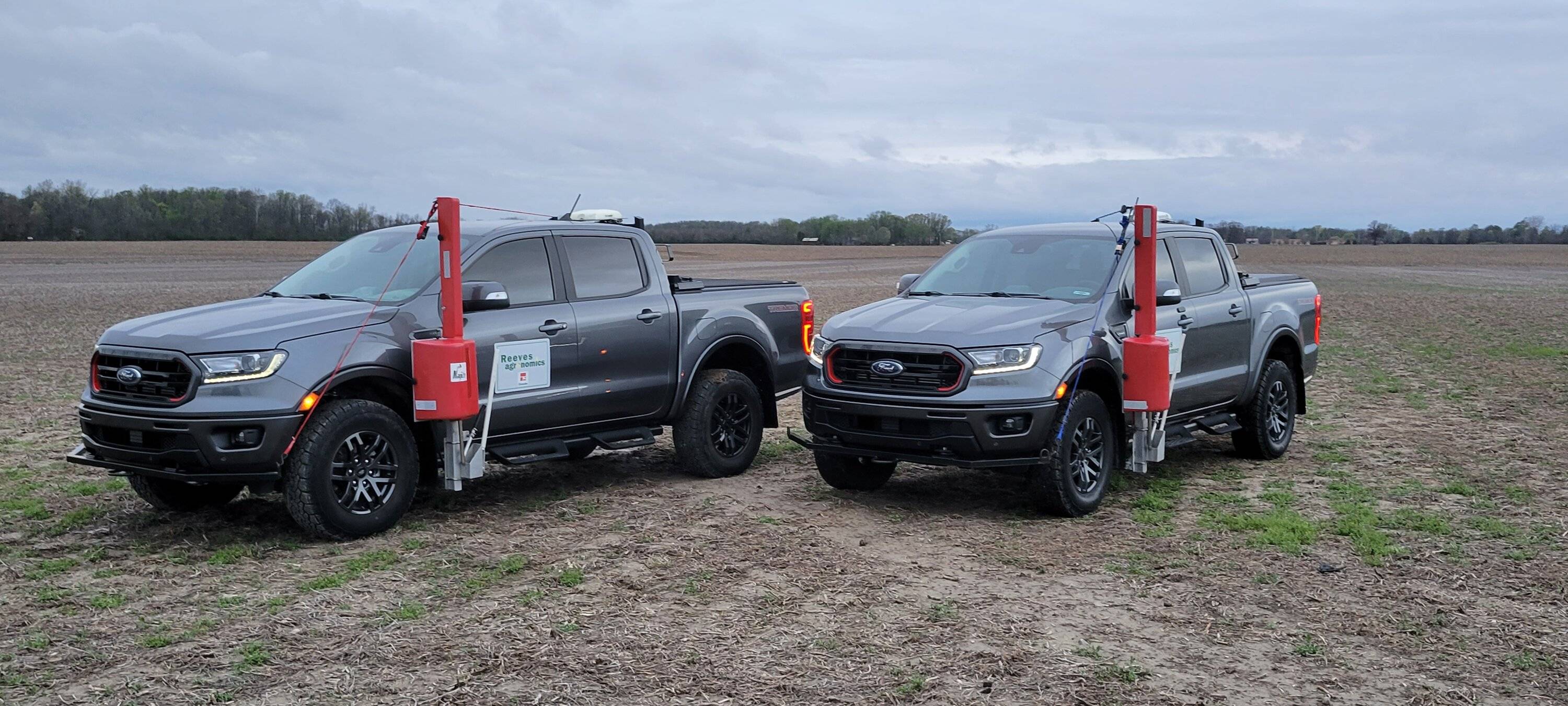

Soil Sampling Twins. 1 one is a 21 501a. The other a 23 500a

pretty nice rides to be out doing field work
Yes, However if you compare them to a Polaris ranger or a Johndeere gator with cab heat and air and a trailer to haul it and a good truck to pull it those 2 are pretty reasonable. I started with old beater ford rangers and they had too much down time. The 97 leaked a quart of oil to a tank of gas. The 2000 burned a quart of oil to a tank of gas. The one I traded off for the 23 was a 2009 from Canada. It ran great and looked great but the bed supports kept breaking rusting and the the front fender mounts were braking/rusting. We ran it for 4 years with no issues other the cancer. I drive the 21 for work without the probe on when not sampling and my wife is going to drive the 23. The 2010 expy is getting some age on it. Also the ride is unbelievably better then the old rangers.

They both look great but I prefer the gray one ?

I like the trucks, but I"m curious about these devices you have bolted to the sides. Obviously they're for collecting soil samples. Do you drive with the window down and pull down on that arm to collect the sample? I'm guessing you're collecting an aggregate of the soil in a given area, because it doesn't look like it would be able to identify the samples you took individually...

Yes just just like plowing snow in a parking lot with the window down. You need a good heater or good AC. 2 days out of the year the weather is perfect and you wish you were out in the open.
We take 10 cores from a rtk gps point that we have laid out using other layers of data. Then lay that information on a 2.5 acre grid. Then following the rtk gps on the ipad drive the truck to that exact spot and pull 10 cores 6 inches deep in a 40 foot circle. Then reach out the window grab the handle to get the bucket and pour soil Into a small sample bag.

I reread your question. There is a .5 hp 12volt motor that drives a rack and pinion that d the probe down and 2 proximity switches one you adjust for depth the other to stop it at the top. We have a key fob remote to operate it.

A video demonstrating this would be too cool!

Give me a day or 2. Just found out I have a couple more small fields to do.
