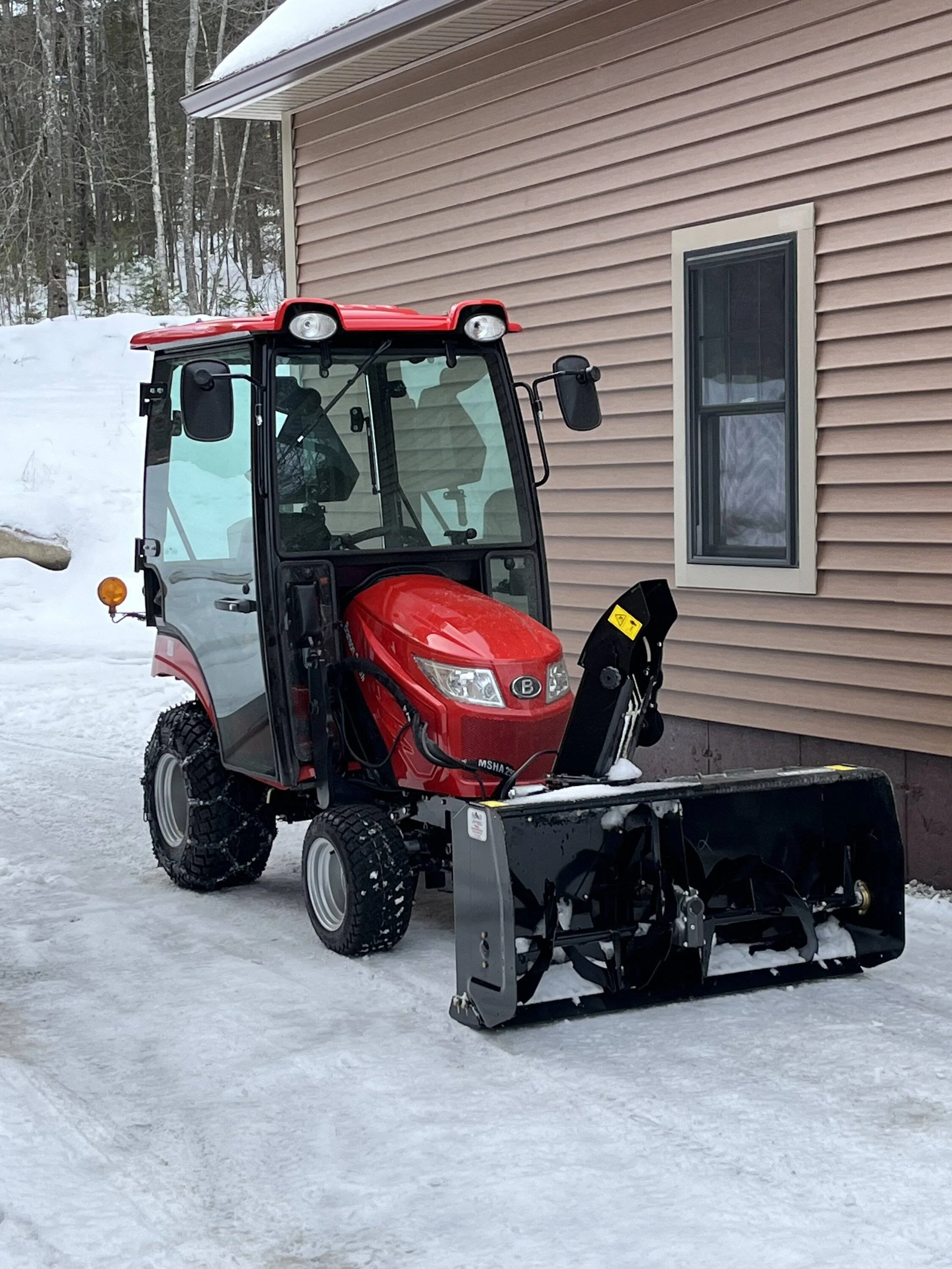

One of these or put a plow on your ATV or UTV as I see your in Maine you likely have one of the two.
I have a snow blower like this that mounts on my lawn tractor, and it is AWESOME!!! I don't have a cab, I just wear a hooded jacket, and always clear with the wind so it's not bad. My driveway is 110 feet, double wide. I run the full length, lift the head and reverse up the driveway, drop the head and go again. With hydro-static, and reverse mode engaged, I don't have to engage/disengage the blower each pass, I leave it running the whole time. Without turning 180 degrees each pass, it's fast and never face the wind. Even with a foot of snow, I get the whole driveway, walkways, detail work, widen the entrance, and clear the left side road shoulder for 50' (so less gets ploughed back in) in about 20-30 minutes.
Nice - I was thinking of using my lawn tractor for that when I lived in NB but I moved here before it came to be. Do use use chains and weights Jay?
