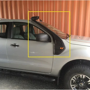

What are the options for snorkels on the 5th Gen Ranger? Is the Ranger Basecamp type snorkel available anywhere?

The snorkel on the 'base camp' ranger at SEMA is just one made for the International T6 Ranger. If you search 'T6 Ranger Snorkel' on ebay or aliexpress you will probably find it.
You could probably use it but will probably need a different pipe from the snorkel to the intake.

Ford is supposed to come out with one in the near future and already has a part number for it. I am watching for it because it looks like it fits in place of the factory insert on the front quarter panel.

This is a video I watched some time ago, it seems to require the standard amount of cutting that most snorkels do, obviously the inside plumbing would vary from the diesel.
But there are lots of pic.s like this that appear to use the stock opening as well, google "ranger snorkel install" and vids and pics will come up.
