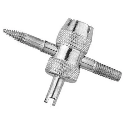

Small puncture, or, get yourself one of these, tire valve core tool, around 2 bucks at any auto store.
Could be something as simple as one of the small valves inside the stem has backed off a turn or two.
Small slotted arm of tool will tighten it down. It also pays to go around once or twice a year and snug all of em down.

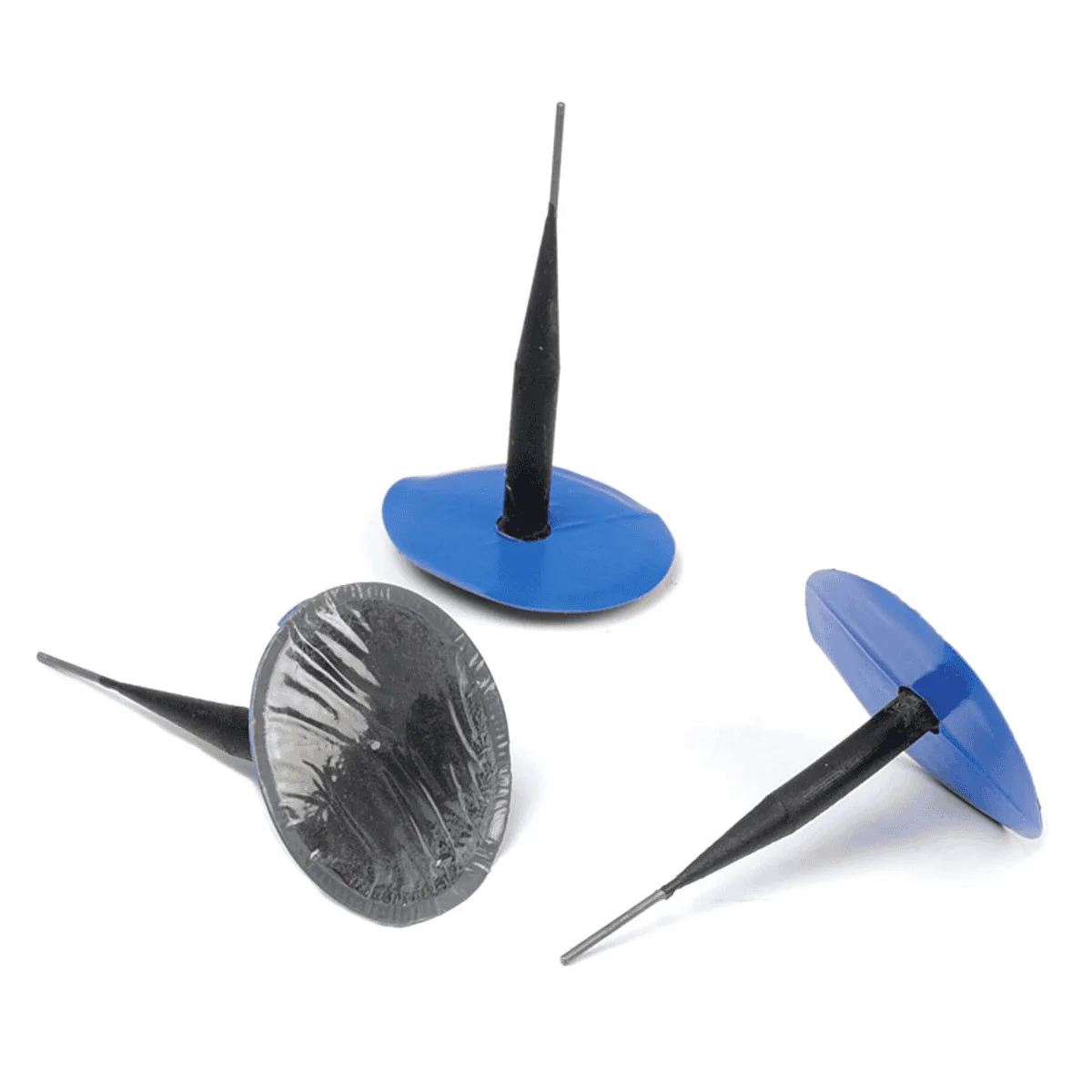

When I used to wrench for a living these were the guidelines we followed. Outside-in plugs were absolutely not allowed. If a tire had been previously repaired with one we would not fix it. The plug may seal the hole, but it does not patch the inner liner. If a tire had been filled with Slime/Fix-A-Flat we would not repair it. If the tire already had a few patches (three or five, I can't remember) we would not repair it. We only used combination plug patches such as these:
