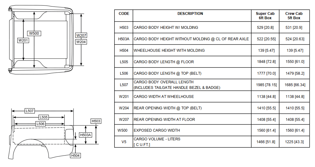

Anyone have/haul a side by side in the bed of the Ranger ? I’m wondering if a 4 wheeler or sxs will fit in the bed . I saw a hauler that fits over the bed and there’s always the trailer option, just looking for ideas.? I’m in the market for one or the other. Thanks

I’ve seen a smaller side by side (Polaris Ranger?) in a fullsized truck before. Not sure if one would fit in a FORD Ranger, but if you do, I’m sure many would be interested to see! I wonder if you go to a dealer and tell them that you’s buy one under the condition you can put it in your bed? ?

Make sure your not overloading the aluminum tailgate too. I had a Polaris Sportsman 400HO. It fit in the 5.5' bed of my Ram 1500, but the rear tires wouldn't allow the tailgate to close. I'd say the rear wheels will sit on the tailgate of a Ranger. I'd get a trailer, if it were me.

Sounds like a trailer is the way to go. Thanks for all the input.
