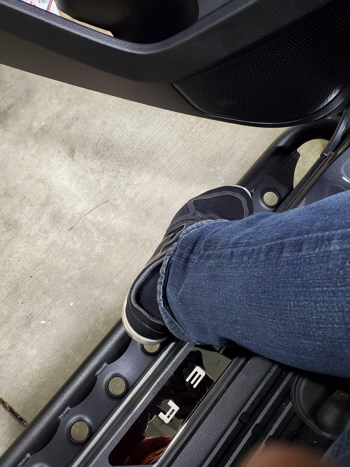

How well do these work as steps? Anyone able to compare to OEM steps? They look like they are a bit higher (good for clearance). How far do they stick out past the side sill? Are the tread plates level to the ground or angled down. I've looked at all the pictures but the different angles have me uncertain.
I probably don't need sliders since my offroading will be probably minimal, but I am new to trucks and may do something boneheaded that could be costly. If they could function as steps and be useful in tight parking situations where I can't open the door all the way, that may help my decision.

This is about how far they stick out for me

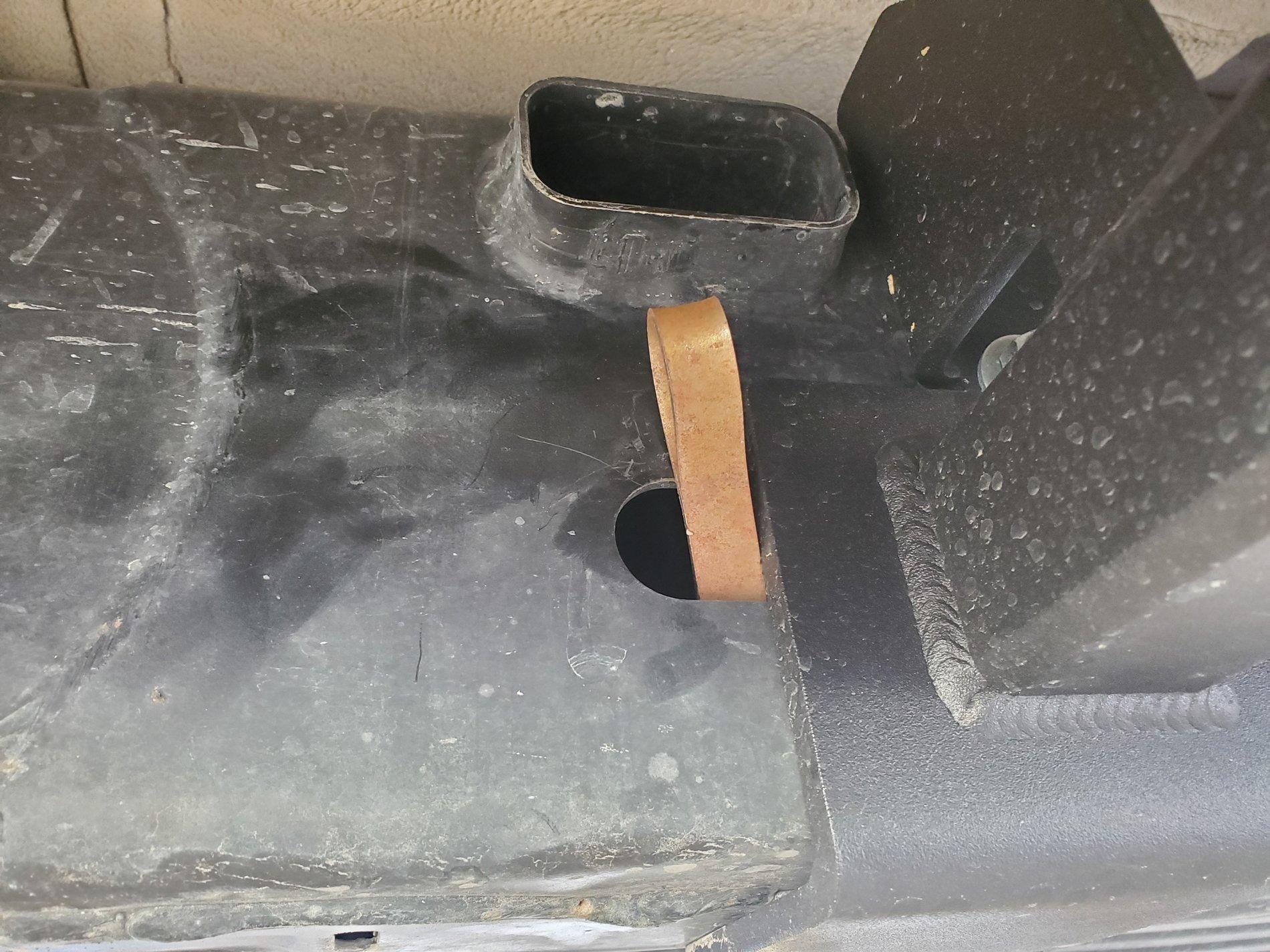

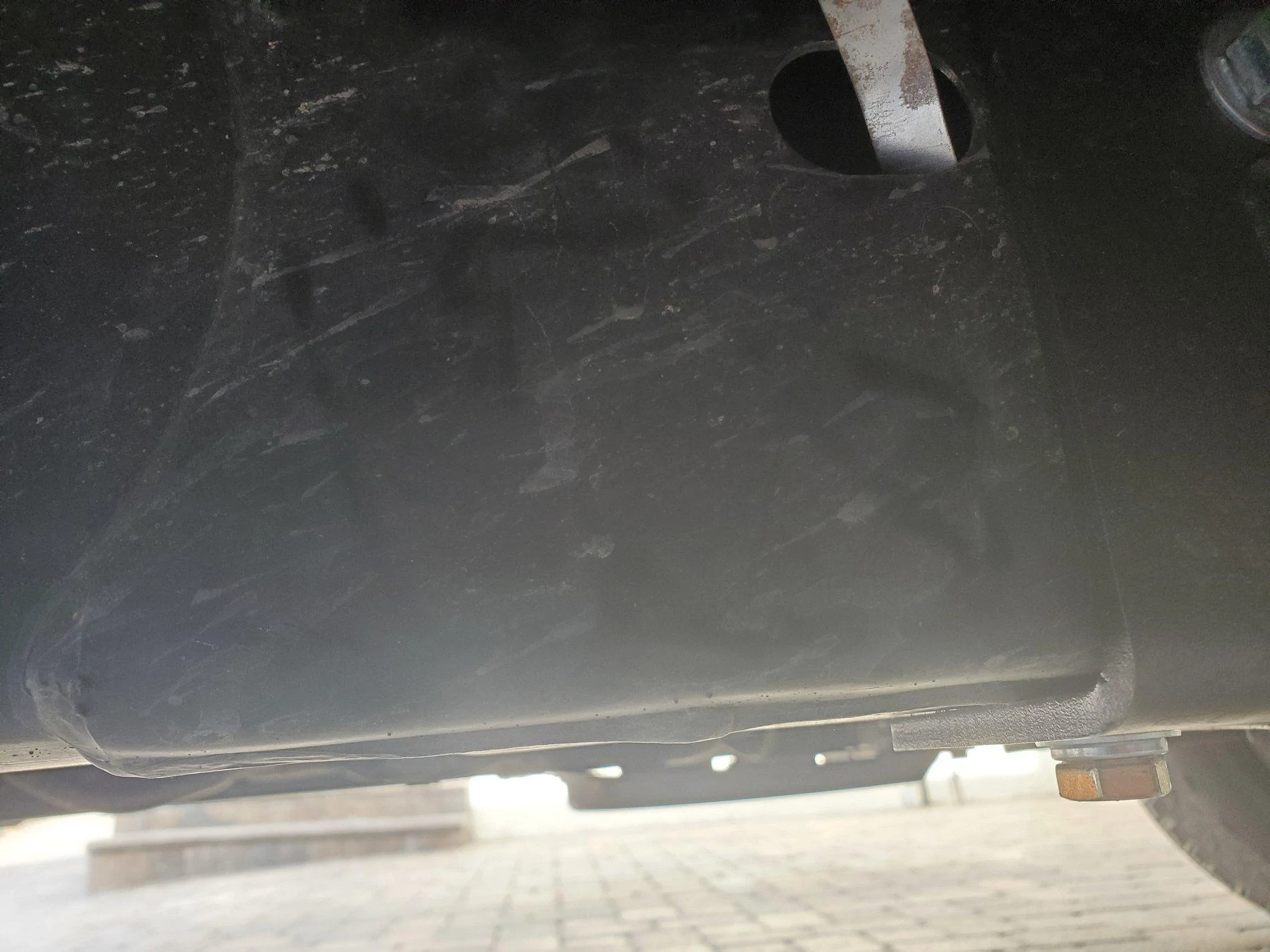

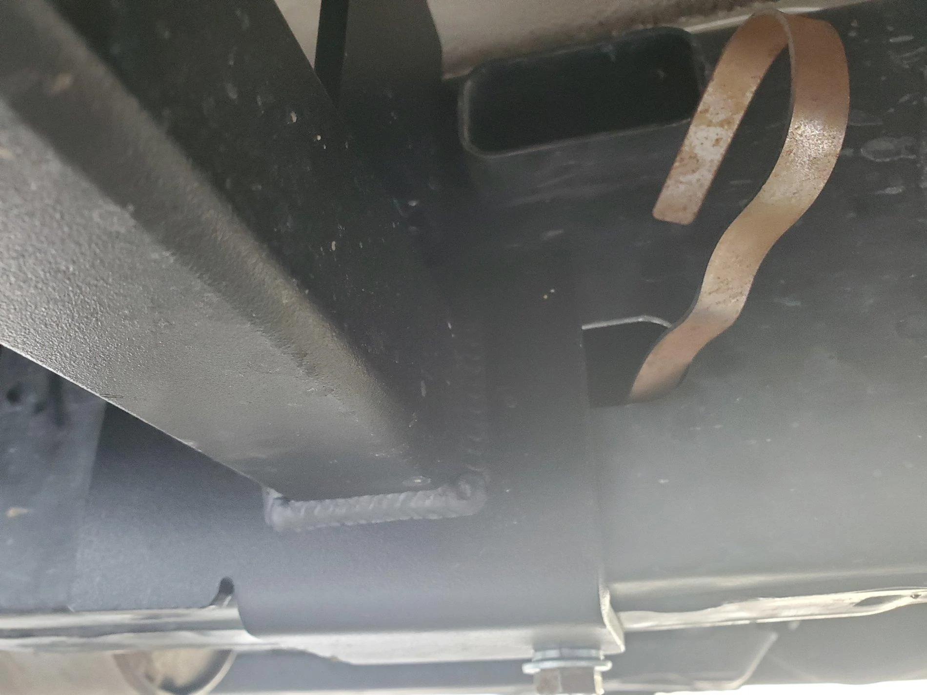

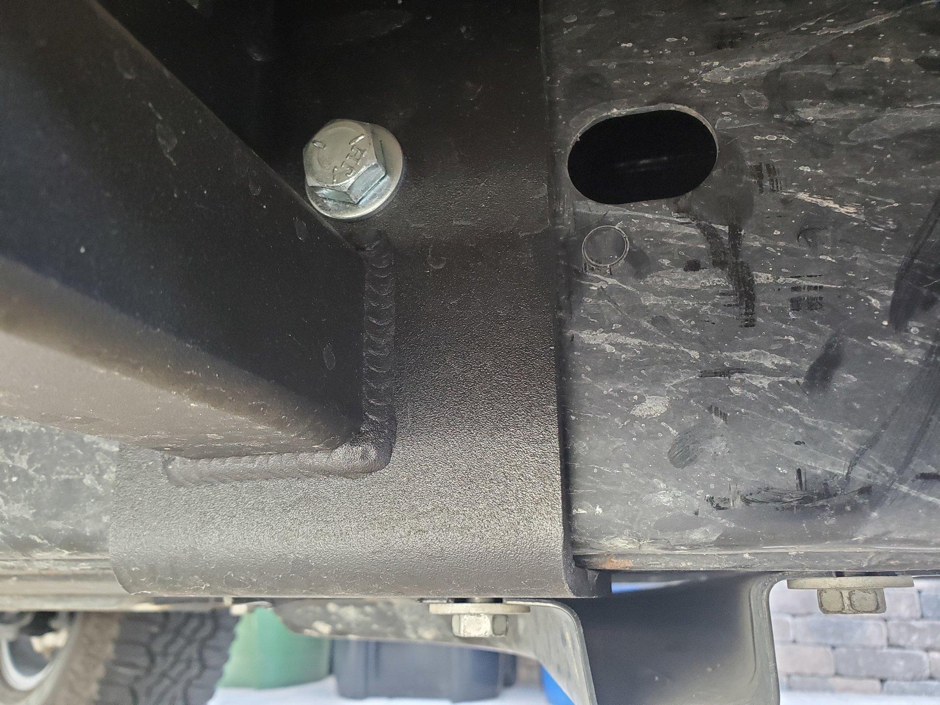

Here's a picture of each mounting point as viewed from outside of the car so you can get an idea of how to line it all up. The drivers is a bit easier to line up with the preexisting hole that is shared with the transfer case skid plate. Keep in mind it is the forward mount that is shared on the rock slider. In order of pictures: drivers front mount, drivers rear mount, passenger front mount, passenger rear mount

Thanks fr posting these.
Wow... those welds really look nice too. Were you pleased with the fit and finish of the set you received?

I am very pleased, the quality is fantastic. Instructions could be more detailed, but once you get started it really makes a lot of sense how it all goes together. Yes, the stick nuts metal will rust but the important parts are perfect. If you look back a page, you'll see the backing plate they include for each mount.

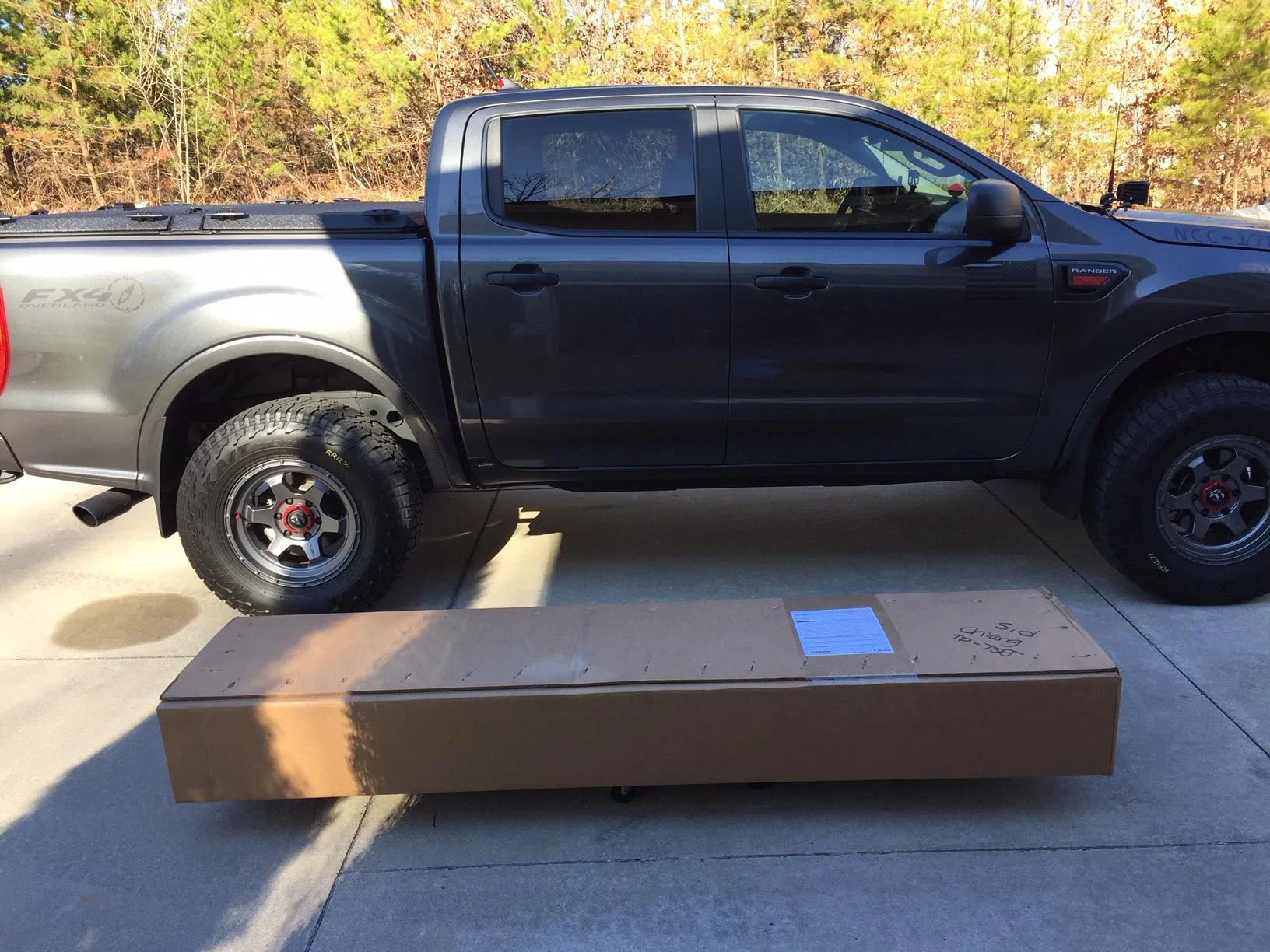

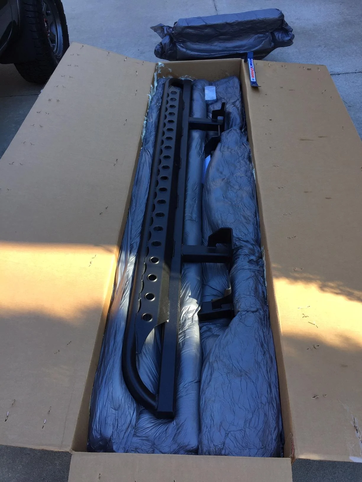

OOOOoooooyaaaaa:like:
Now to see about installing this by my self...wish I had some friends nearby but this is the way...if I can install the lift and exhaust alone then I'll figure this one out...:whew:
