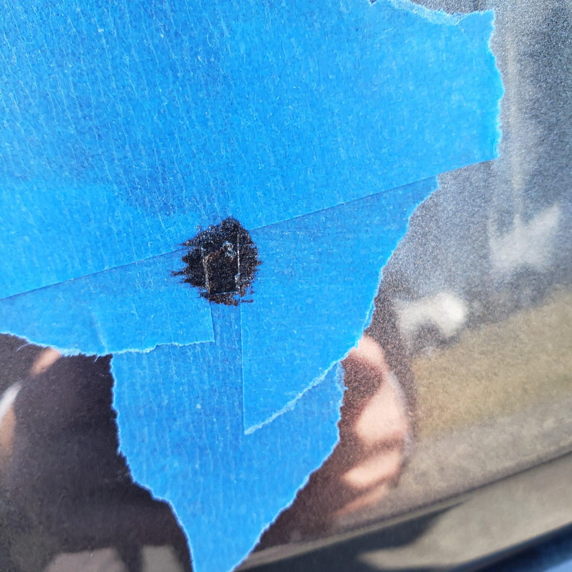

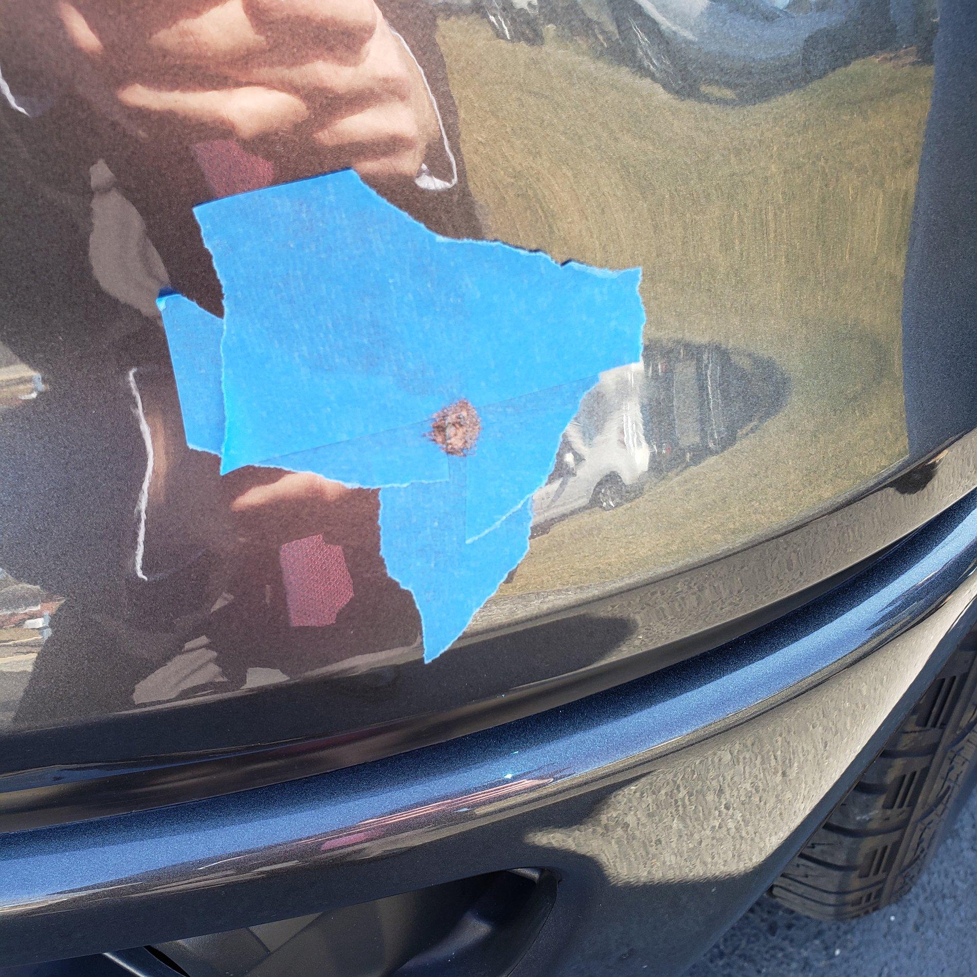

Alright so I got a little dilemma here. I had a nasty rock chip I tried sanding down, touching up and clearing over in magnetic. Well my luck, I sanded through the clearcoat into the paint in a 1'' circular area. Any ideas to blend in/fix as best as possible? I got 2 coats of magnetic on the spot now. I've done quite a few touch ups and so far this is the only one I messed up big time. I'm afraid I'll have to get the area resprayed....:angry:

Would be nice to see spot but if its 1 inch in diameter I think you will need to spray it. Probably not what you want to hear though. Bret
I'll try to get a picture up, I'm currently at work mulling over my screw up. My neighbor happens to work at a body shop so I might try to get him to look at it/fix. I'm figuring if I can't blend in the touch up, respraying is my only hope.

I know you really can't tell in the picture but I took the tape off and it looks surprisingly really good. I still have to add another 2 coats to give it 5 and then smooth out and add some clear. So far fingers crossed.
