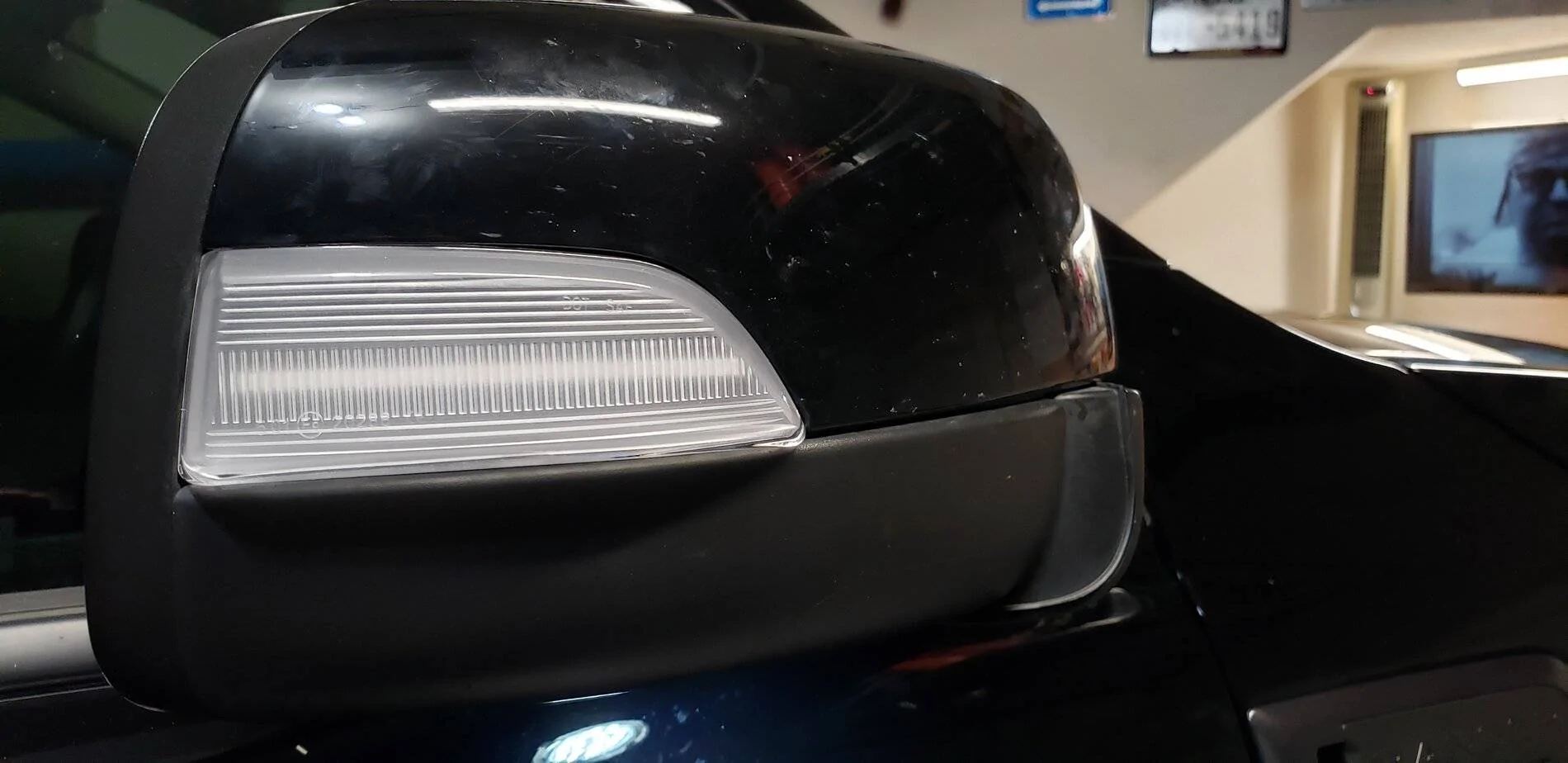

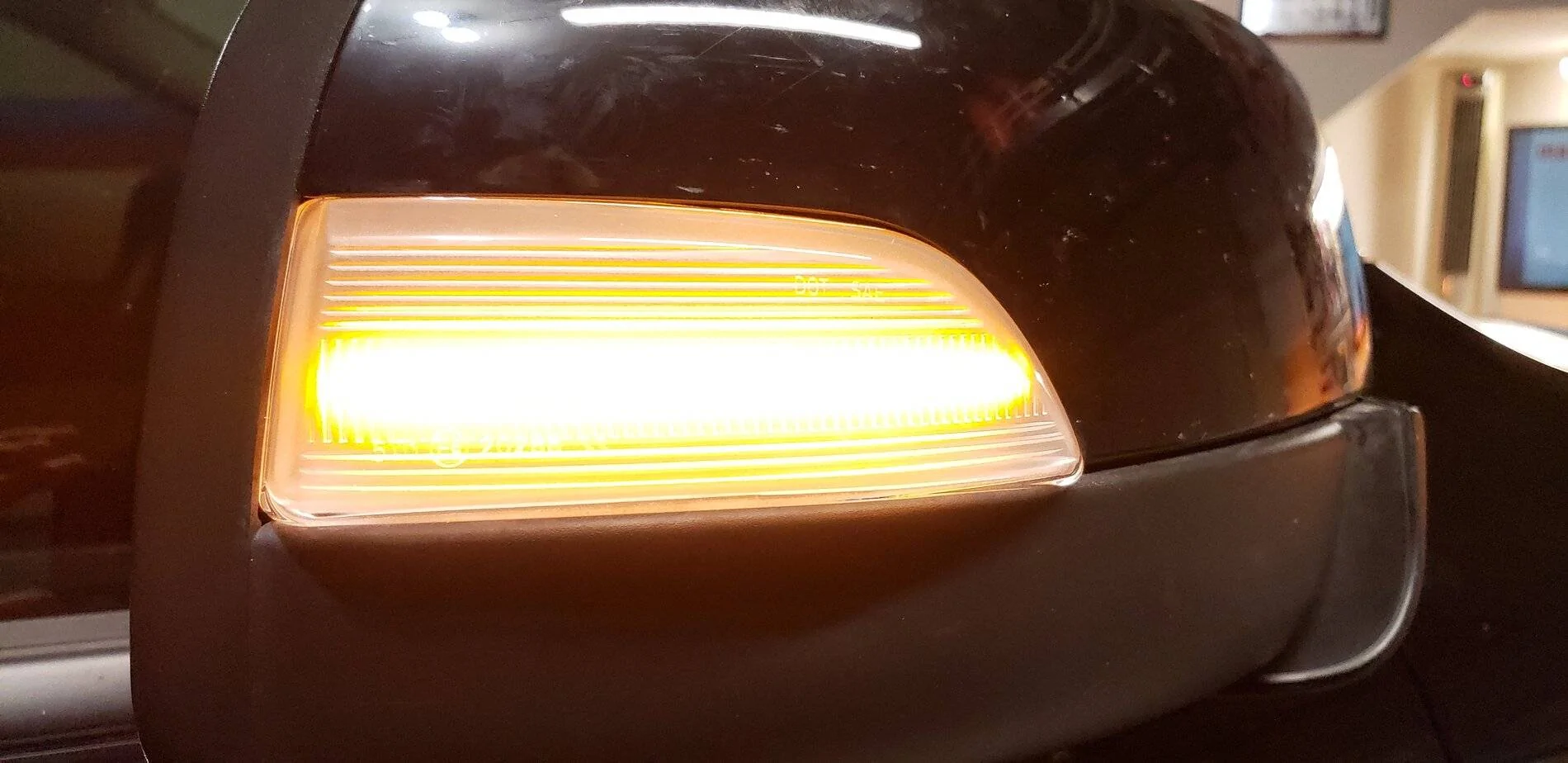

I just installed the clear sequential turns. I like them.

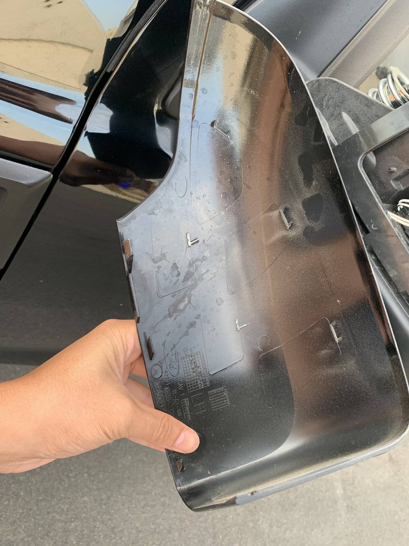

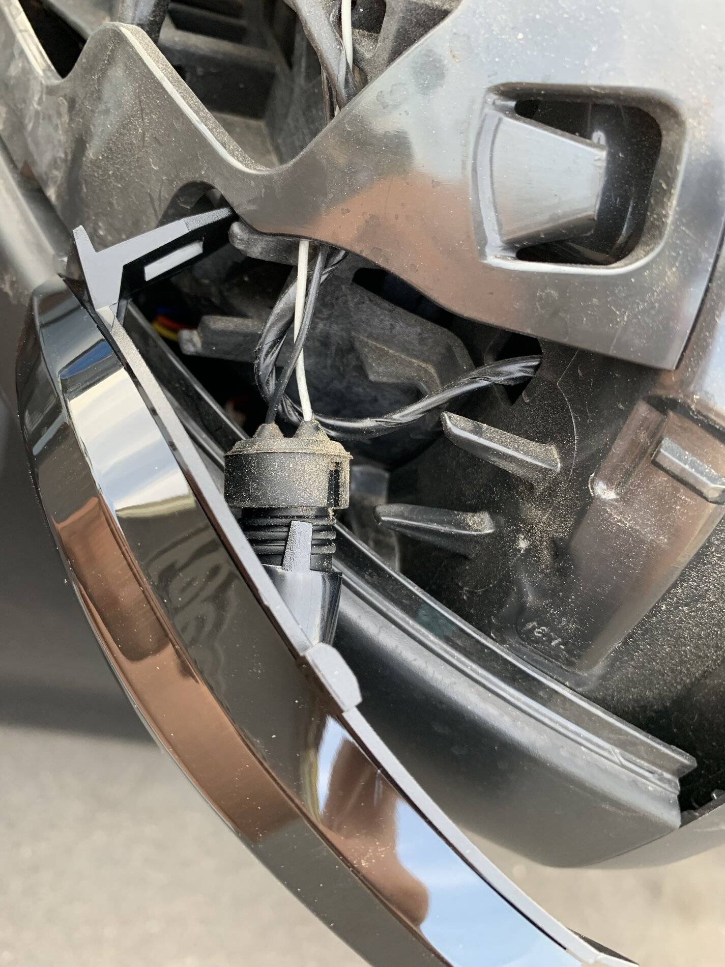

Luckily i've taken apart dozens of these mirrors:
Use a spudger instead of a screw driver and you shouldnt damage the skullcap. The second time i break out the screw driver in the video it was not needed (I thought the bottom clips might have been engaged still), you just have to pull at the correct angle, gently wiggle it a bit.

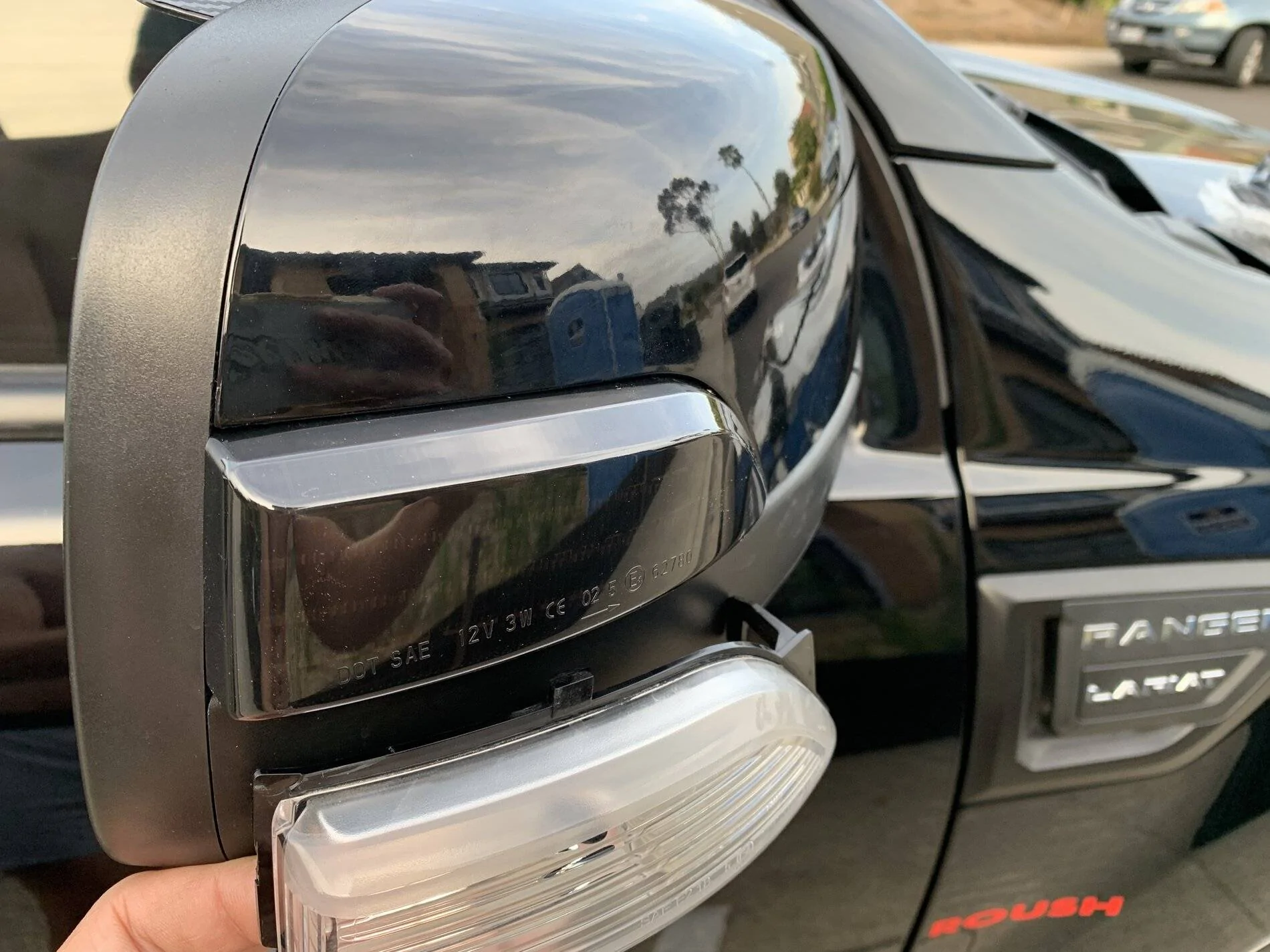

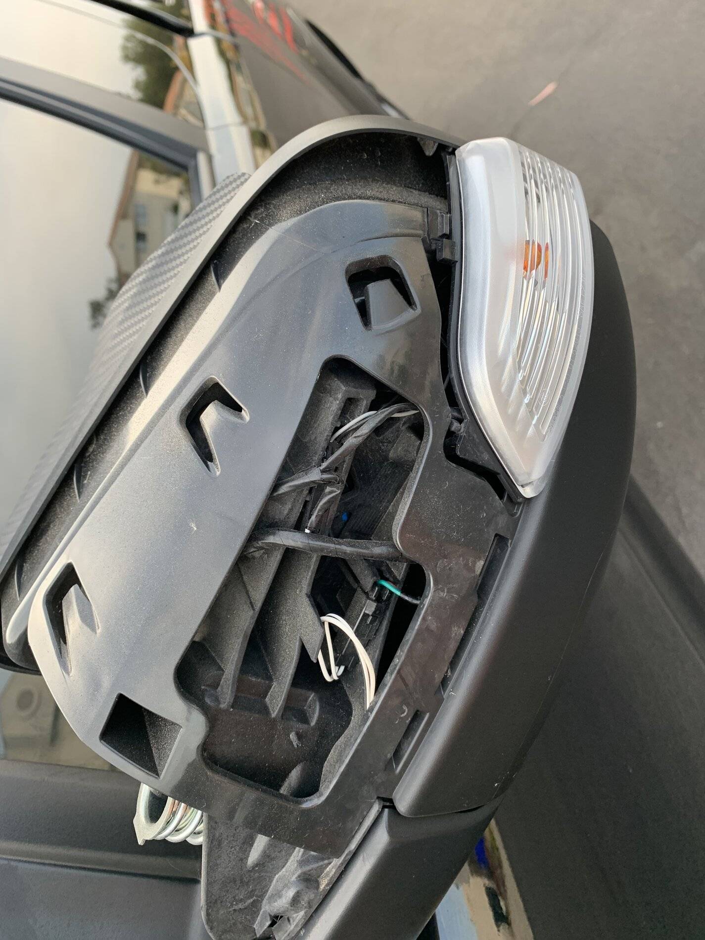

Super easy install. No tools needed, 10 mins for both sides. Skull cap takes a little wiggle and careful force to take it out. Straight forward and out for initial pull then wiggle a bit and a little more force and pop it comes out. Then you disconnect the bulb in there, plug yours in, clip it back in, pop skull cap back on. Here’s some pictures for understanding some of what I am saying.

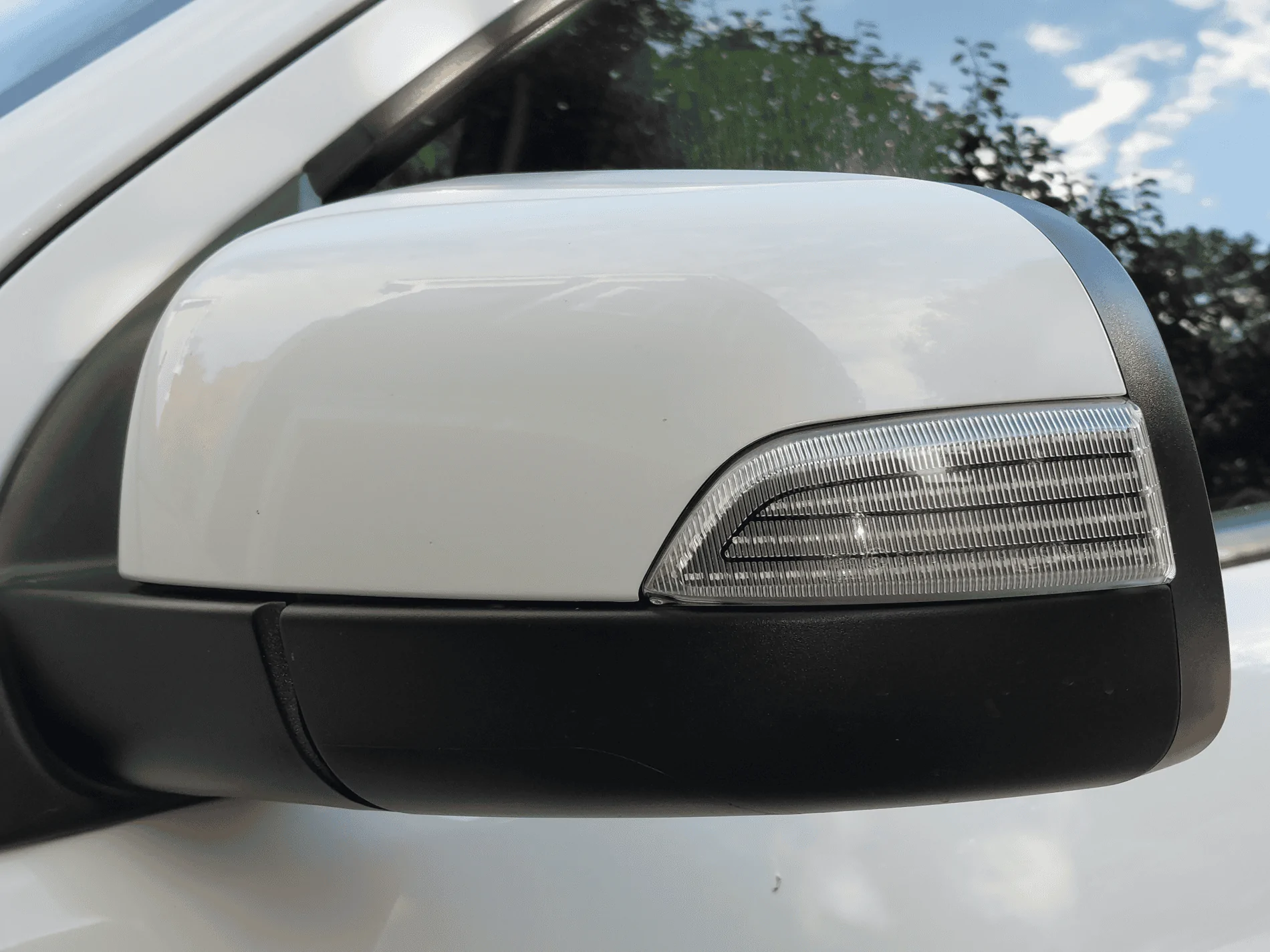

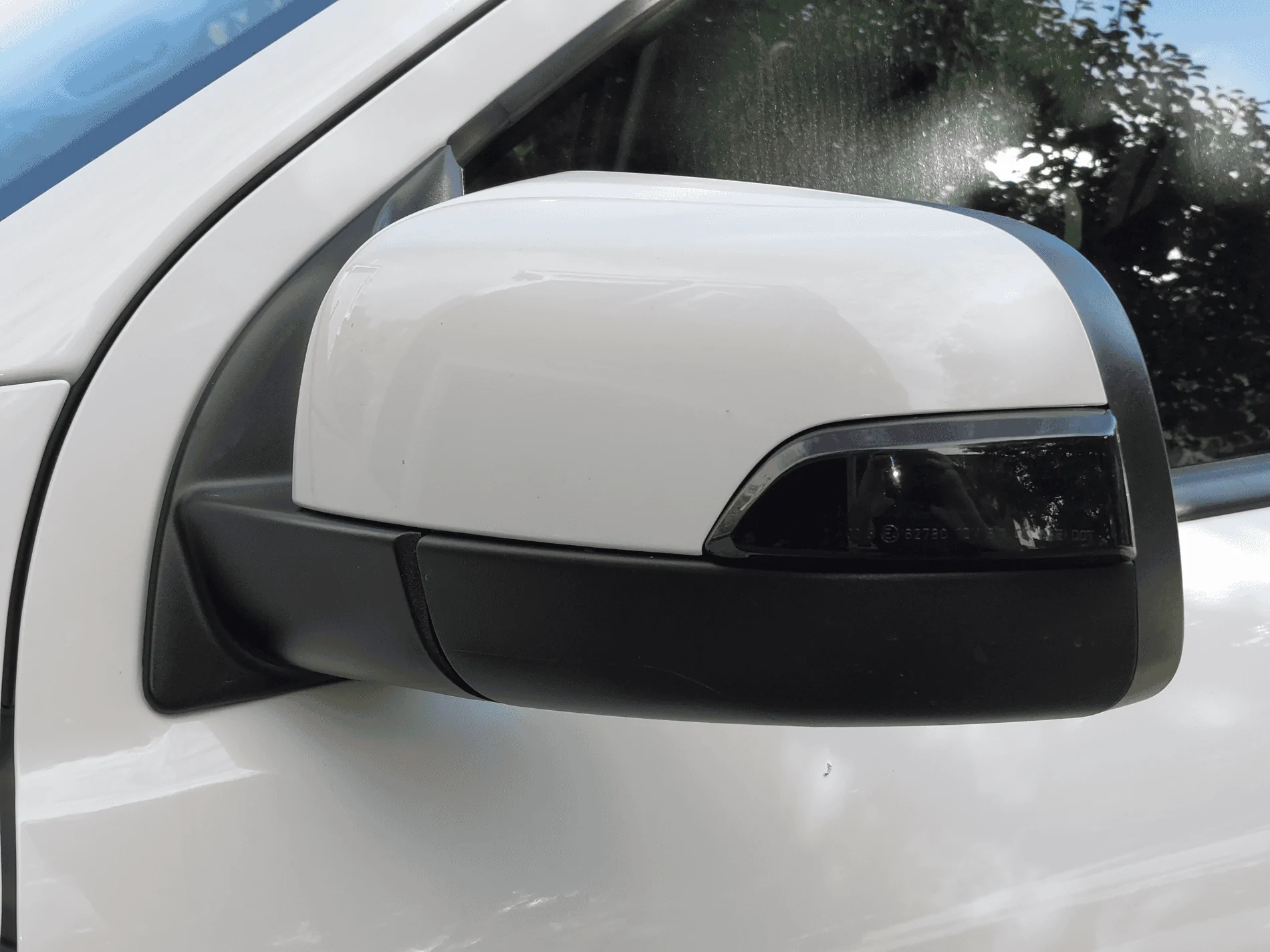

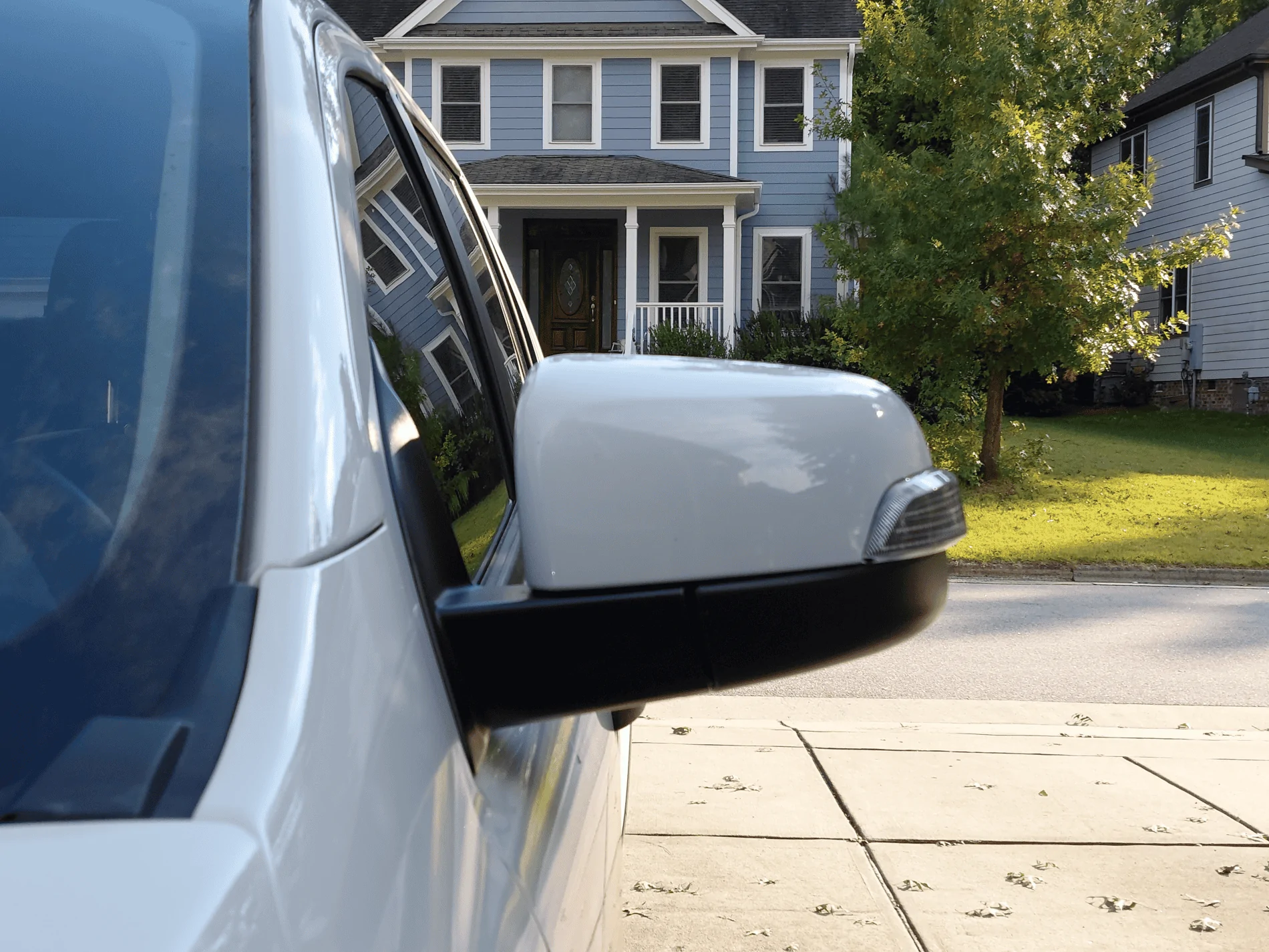

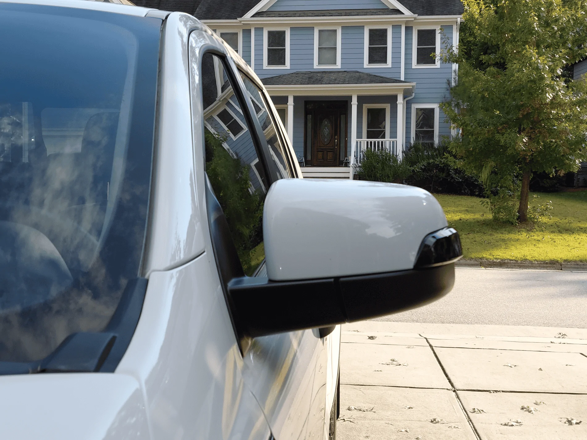

Well I decide to replace my Smoked out Seq turns with clear to better match the white skull cap.
Went with Amazon again
Smoked and Clear comparison pictures. IMHO (and only one that matters - My Truck!) clear looks much better with white! Smoked would be perfect for Black or Magnetic trucks. Other colors - your call!
