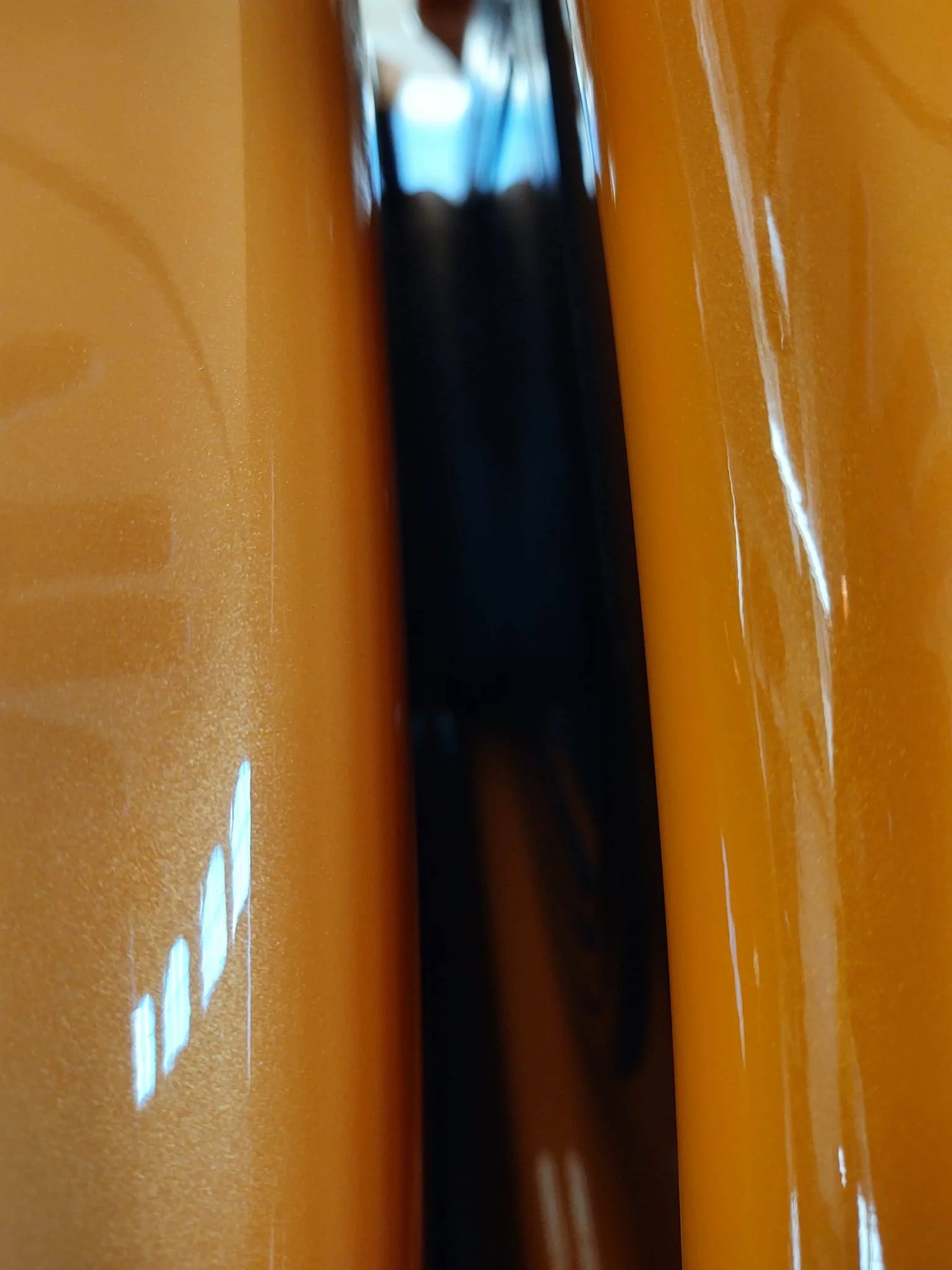

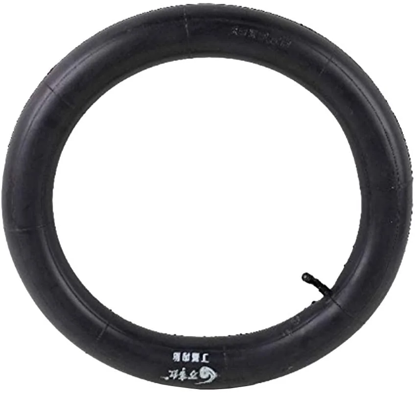

If you need a rubber "seal" between your rear truck cab window and a canopy window, this inner tube works!!! Blow it up slightly, work it from inside the cab between the truck and canopy (through the window), turn to where you want the valve stem and then inflate to desired stiffness. Be careful not to overinflate and perhaps crack a window. It is the perfect size. I have not water tested it yet. The ready made clear "boots", both sizes are too large for the Ranger.

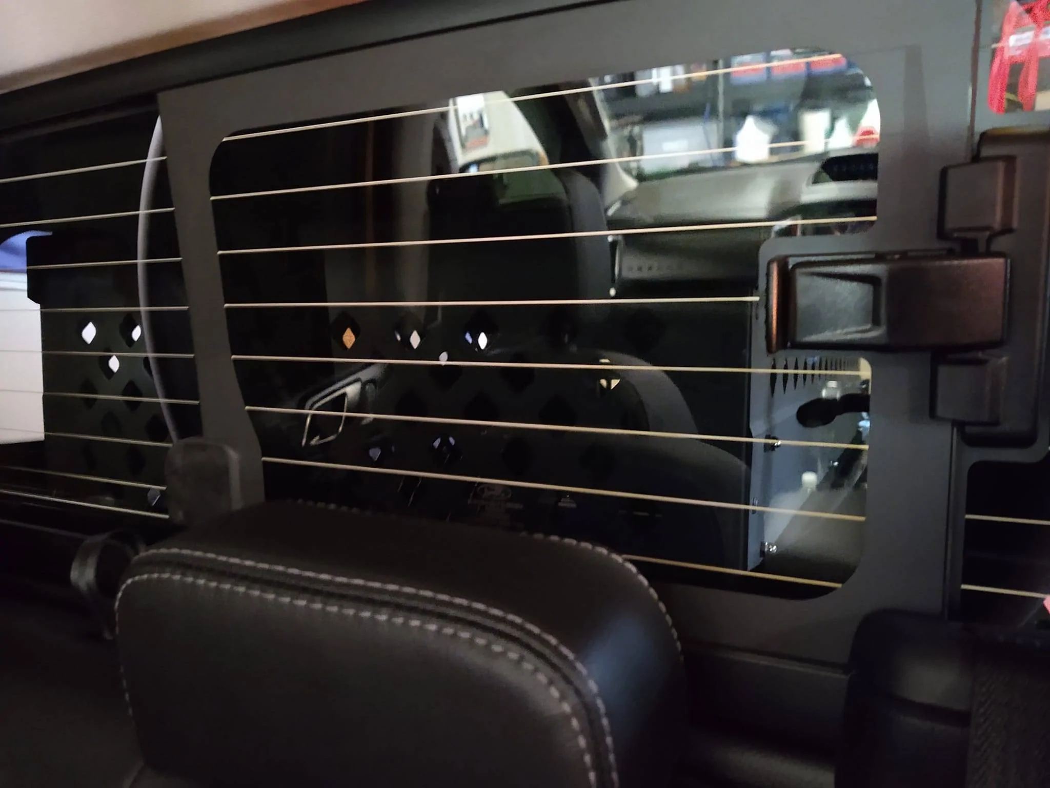

Difficult to see the tube "boot"....if you look close you can see it. Just an idea that it is not intrusive.
