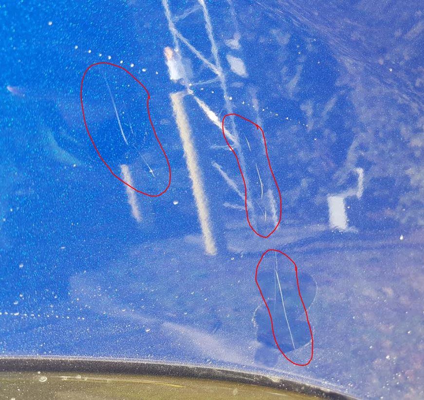

Two days after driving the truck off the lot and someone already scratched it. It seems to be a medium/shallow scratch. Anyone have any recommendations for repair products? I am guessing I will need to clean, sand, polish and buff the affected area with some sort of product or kit. In the past I have had good luck with Meguiar's for other tasks.

If your fingernail catches on the scratch, you're kind of screwed.

Ugh, that doesn't sound good. The scratches shown in the picture BARELY catch the very edge of my fingernail but I found two others that seem to be deeper. Strange thing is that the deeper ones are not as visible and definitely didn't make it to the primer.
I think I am going to try Meguiar's ultimate compound and see how it goes. Hopefully it is enough of an improvement, this is a truck after all and I don't expect perfection.

I've had some pretty impressive results from Meguiars Scratch X 2.0

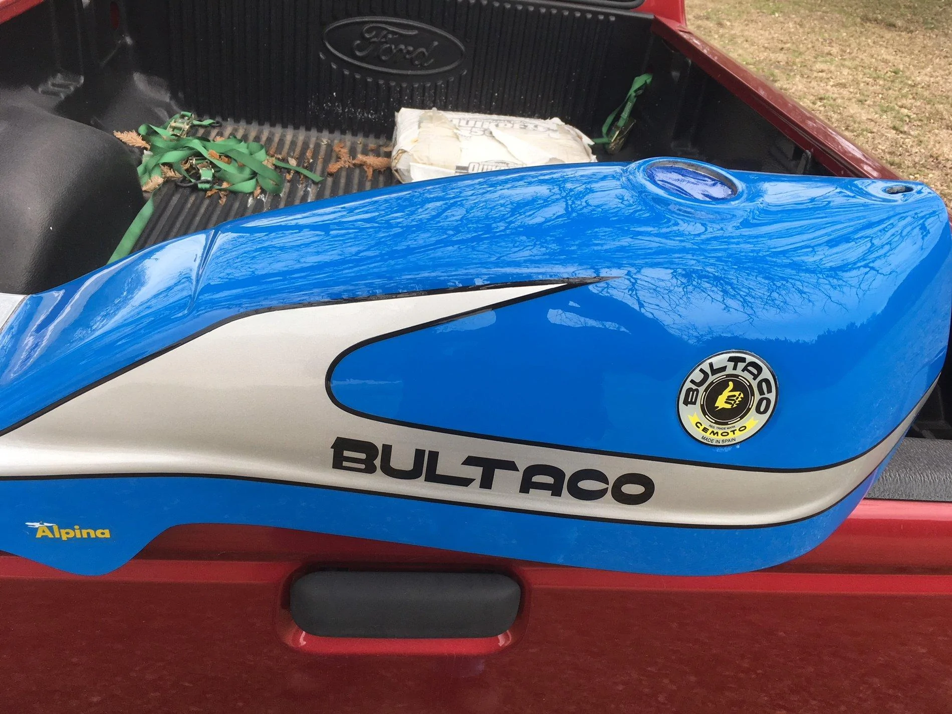

I paint and repair some vintage motorcycle tanks and that's an easy fix. Try by hand with a VERY mild compound and don't break thru the clear. It's an easy fix........

Nice work on the tank! I have a friend who races flat track in the vintage class, has an old TT500 that he works on. Lots of work getting the paint right.
Do you mean a polishing compound? Pardon my ignorance, but I'm guessing the procedure is clean, lightly polish with polishing compound, then apply a wax over the polished area?

Look for something that says removes 1500 grit or finer scratches. I mainly use 3m. No wax until you are satisfied with the finish.

I went ahead and tried the ultimate compound and wax, they did a fantastic job! I can still see the biggest scratch if I really look for it but practically it is fine.

wet sanding will eliminate those clear coat scratches....First time takes balls of steel lol...but it works. You tube vids everywhere..Orbital buffer is your friend. good luck.
