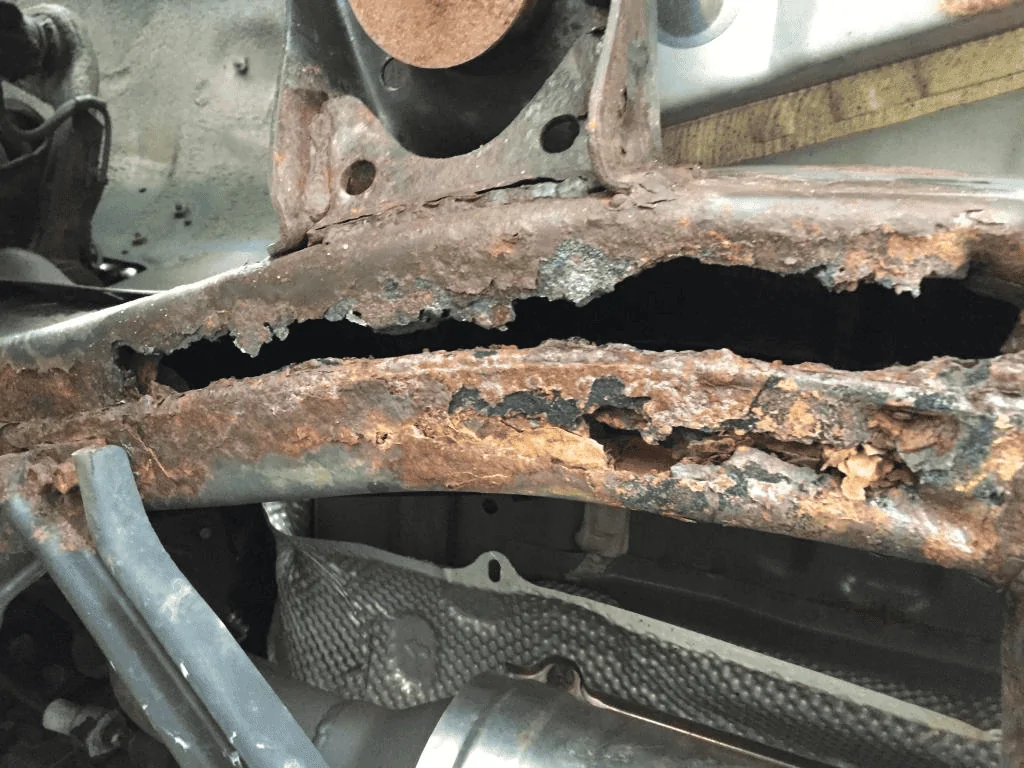

nothin to worry bout. when the rust is a problem you will know. if you can read reach or pass a beer through it then be concerned. besides more rust is better gas mileage. its not like toyota frame rust, that is the most advanced rust ive ever seen.
Engineered into it. That makes the frame flex better for off-roading...
