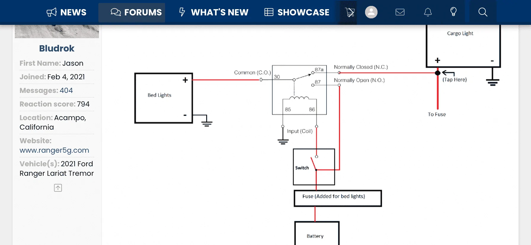

I did run a relay to mine, because I also have a switch that turns on the bed lights.
I believe the schematic was posted by Bludrok.

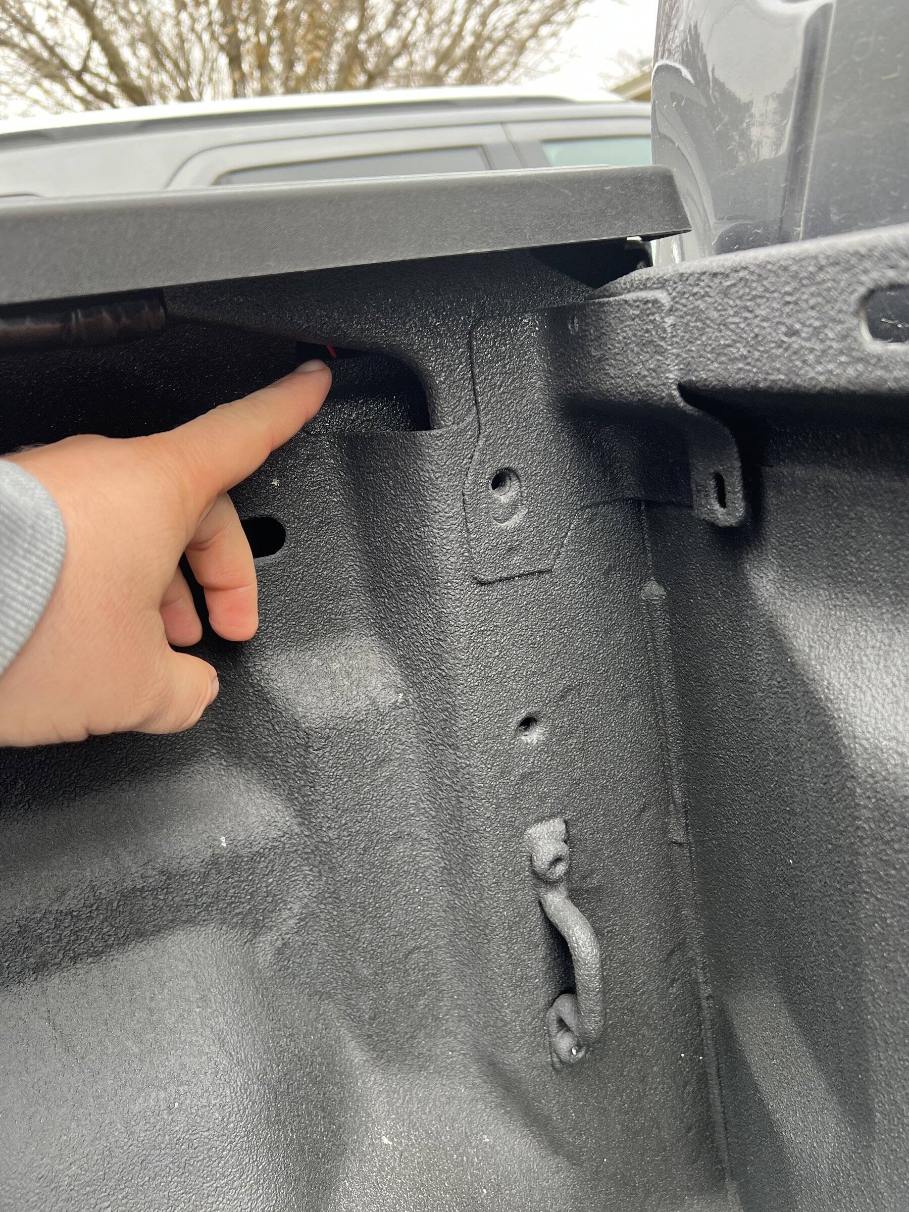

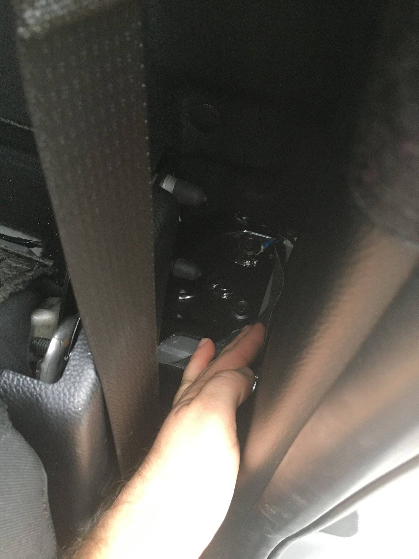

If you’re referring to the running board lights, if you pull the door floor trim on driver side back seat there’s a white wire with green stripe, that’s the cargo light wire. I drilled a small hole in this area to run the LED wires into the cab, tie into the white/green wire, routed the + and - under the trim, behind the rear seats to the other side, drilled a hole to run the LED wires on passenger side in. I grounded it on one of the rear bolts holding the back seat in. I used heat shrink butt connectors to tie everything together, rubber grommets in the holes I drilled and filled empty space in the grommets with clear silicone.
I ran the bed light wires down this hole:
out the bottom and into the same hole I used for the running board lights. Tied them in the same way.
Hopefully that makes some sense, if not I’ll try to get more detailed pictures of the whole setup. Too cold out right now. ?
