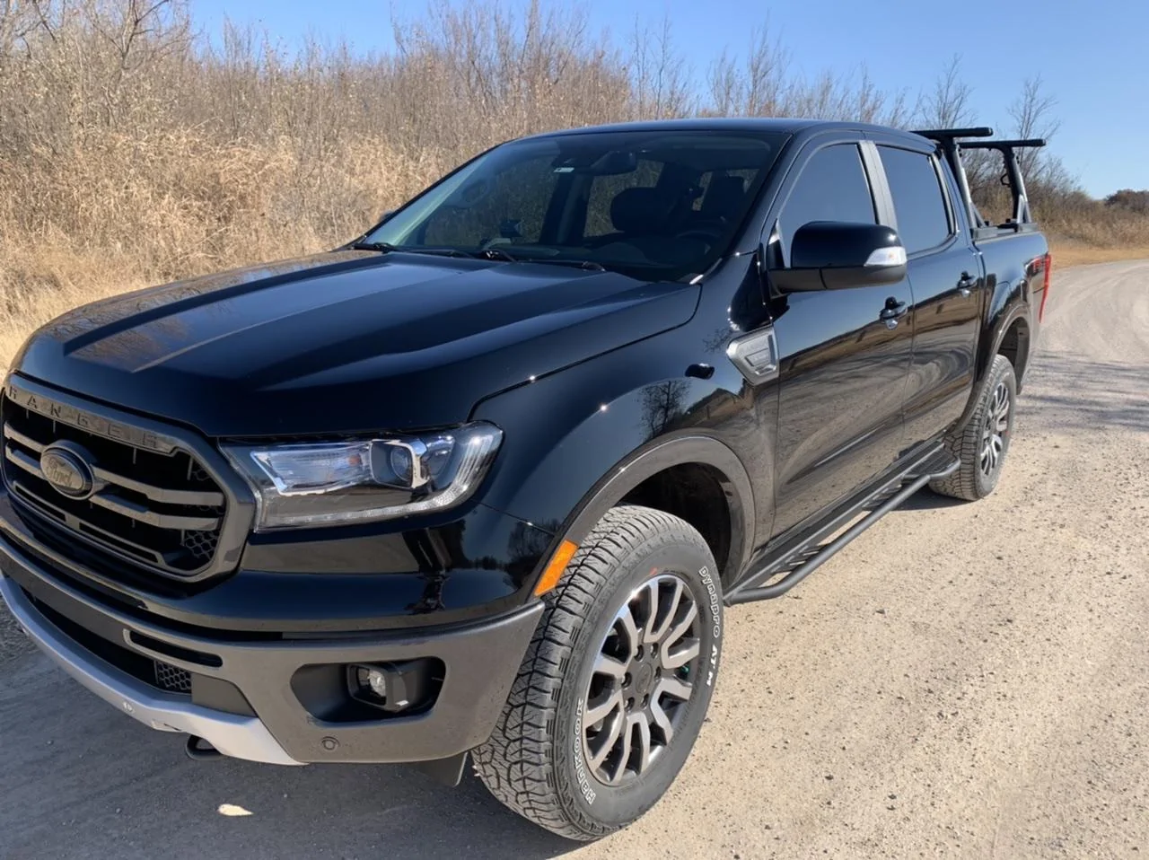

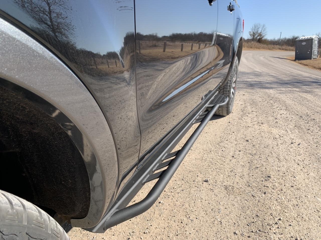

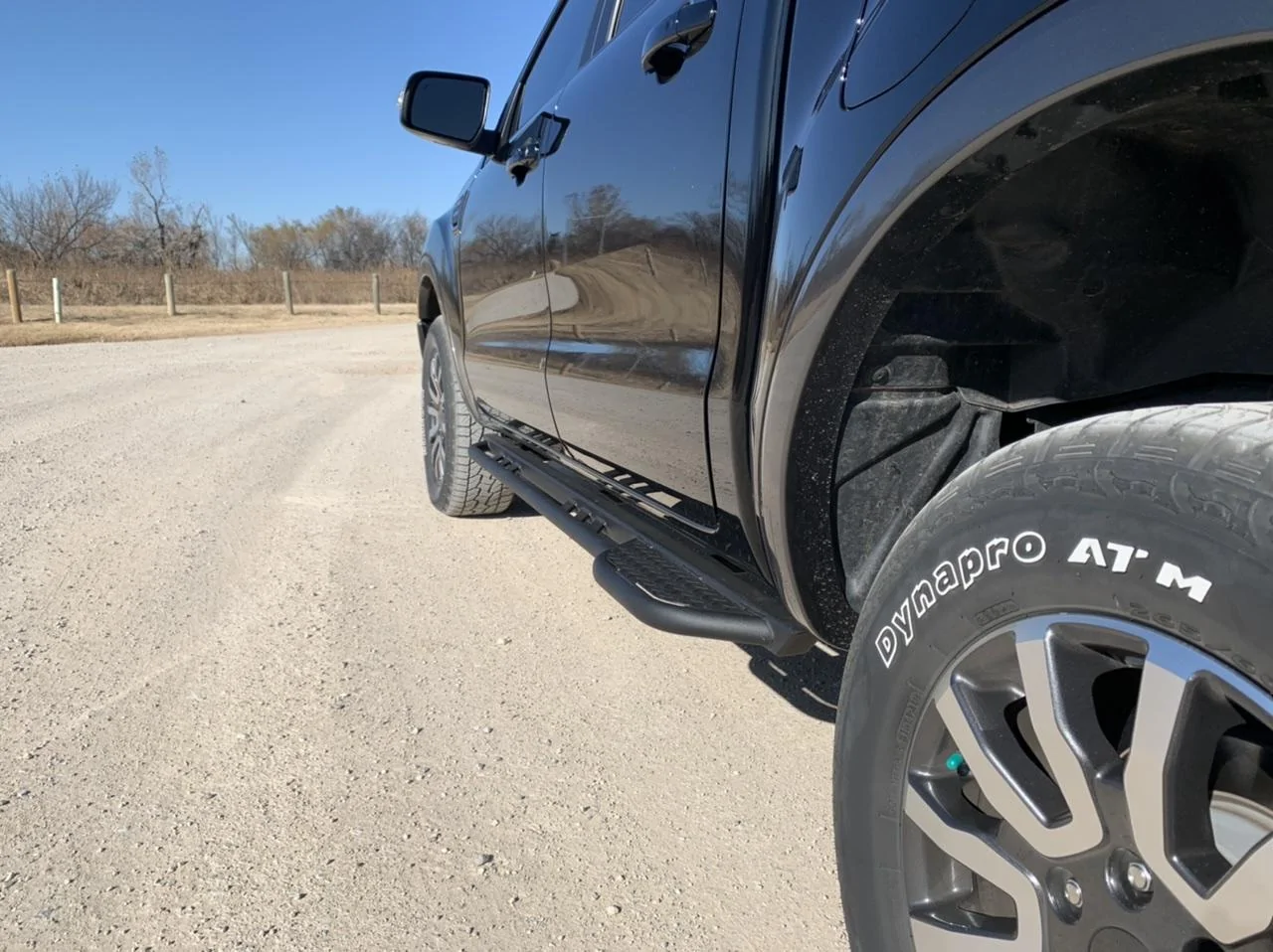

I’ve had a set for about a month and I finally installed them today. I’ll try to get more pictures tomorrow. I had their sliders on my previous Jeep Cherokee. These are definitely as heavy duty as the ones for the Jeep. Each one weighs about 50 pounds. They bolt directly to the frame and will support the weight of the truck if you get hung up on a rock or want to use them as a jack point.
I’ve ordered a few things from them before. They are a small shop and build to order. So it does take about 6-8 weeks to get your sliders. I’m sold on their quality and will look to them anytime I need sliders.

That looks great. Are they coated in bed liner or something else?

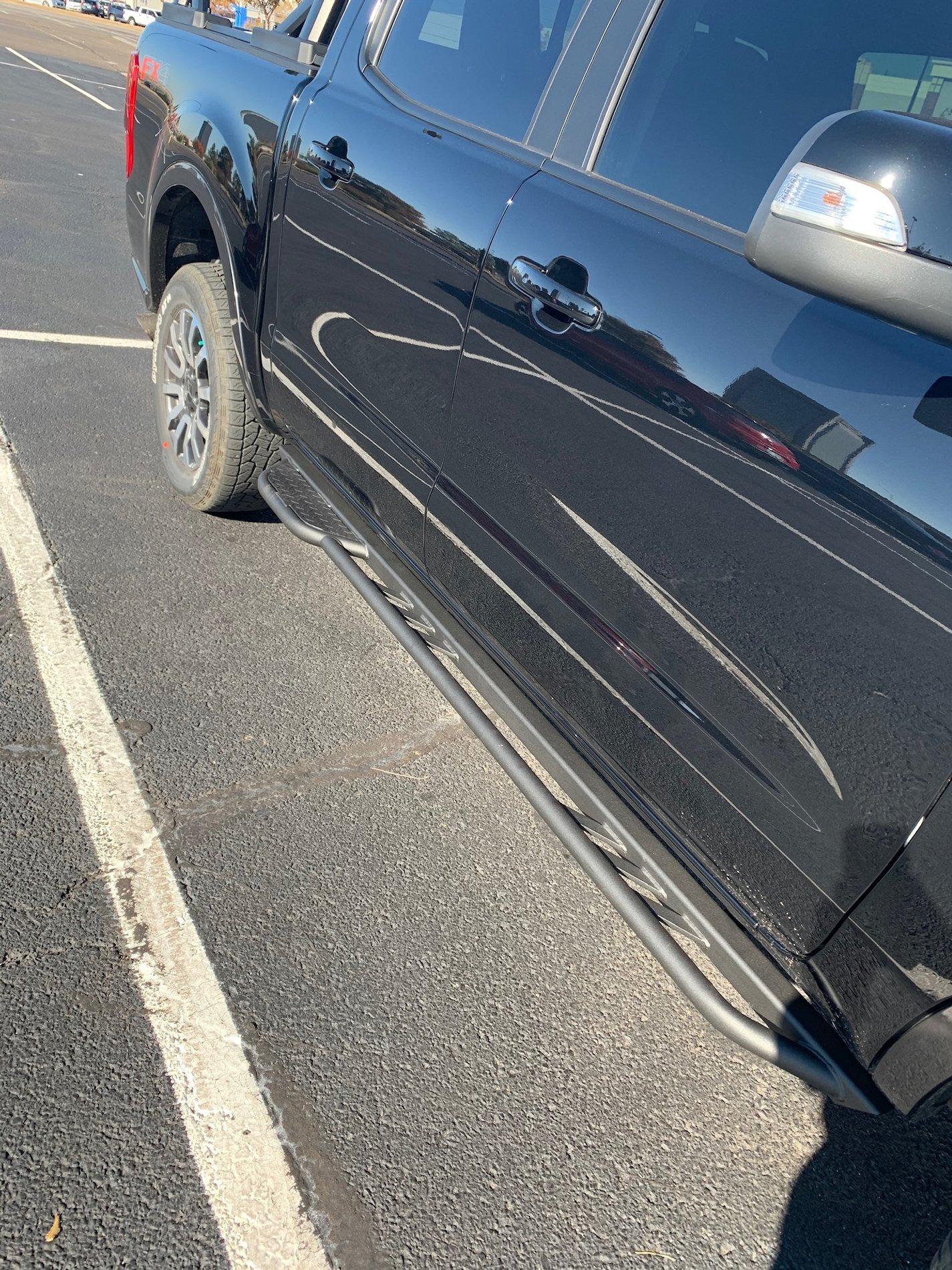

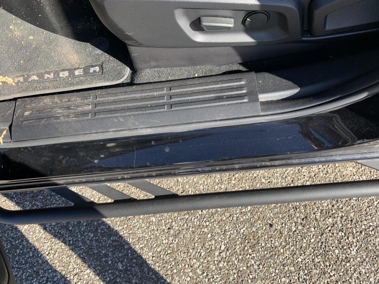

Here is a picture with the door open. You can use these as a step.
You do not use any factory holes to install these. You have to drill all of the holes. Their instructions give an explanation as to why. If I can find them I will post a picture of them.
I bought the ones with the kicker step in the back to help with tying kayaks to my rack. It may help .... I haven’t tried that yet. You can get the same sliders without the kicker step. I think they just call them supersliders and they are a little cheaper.

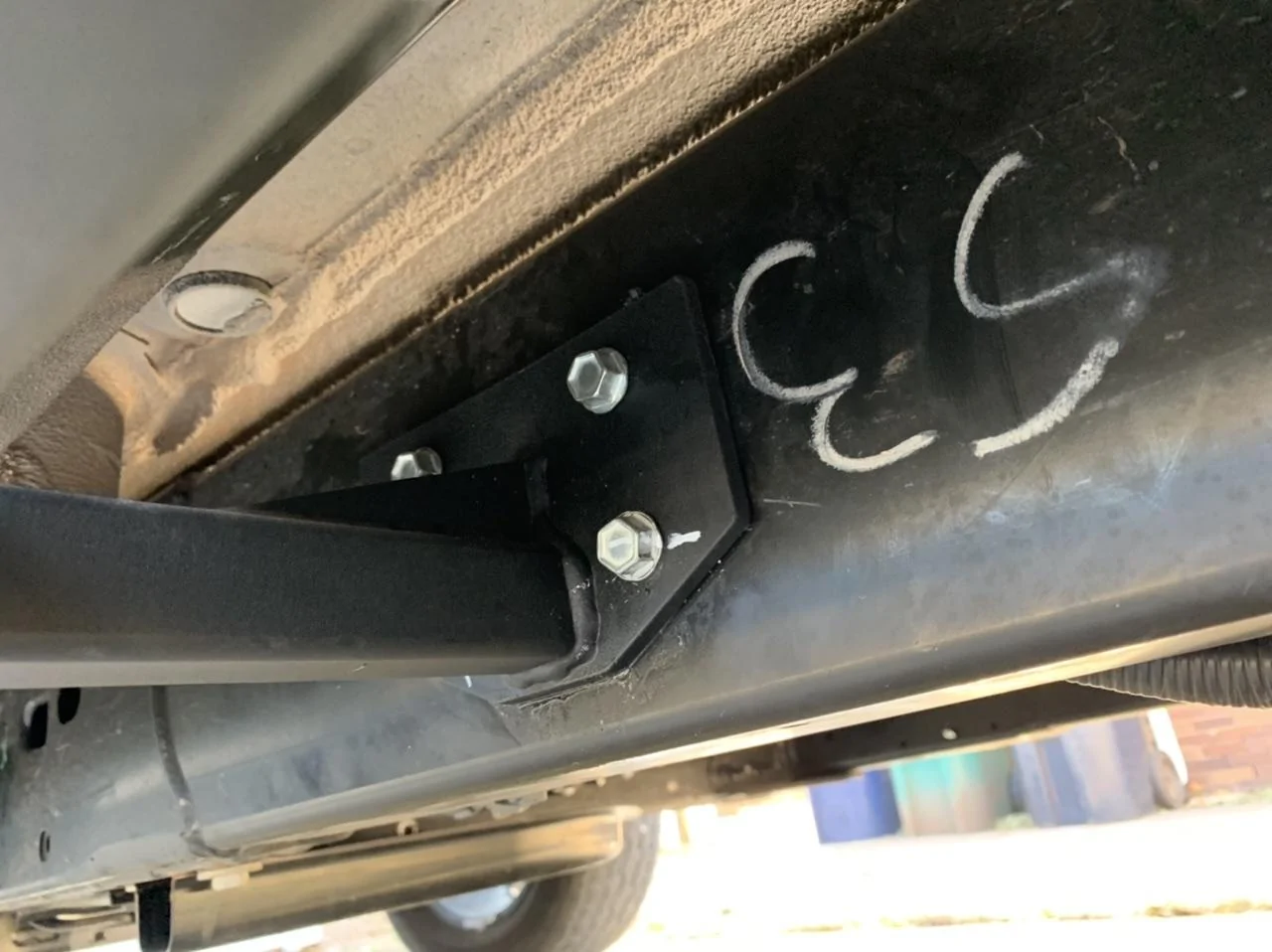

Just thinking out loud as I waffle between Shrockworks and RR sliders.
It looks like the RR attachment plate sits "within" the frame - not reaching to the top and/or bottom. I would be concerned that a fairly direct side bump (like sliding in ice/snow and hitting a post) could push those into the frame.. Shrockworks seem to span the whole frame, and would seem to handle this kind of situation better.
