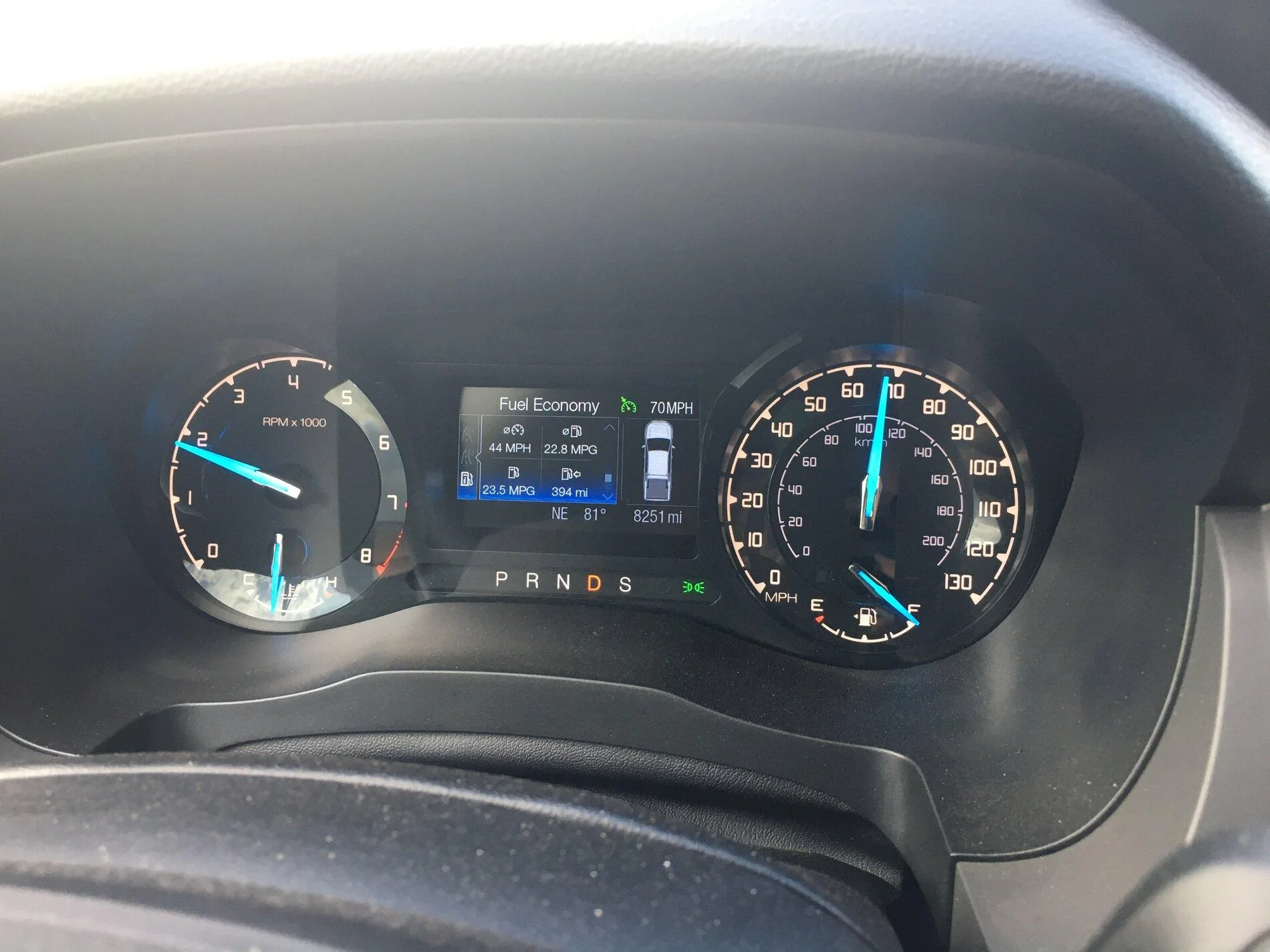

I did a 200 miler yesterday (one way) and returned today. Three observations. #1: My Ranger does NOT like 25-35 MPH crosswinds. It was all over the place. I shut down the Driver Assist cause it was driving it crazy. #2: My analog speedometer and my digital speed readout don't match. The digital reads 3-4 MPH faster than the speedometer dial. #3: I was getting "Speed Trap Ahead" alerts on the sound system. I assume they were generated by Android Auto but not sure. And I averaged 26.5 MPG. (by the trip computer)

Definitely interesting. I know my speedometer read faster than actual speed with stock tires, and after I went up 1” in diameter both are dead on accurate after testing with my phone GPS.

I've heard of it but never installed it, until reading this post. I haven't verified my speedometer with my phone gps yet. I did on my fusion an it read about 2 mph faster than I was actually going. I had the base car with the 16" wheels an wondered if it because they use the same speed calibration for all models, some have 17 an 18" wheels.

did anybody get back to you about the dial/digital discrepancy? mine also runs 2-3mph slower on the dial and i’m wondering which is accurate and why there might be a discrepancy in the first place?
i was assuming the dial is an analog interpretation of the same input. i can’t imagine a truck with this much electronic gadgetry has a speedometer cable.

No Char. Still don't know why the discrepancy but I don't notice it anymore. I rarely drive the Ranger now. It hasn't been on the road in over a month.

I brought my gps along this weekend. On a straightaway with the cruise control on 55mph and the digital speedo saying 55 and the gps saying 55.5mph (+/- ~0.2mph) the dash gauge dial comes up around 52-53mph.
So I’m convinced the dial is the outlier as everything else matches up. It annoys me a little there is a discrepancy but ultimately doesn’t matter. I’m happier now knowing which to trust (digital, not dial).

I always wondered if manufacturers purposely ran the calibrations low to slow people down. I have no inside info on this, maybe Phil has some ?

I have read that to comply with USA laws, the actual speed of the car cannot be faster than the indicated speed on the gauge. To ensure compliance, the actual speed will always be a bit less than indicated.
An interesting aside - German engineering is a source of national pride, and the speedometers on my BMWs indicate just about exactly 3 MPH faster than actual speed with the OE tires. When you dig into the software configuration for the car (similar to Forscan) there is an option to disable the 3 MPH discrepancy, but it will not work for USA-market cars.

My speedo is about 1 mph off per 10mph in speed. No idea why 33" tires put it so far off.
At 77mph per GPS (which was cross-check in a different vehicle as +1/-1 accuracy) my Ranger is showing 70mph.
I have appointment Friday for shudder TSB at cold start going to tell them to re-calibrate speedo since THEY are the ones who installed the tires before I came along and bought the truck.
