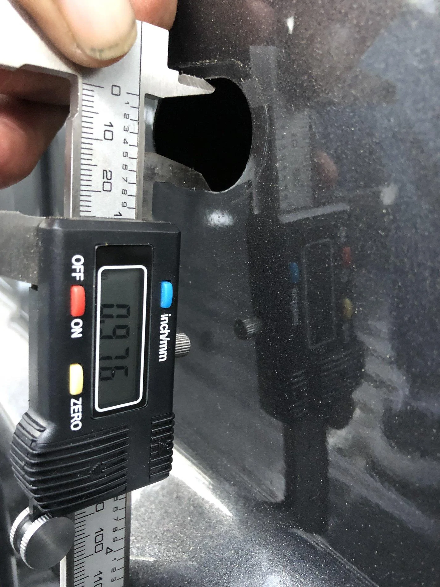

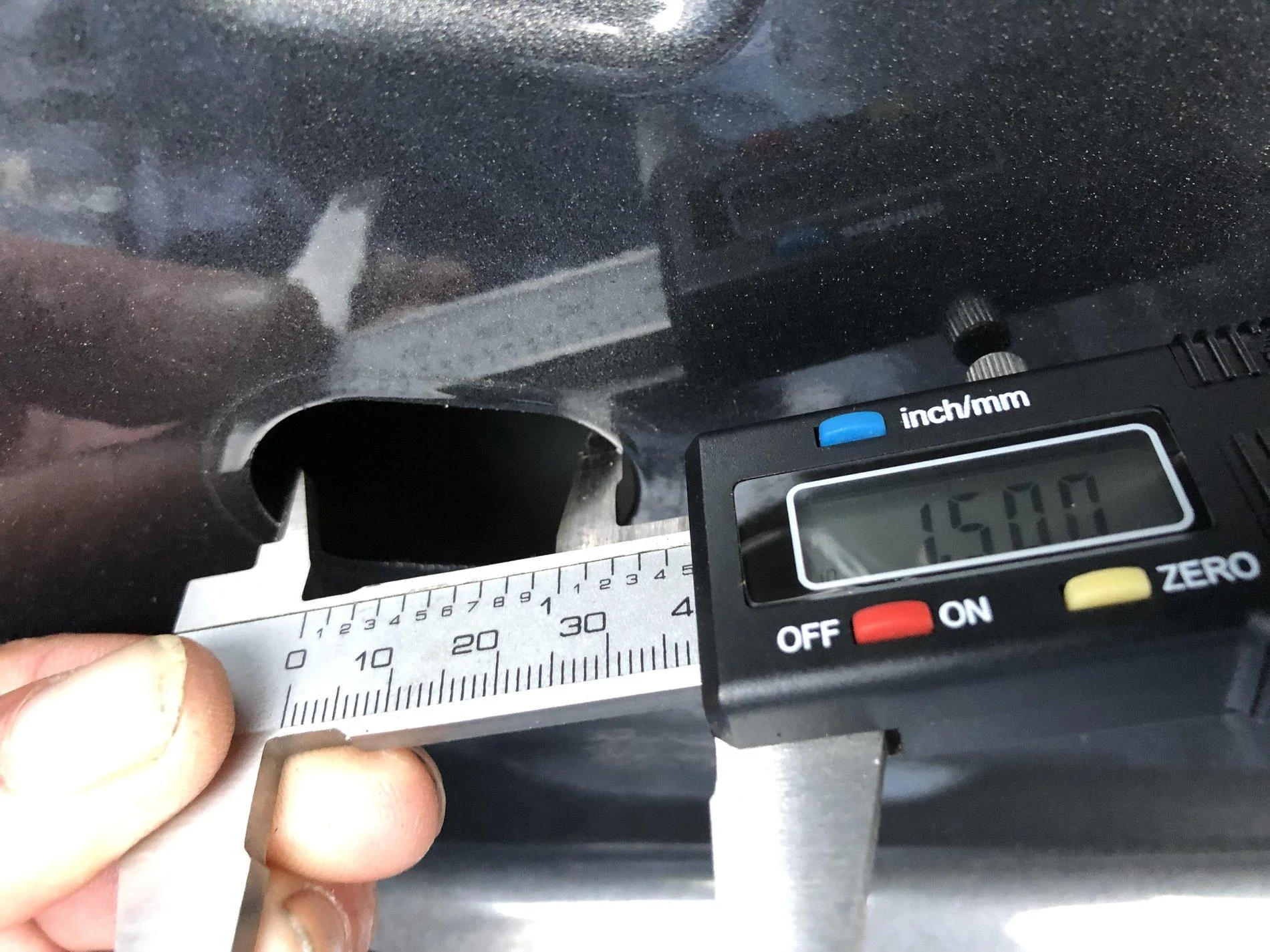

Here ya go. Dont know if the upper indent in the sheet metal was needed as well.
Thanks I emailed these to the staff at Bull Rings. Are you able to measure how deep the hole is?

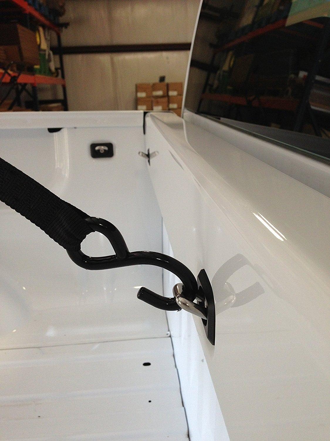

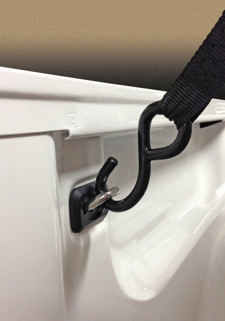

I checked their website too. Mostly stake pocket tie downs, but ALSO side mounted options for Chevy and GMC, ‘Cuz they have an odd shaped stake pocket intended as a hand-hold for climbing into the bed...
Exactly this is what I was thinking about:
air-for-Side-wall-and-Front-wall-of-2007-2017-Silverado-Sierra-15-17-ColoradoCanyon-B01HOXWV6G-2.jpg
2007-2017-Silverado-Sierra-2015-2017-Colorado-Canyon-1001-Bullet-Truck-Bed-Side-Wal-B00TOUP7OQ-4.jpg
The holes go all the way to the outside sheet metal. There is no reinforcement around them at all. Sent the pics to
Steve @Bullrings as well. He said the lack of support structure is an issue. Im thinking these openings were used during corrosion dip treatment then just plugged off with caps.

Looks like the answer is a resounding No.
I believe these are straight punch holes. They do not appear to have any reinforced edge no clamp no weld - no stamping.
I believe these would flare if given the force of impact or hard swerve/ spin. They would trumpet out and fail. Not going to recommend their use for cargo restraint.
