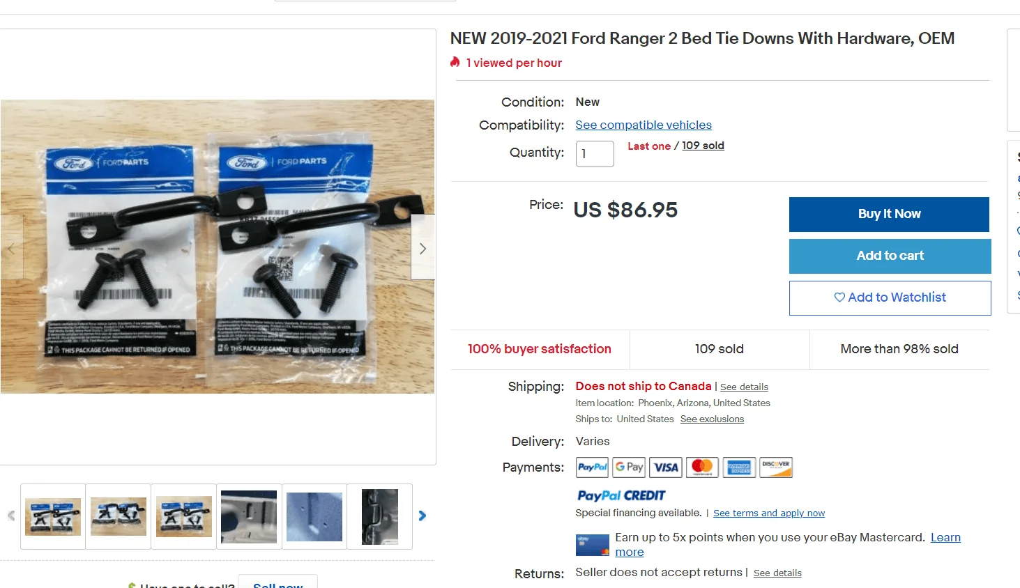

Alright - so Ford charges like $70 for replacement tie downs? For real?
Where can I get some replacements for the proper $7? Ive searched around and cant figure out exactly what will fit.

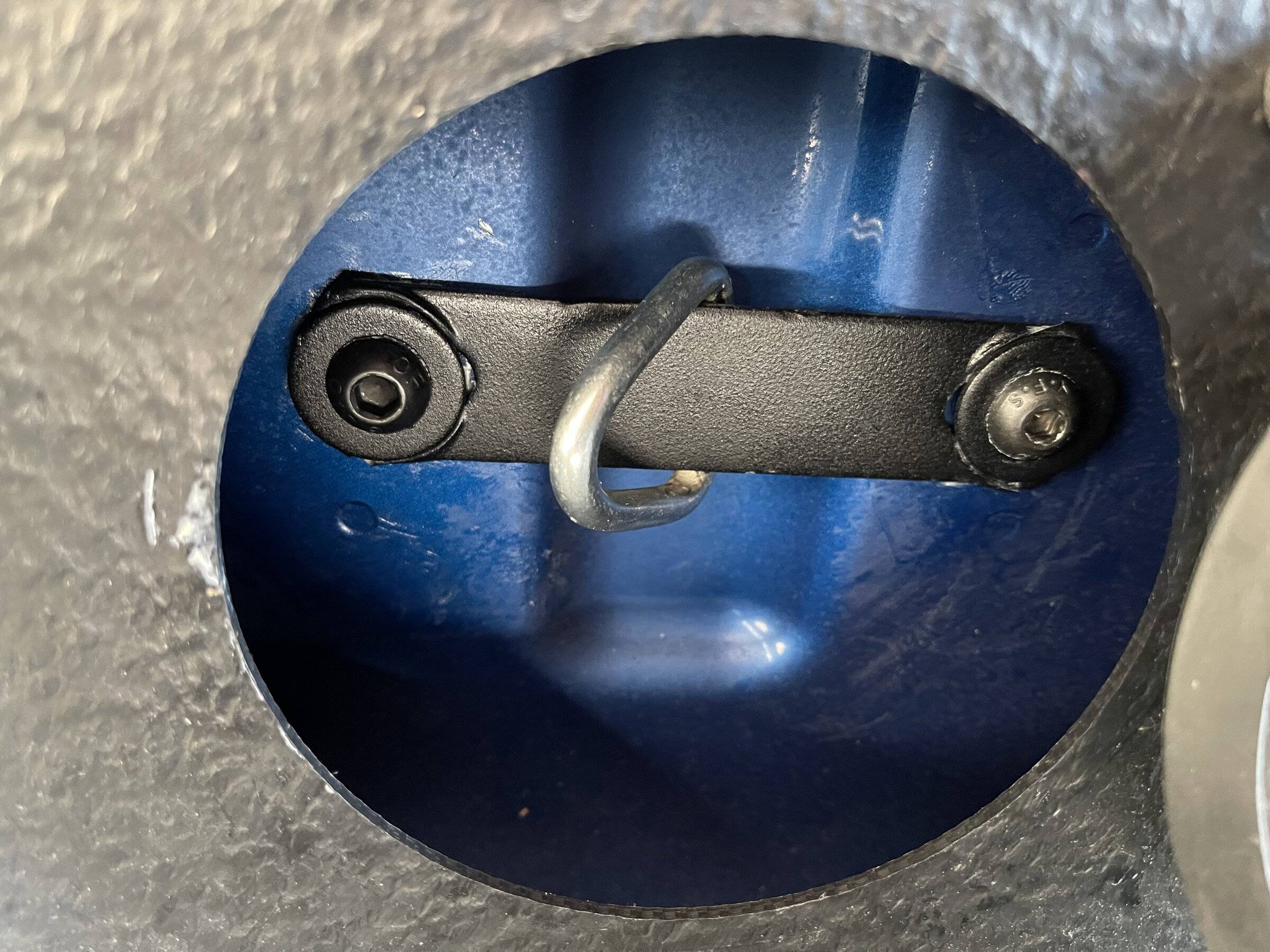

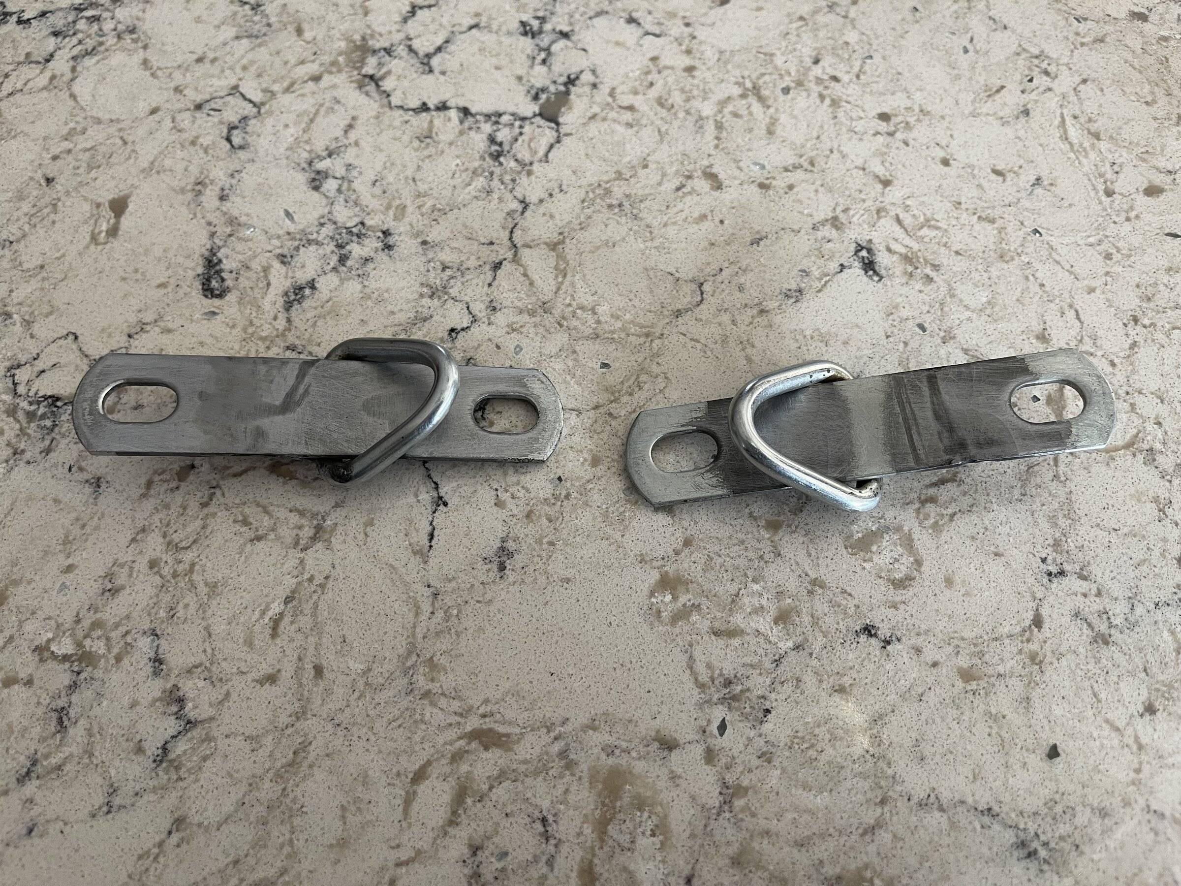

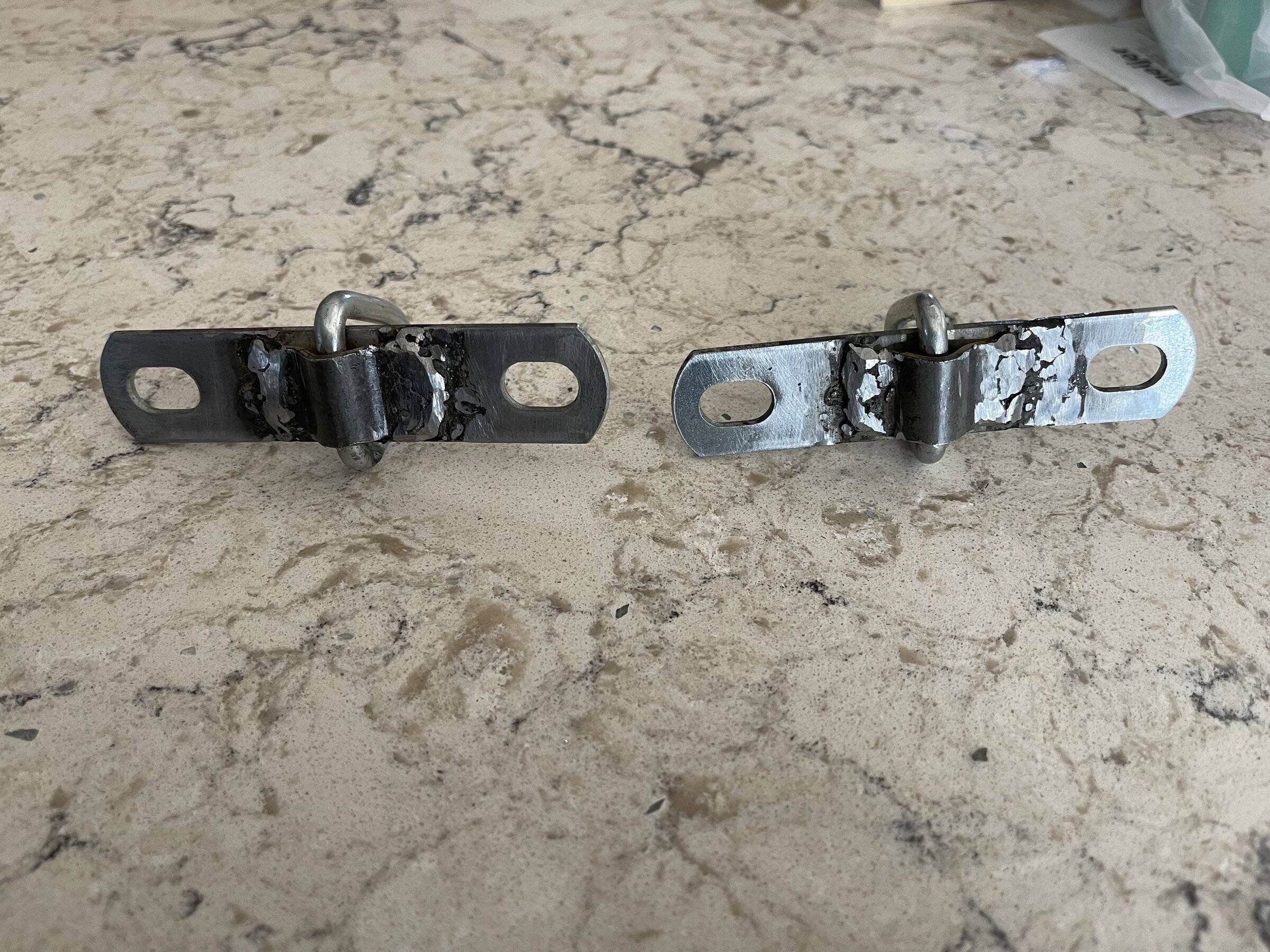

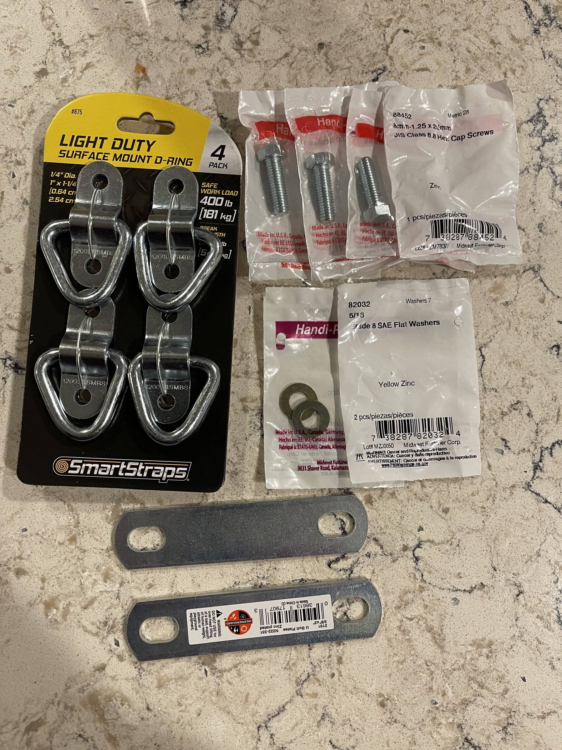

Here are my home made bed tie downs. Less than $6 each. I purchased these parts at Menards. I cut the straps for the d-rings and welded them on. Painted the straps and screwed em in. I did have to file the holes in the straps about a 16th of an inch. Here are photos from the beginning. Very happy with them.

HI Buddy,
Okay....good Job, but confused...you show hex head bolts and last pix is Hex drive round head bolts...WTF???
