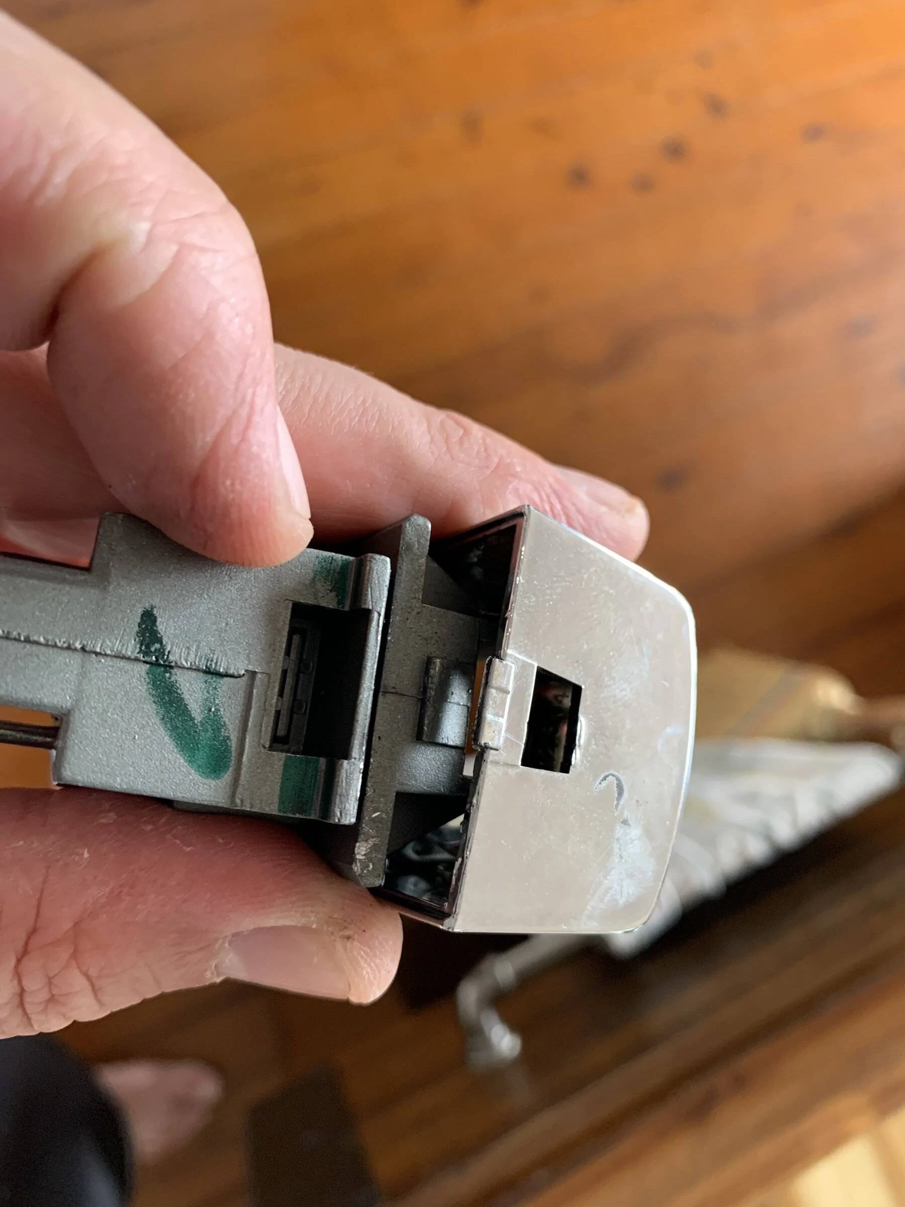

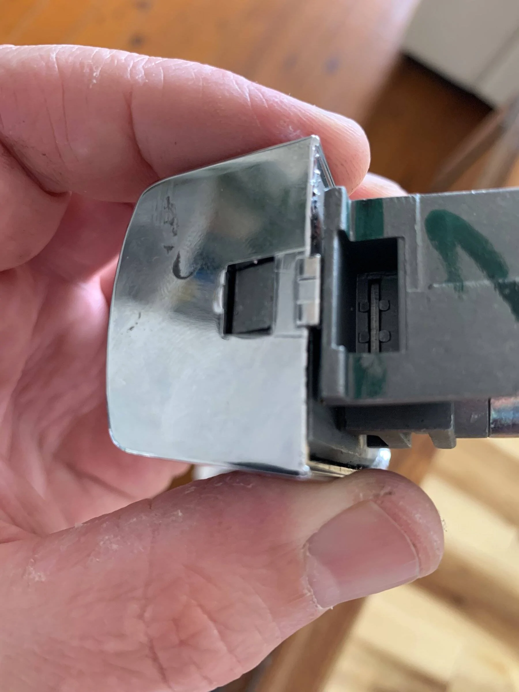

Somewhere on this end?

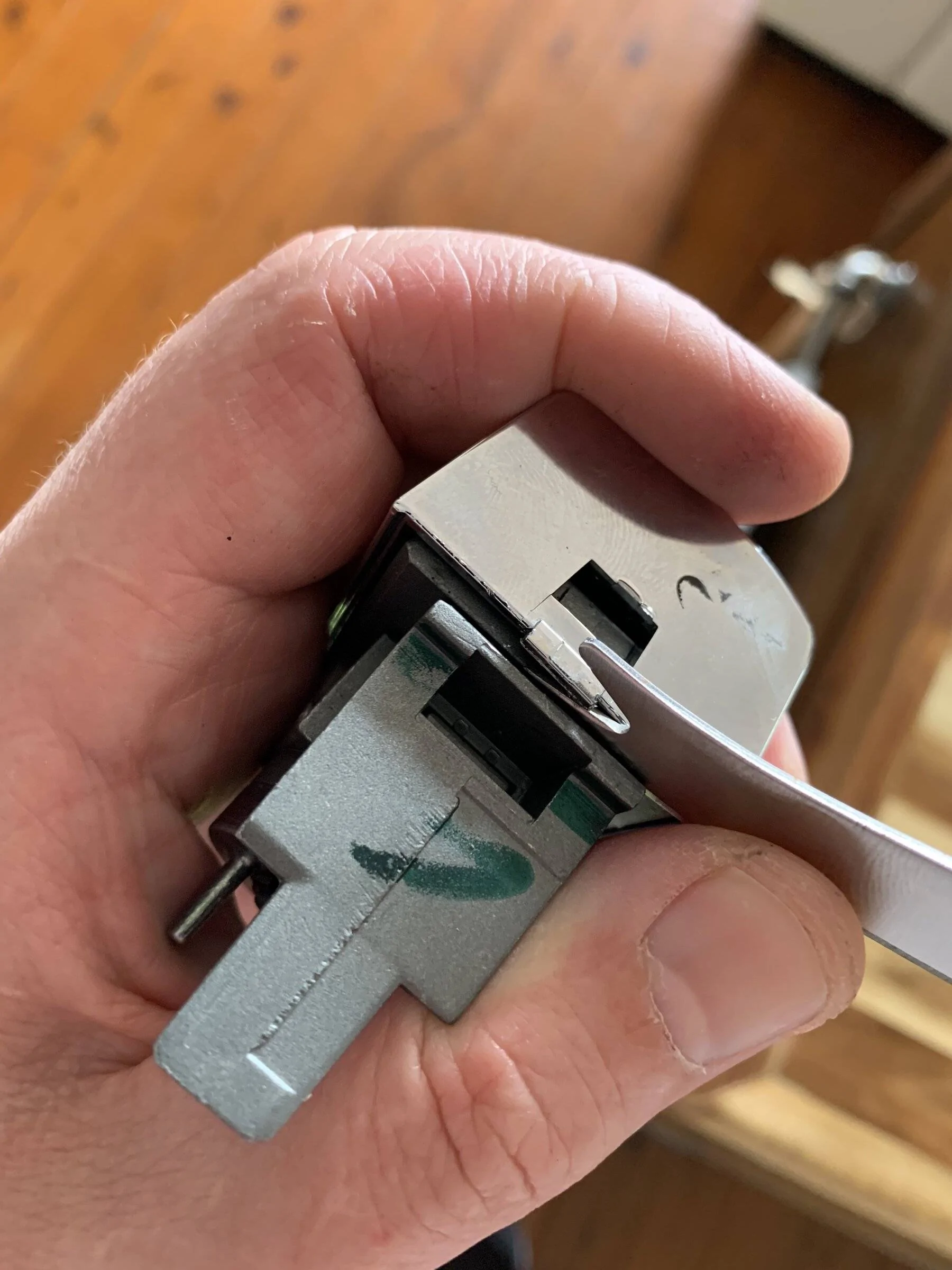

Got it mate. That post was a bit confusing until I played with the lock again after reading.
For anyone who ever search’s this…
Place knife in here…
And carefully lever up…
Thanks again for your help, much appreciated ?
