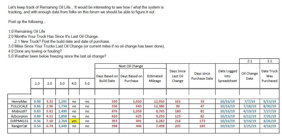

A Preliminary review appears to show that the Remaining Oil Life Monitor is pretty much just a timer.
See how there is very high odometer estimates for newer trucks, and low odometer estimates for older trucks? That's because the amount of time the truck took to get from the factory to your home throws off the calculation. But as time rolls on, that time is less significant.
If it was solely based on how you drive, that wouldn't matter.
But we need more data over a longer period of time. Still interesting (at least I think so).
Let's keep this thread going.
  • As the months roll on post up your data again.
  • At the first oil change post up your data again.

62%
2.5 months
4100 miles
No
No
That was my second oil change. First at 2k, second at 10,500, truck currently has 14,622. Definitely not just a timer, otherwise it would show 79%. Also not just a mileage counter as 4100/10000 would mean I've used 41% of the oil life and would have 59% remaining.
