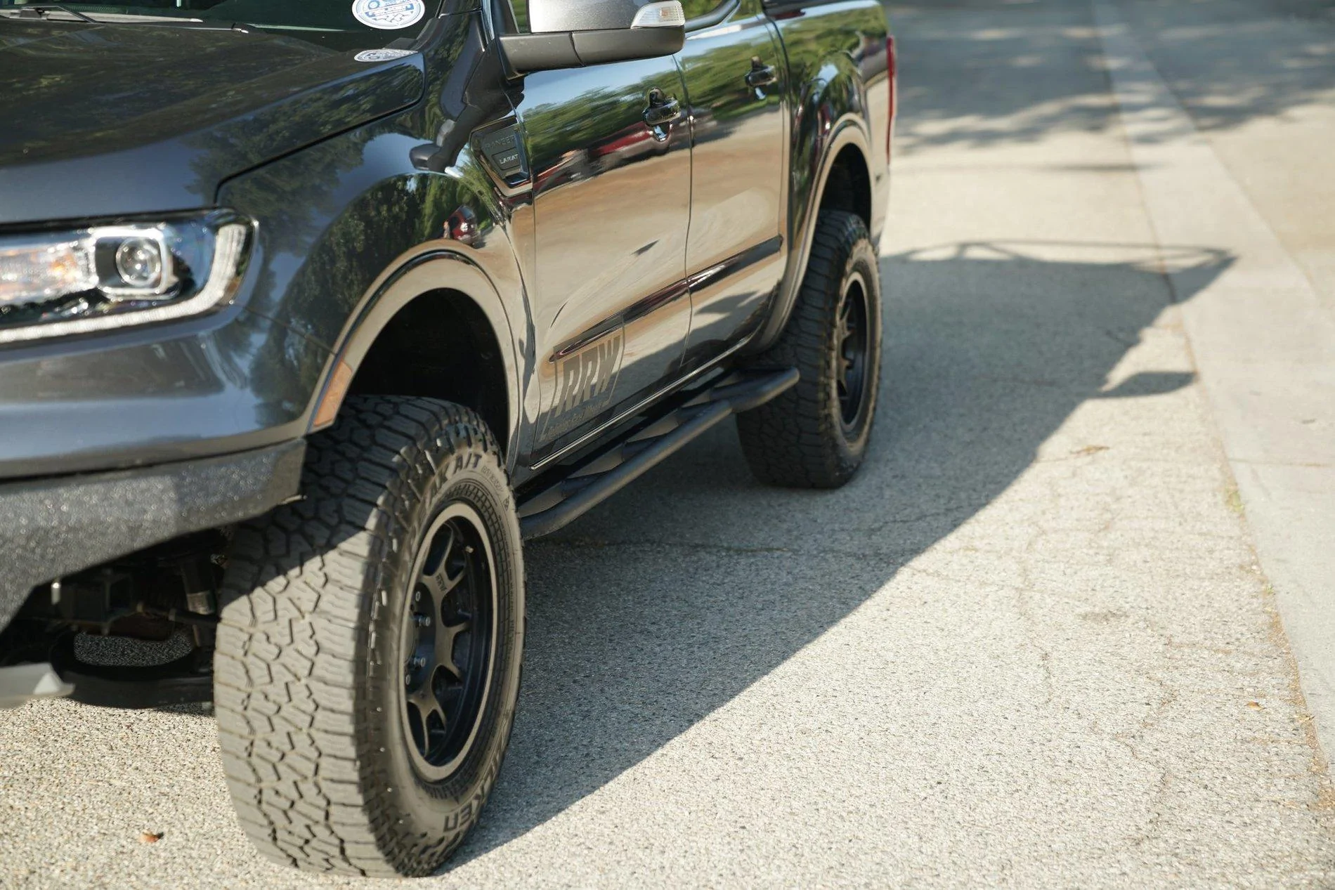

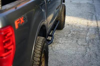

Anyone buy these yet? They look much more aggressive than the current offerings but are more pricey. Wondering on ease of installation and quality of the mounting situation. Also nice you don’t have to drill into the frame.

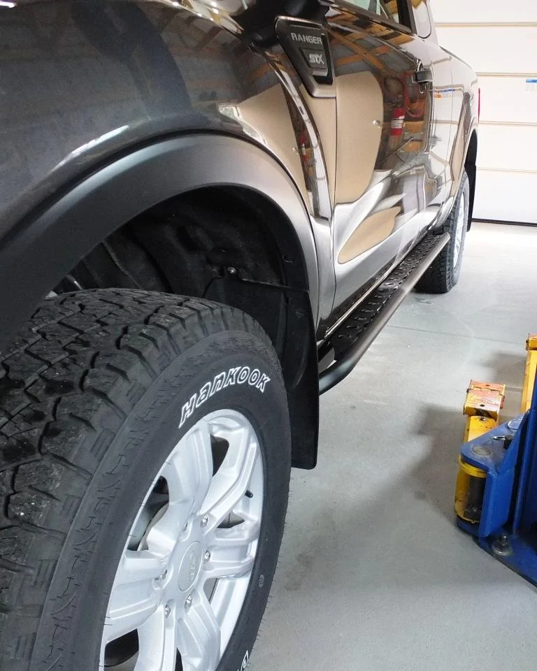

FWIW.... I considered those. However, what I didn't like was unless you have wider than stock tires and wheels these will stick out past the tires. They also don't have a step plate like the Shrockworks Rock Sliders do. Without the step plates the rocker panels on the truck won't have as much protection from road debris.

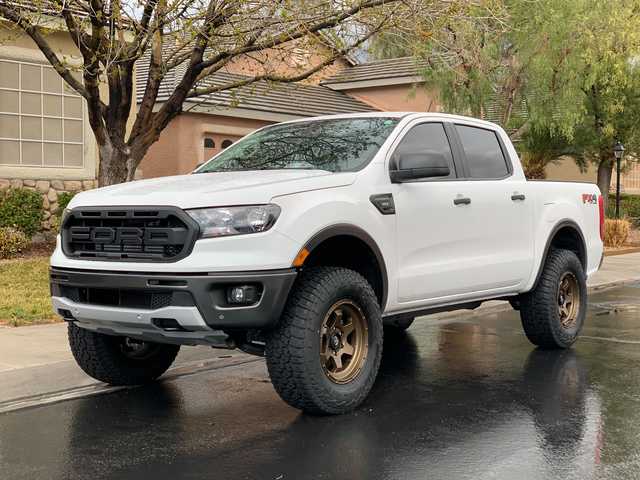

Didn’t think about that. Wonder how it’ll look with my current wheel setup 285/70r17
Are you running stock wheels? If the answer is yes, they will stick out past the tires.

Fuel shoks with +20 offset. Love the poke they have and hoping that if I get these they’ll not stick out past the tires.
Nice! Love the tire / wheel combo.

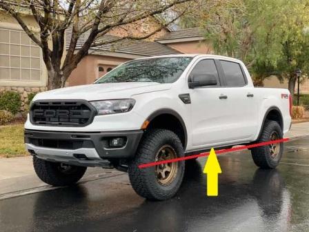

Rather than just roll the dice....
Get a couple people to help you. Take a string and stretch it from the front tires to the back tires.
Then measure from the rocker panel flange that hangs down -to- the string. Then call the manufacturer and ask them how far out these stick out from that flange. If they can't tell you, PM somebody here that has them and ask them how far out these stick out from that flange.

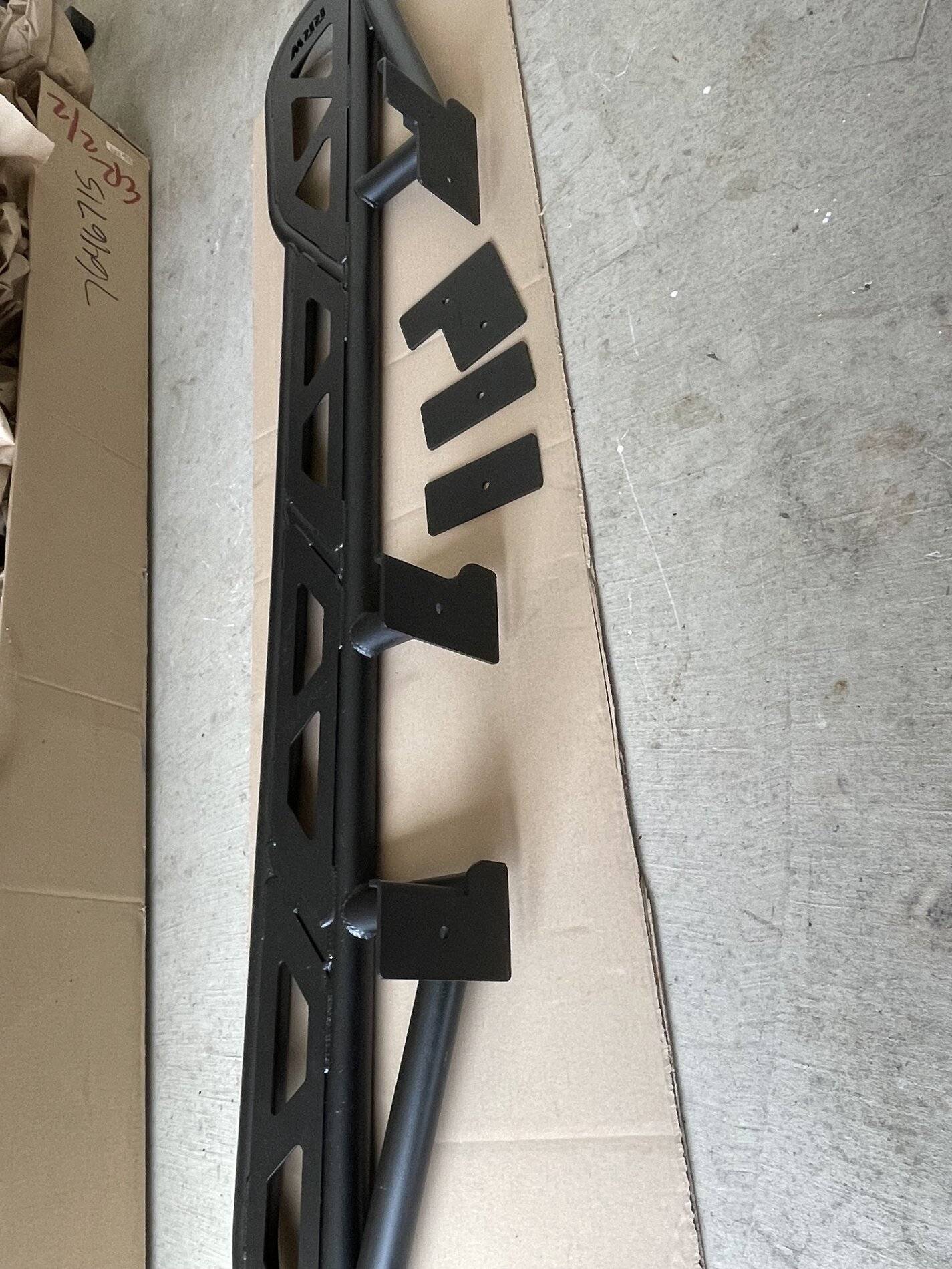

does anyone have the RRW sliders installed. I have a 2021 and only vid I could find was on YT and the guy had a 2019 and the brackets are totally different from mines his is a small oval shape as for mines its a rectangular shape and I cant find any install instructions and no one responds to emails or IG msg. Any help is much appreciated

Mine just arrived, and I haven't opened the box so thanks for the warning.
