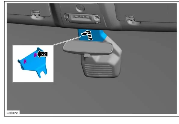

If you don’t mind.how do you get the covers off?
Do you by chance have any pictures that show the clips,and the mounting area for reference?

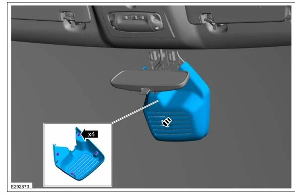

JimH
JimH
Jan 15, 2020
275
424
Palm Coast, FL
2020 Ford Ranger XLT SuperCrew
Covers snap off -- pictures attached
Want to hardwire my threat detector and swap to an autodimming mirror as well.
Thanks in advance!
As Jim said, they just snap off. I came to say that these particular clips are uncomfortably tight and I had to pull way harder than I was happy about. I ended up slicing up my fingertips a little on the sharp edges of the cover.
