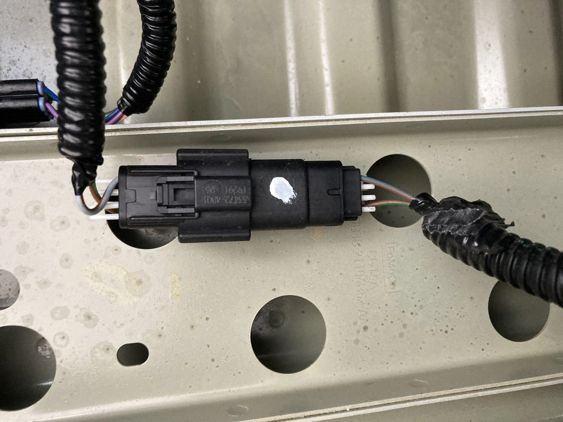

NA harness going into bottom of tailgate.
Right side of this plug runs to tailgate.
Left side harness appears to tie into right taillamp harness.
Thank you for the pics. Tomorrow, I’ll check the harness.

Bad news... as you can see the connector is there.. but the camera wiring is missing (just two wires in place of eight).
So...At this point I cannot use the original wiring and I cannot use the original camera. :(
