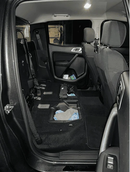

i Removed the rear bench seat. Looking for ranger interior storage modifications. What materials, wood or other have you used? I'm considering a floor panel to level off the bottom, plus a rear facing panel so to have around 7" of space behind where the rear seats were leaning against. Thanks in advance. Ranger Wheelin Pittsburgh Pennsylvania!

Haven't seen this done on a SCrew yet.
Lots of guys have done some things on the SCabs though.
Interested to see what you come up with.

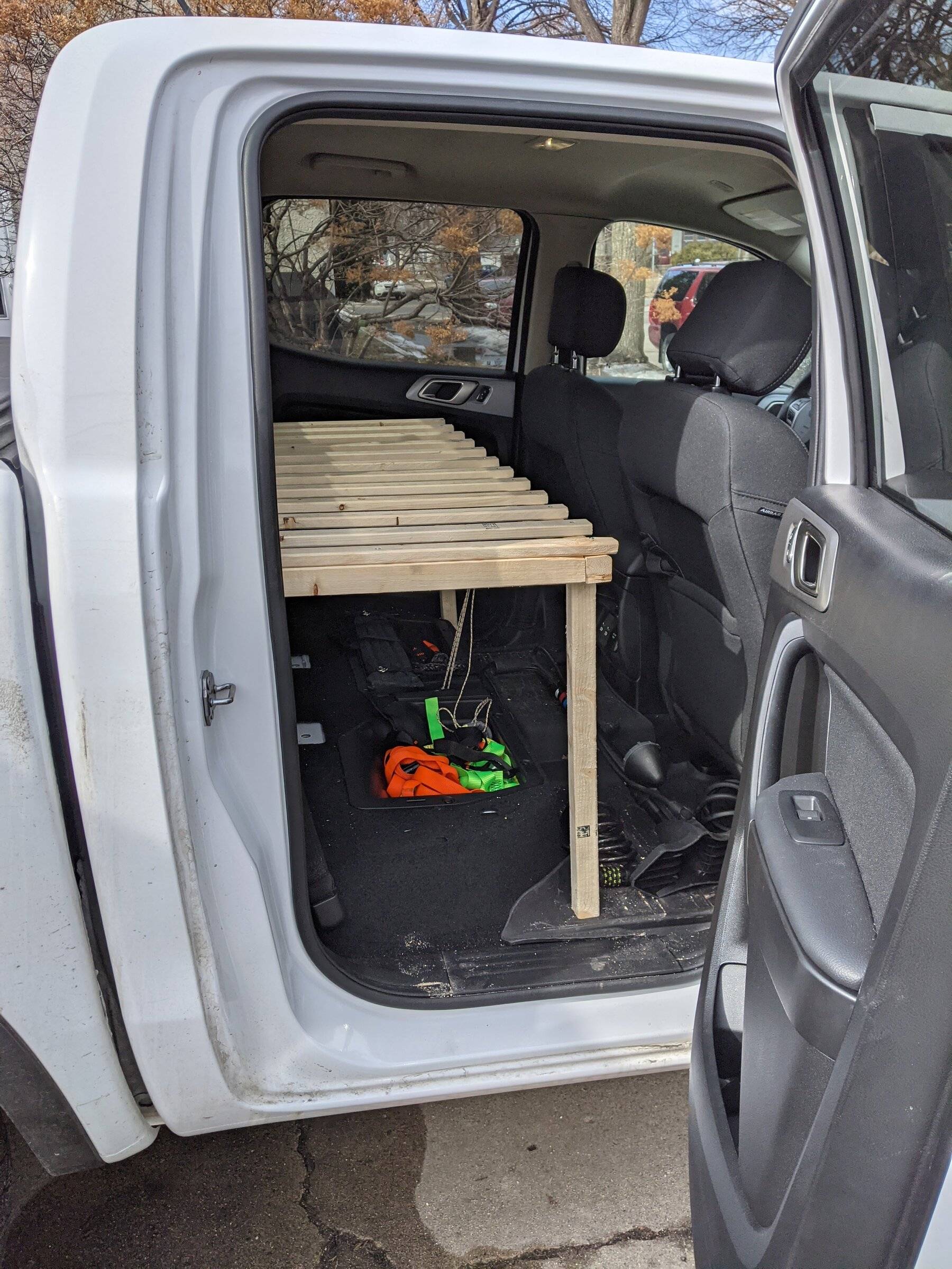

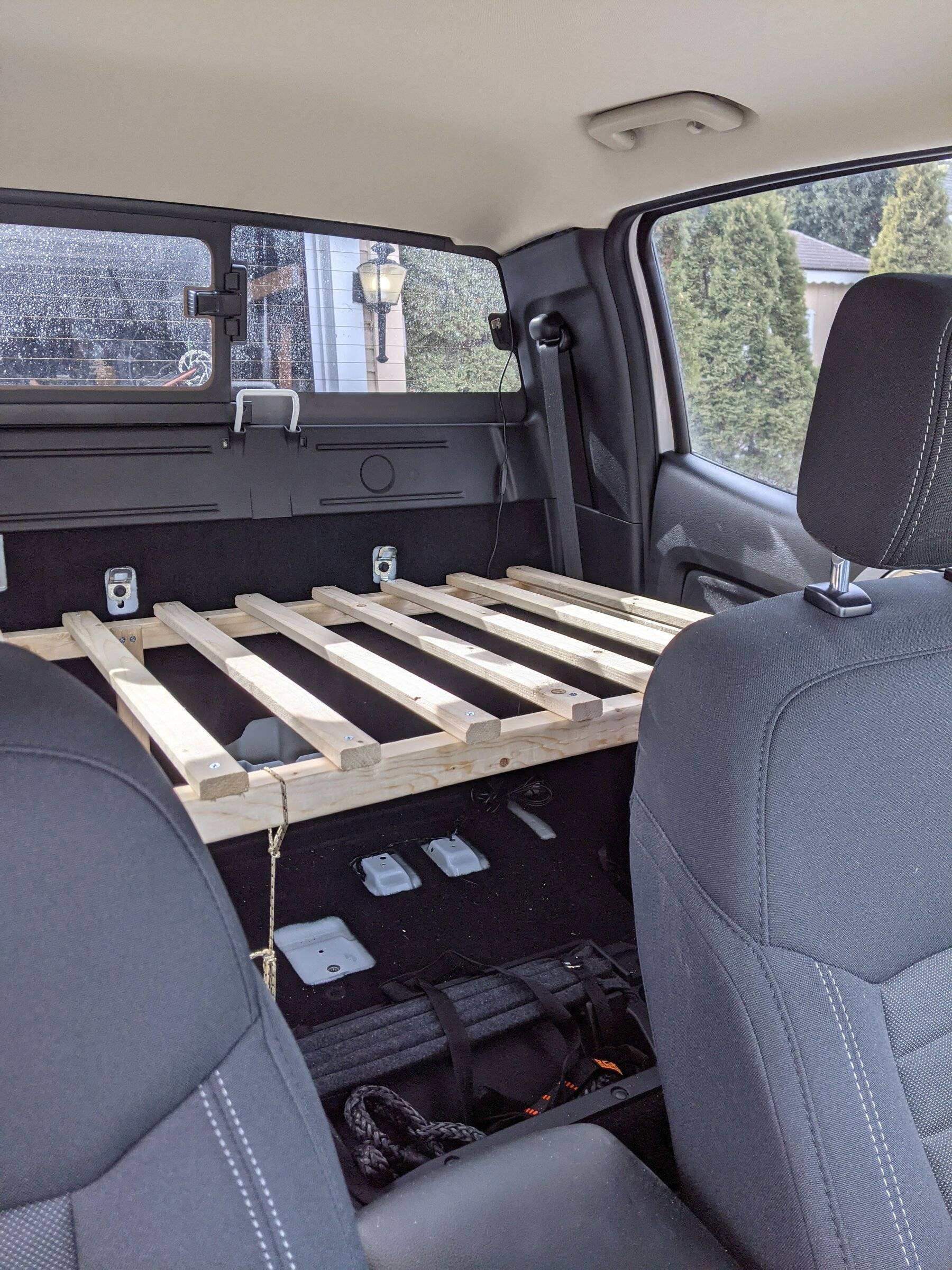

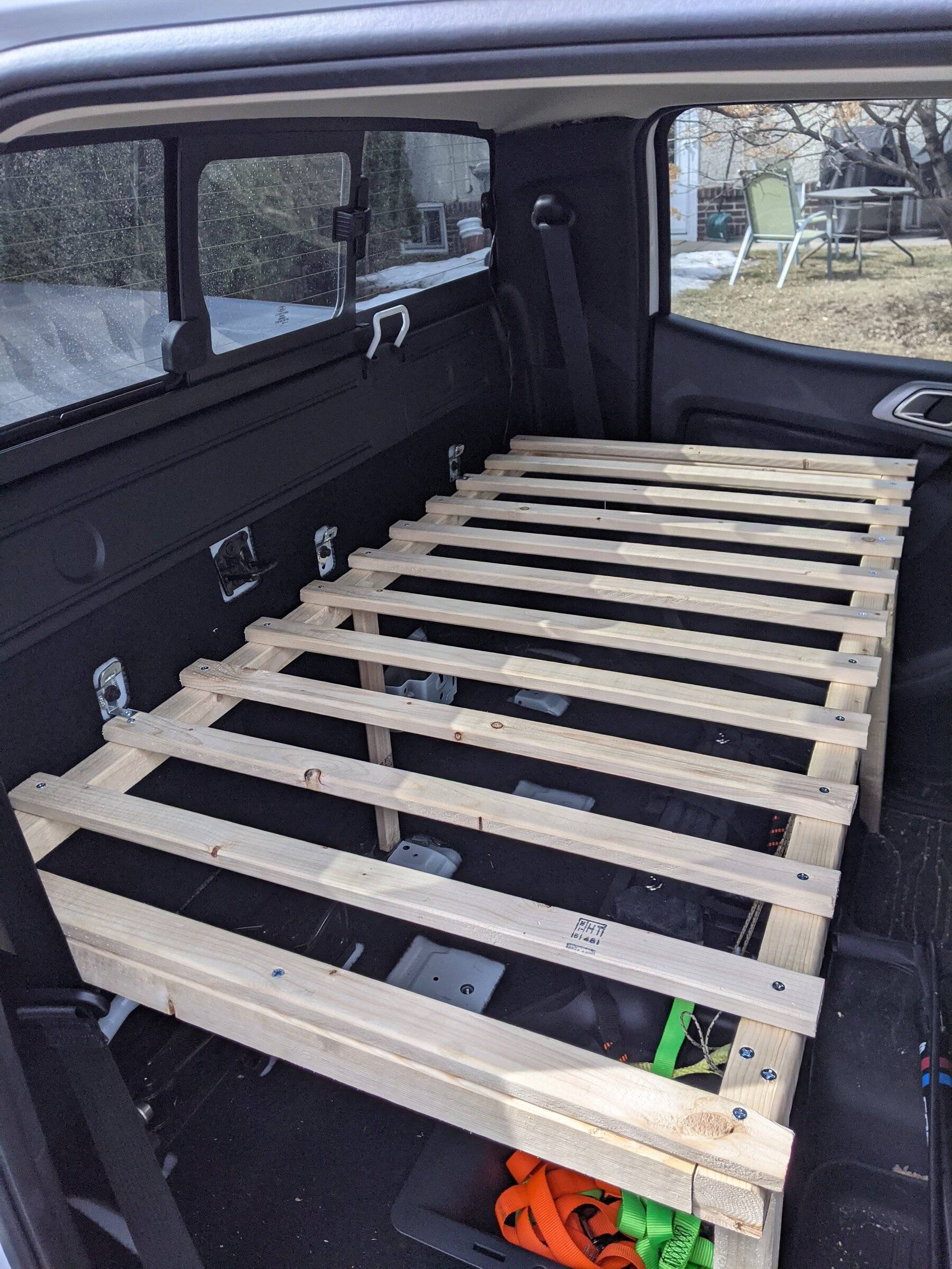

I rigged up a real basic and non-optimized wooden shelf for a Moab trip last year. Bolted into the three small hooked mounts that were behind the rear seat and tensioned down with paracord to the center mount. I ended up cutting thin rubber mats to cover the base of the floor. Held up well and I was able to tetris in my coolers, totes, and whatnot. Came here to see if anyone had a better solution as I would ideally like to keep a single seat in the back still.
