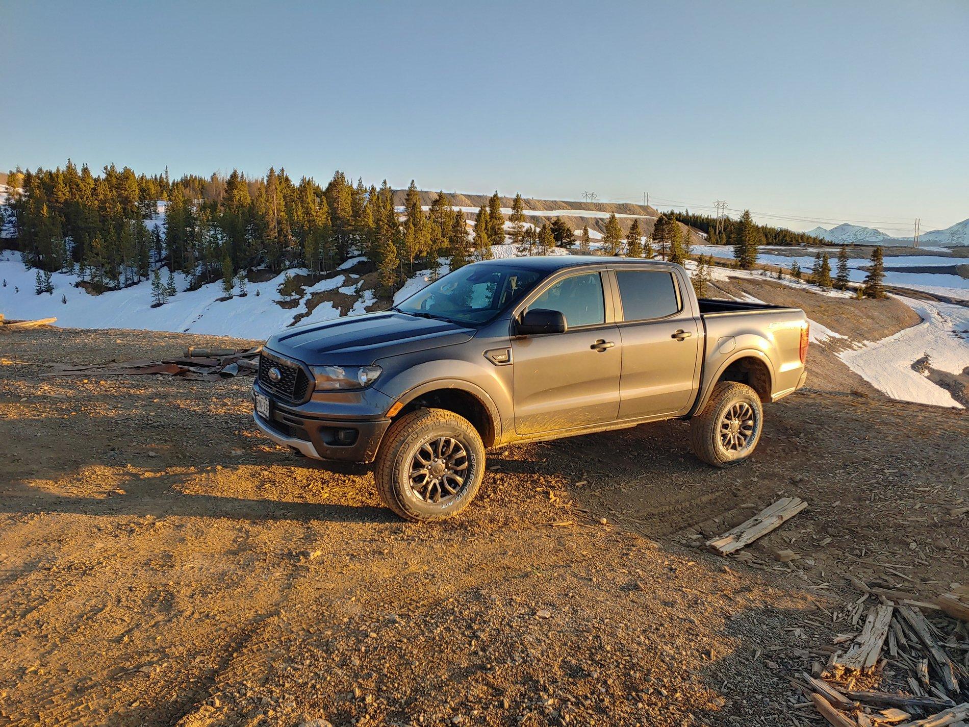

In my opinion if you want overall lift then get rid of what you have and go with Old Man EMU by ARB. I have it and it is wonderful!! You get all shocks front coils and rear leafs!! The front goes up by 2.4ish and the rear by about 1.5!! The ride is nice on the street as it has cleaned up the feel and the offroad experience is awesome!! No i wont hot the Baja with it but im still able to enjoy it!! Here are some pictures.
