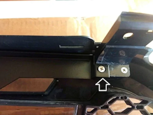

So, here is my beef. They claim the grill is abs plastic... Got to wonder about that. Anyway, they give no instructions which if you are mechanically inclined or just intuitive, you can figure out what to do. My biggest beef are the crap screws and post stands they mount on. They give you these tiny Philip flat head tapered screws with matching washers. The posts and mounts are plastic. Where the screw goes into the post mount is recessed and plastic. If you put the washer on screw first, it will not recess. If you put it on the bottom, which is a pain, it may not sit right. Just the washers, they also do not let the screw go in far enough to grab enough. One way or another, if you tighten down ever so easily, the taper on the screw head will spread the plastic hole and it will ruin the mount.
They give you 2 mounts that are the ones that bolt to the top of the frame. The posts are long and do not look like they will last under vibration. In fact, the one side, the top of the posts sheared off and the mount just came apart. So I had to find my own screws that were just a tad longer to screw it back on. I got a feeling I should be picking up some JB Weld for Plastic today.
Now today, I start over. Screws I thought holding the letters on were tight enough, are not. You got to hope, every time you take the top shroud off, it doesn't stress the grill tabs and posts. I have to remove the shroud again, check all the mount points and then install the lights, which incidentally, get mounted to one of those screws holding on the top grill tabs.
If you have done this enough like the guy on Stage 3, yes it may become easier. But who the hell wants to mess with it more than once. Ugh. BTW, the pic below the screw here shows where the light bracket gets mounted. You guessed it. Has to mount with those crappy screws and plastic mount. I told the guy who made the lights that these plastic grills, that the mounts are pathetic. Hope it holds on without causing more vibration eventually destroying those plastic posts.
What say you? I'll be calling Stage 3 today to report my issue. If need be, maybe they'll replace the grill. Seems everything that breaks on these grills happen to be permanently attached to the structure. The light is well made. Don't suspect problems with it.

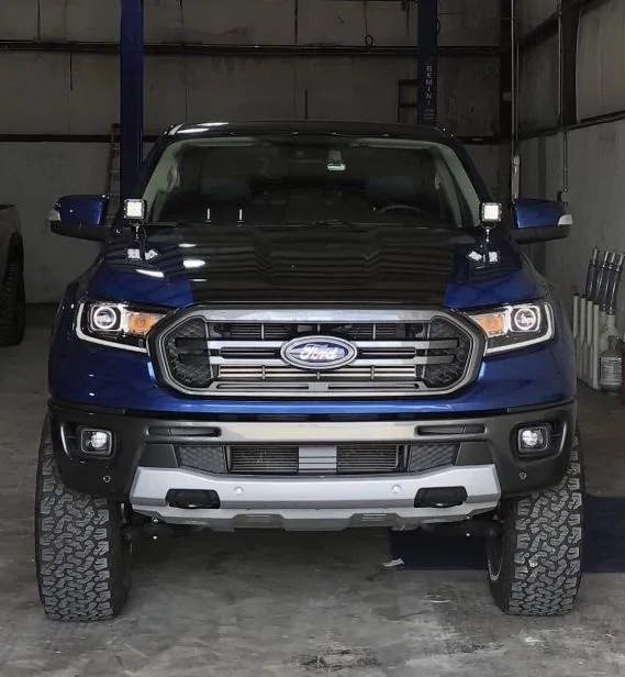

digging the two tone hood!! did the same to my F250... Vinyl?
