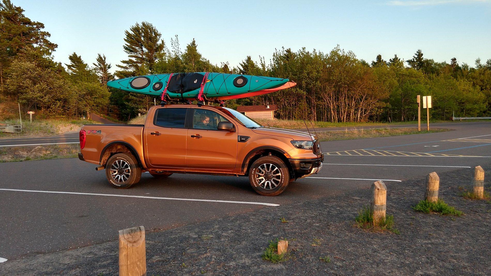

This is the setup we had for our pair of 14' kayaks (before we got the topper). Yakima cross bars on top of the cab. Easy to use. Easy to take on and off. Cheaper than the bed racks. Plenty solid.

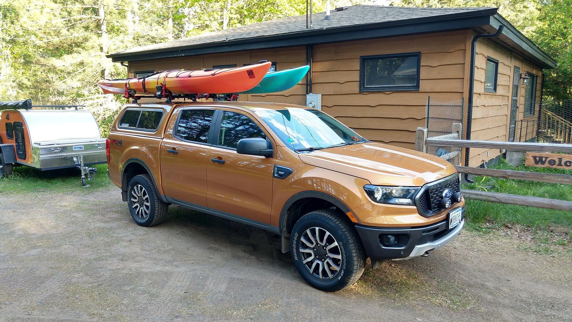

This is the setup we have now. Not necessarily what you're looking for, but a great setup for us now.

Any issues with not running a bow tie down? I use a Yakima rack over the bed to haul my 14 footer and am always concerned about the bow not having a good tie point

We used bow tie downs when we had them above the cab. Ran them down to the front tow hooks. Definitely felt we needed them in that situation. On the topper they're so solid I don't feel we need them. I can grab a kayak and rock the whole truck with it. Applying more force than any wind ever would. And with them lying flat, they're less of a sail and more aerodynamic, which helps a lot.

@Dangerpete - I recommend always using bow/stern lines. Every single horror story about kayaks coming loose on the highway starts the same exact way as yours. Also keep in mind that it's not just wind force, its what happens if you end up in an accident. Bow/Stern lines are the only fore/aft secure they have.
